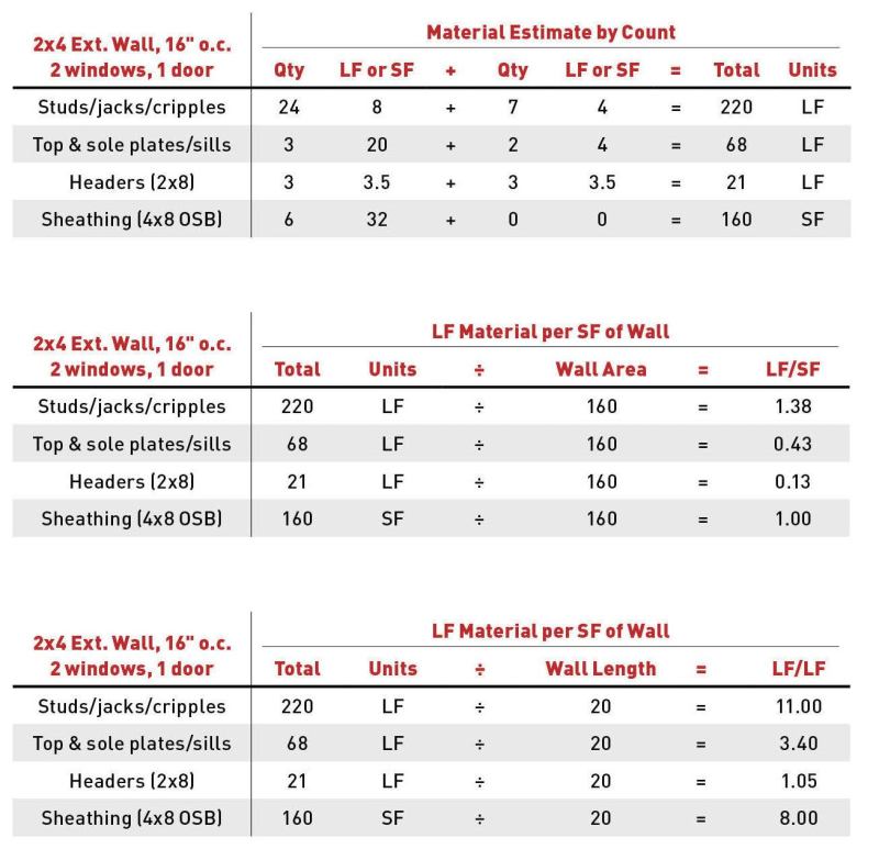

Material Estimate by Count:
To build the unit price, count quantities for each wall element—studs, plates, headers, and sheathing. In this example (top), doors and window rough openings are assumed to be 3 feet, and sheathing is assumed to be applied horizontally in staggered courses. Waste from jack studs provides blocking, but cripples are counted at a rough length of 4 feet each. Some contractors add a waste factor to allow for damaged material, or to provide lumber for bracing; others add a separate line item for these.
Unit Price per Square or Linear Foot:
The middle table converts quantities from the material takeoff to a quantity per square foot of wall area. This value, combined with a dollar cost, will yield the unit price per square foot. The bottom table converts quantities to linear feet. Combined with a dollar cost, this value will yield the unit price per linear foot of wall.

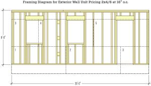

Let’s look at how you might go about calculating a unit price to frame a typical exterior wall. I find that working from a sketch of the wall, such as the one below, makes it easier to visualize all the parts and pieces that need to be included. As with the custom item worksheet, the unit price worksheet uses a unit of measure that fits the kinds of materials and dimensions for the task at hand. In this example, I have chosen to build a unit price based on the materials needed to frame an exterior wall that is 20 feet long and 8 feet high. (We’ll look at adding labor to this unit price next time.)
Waste is something to consider when making this initial takeoff. For example, I’ve listed 24 8-foot studs for this wall, which is the actual count. But you may discover over time, as I did, that jobs keep coming up short by a few 2-bys. My solution today is to add one additional stud. Similarly, the actual count for OSB sheathing is a little over 5 1/2 sheets (remember, the OSB has to cover the rim joist, so a narrow strip is needed to fill out the top of the wall), but I’ve rounded this up to 6. There are other strategies: Some contractors add a waste factor to allow for damaged material or to provide lumber for bracing; others simply round up (as I did for sheathing) or add a separate line item. However you treat this issue, in the end it’s cheaper to have figured a little extra than to have to make a run to the lumberyard for more material.
Because the base wall has a total area of 160 square feet (8×20), all of the costs listed in the worksheet will have to be divided by 160 to yield the price-per-square-foot (see table, next page). I’ve also included calculations for a price-per-linear-foot, which some contractors prefer. The difference is that a linear-foot price applies to a wall of a particular height, while a square-foot price can be used on shorter or taller walls, provided they are constructed in more or less the same way. A square-foot price could also be applied to a gable wall, although labor might vary with wall height and roof pitch, as well as whether the walls are framed “on the ground” or in place.
