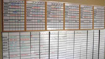

Instead of using the standard-size dry-erase boards from office-supply stores, we make our boards from 4×8 sheets of Masonite — the kind that comes prefinished with a smooth white surface. The sheets cost about $15 each. We cut them to size, hang them on the wall, and run strips of tape across them to create the same kind of grid you would find on an Excel spreadsheet. The tape allows us to erase the contents of the “cells” without erasing the grid.
We use four categories of boards: job boards, lead boards, a long-term­ outlook board, and a board for future projects. Some are attached to a particular spot on the wall, but most are held in place by Z-shaped aluminum channels, which makes it easy to remove and rearrange the boards.
Job Boards
The job board consists of one job information “sheet” and 10 weekly calendar “sheets.” The job information sheet is 48 inches tall and about 16 inches wide. The calendar sheets are 48 inches tall and about 8 inches wide. All together, they take up a 4-by-8-foot space on the wall.
The boards are divided into columns and rows. Each row contains the schedule for a single job. We do a lot of jobs at one time, so to be on the safe side we made 20 rows. The job information sheet has columns for the name of the lead carpenter, the job number, and the name of the homeowner. The calendar sheets represent weeks and are divided into five columns, one for each workday.
Tasks are scheduled a week at a time across the calendar sheets (see Figure 1). Every week, one of the boards becomes out-of-date because it represents the previous week. If the schedule were written on a single giant grid, the only way to update it would be to erase and rewrite 10 weeks’ worth of information. But because we cut the board into pieces, we can pull last week’s board from the channels and slide the other boards to the left. The old board is then erased and inserted on the right, where it becomes week No. 10. This allows us to schedule active jobs 10 weeks out.
Figure 1. The framed boards on top show where each carpenter will be for the next six weeks. The boards on the bottom show what will be happening on each job for the next 10 weeks.
Lead Boards
Just above the job boards there are six moveable lead boards, each representing a single week. Each board is divided into six columns. The first column lists all of our carpenters; the other five are for the days of the week. We use the lead boards to list which job individual crew members will be on each day for the next six weeks. Our crews work a four-day week, so Friday is usually blank.
As with the calendar sheets, one of the lead boards becomes out-of-date each week, so we pull the board that’s obsolete, slide the remaining boards to the left, and insert the old board on the right, where it becomes week No. 6.

Once a week the production manager updates the job and lead boards based on changes that occurred the previous week. At the same time, the sales department puts together a list of jobs that have a high probability of selling in the next few weeks. Then, the production managers and sales department sit down with the owners to have a “felt-board” meeting. We use this meeting to confirm the current schedule and look at upcoming projects.
This process makes it easier to finish jobs on time because it prevents us from agreeing to start projects before crew members will actually be available to work on them. We can tell at a glance whether a slowdown is coming or whether there’s so much work that we need to get some extra help. It also makes it easier to identify gaps in the schedule where we can fit in small jobs.
