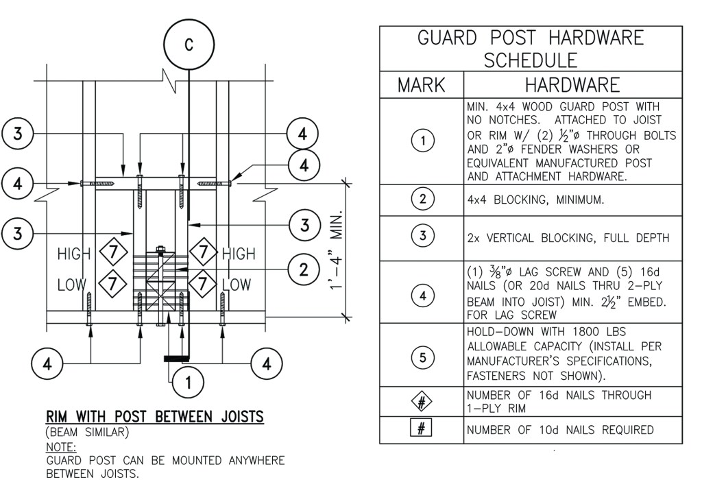

Among the proposed changes to the 2018 IRC are five new prescriptive connection details for guard posts; shown here (in draft form) is an attachment method for guard posts that are located between joists and inside the rim.

Section R507.8 Guards. Guards were the biggest challenge. The topic is fraught with complex issues: aesthetics, system effects, construction challenges, historical lack of understanding, discussion of where the “200-lb. load in any direction” reference comes from and how that relates to acceptance criteria that do not meet the intention of ASCE-7, and so on. Still, the DCC thought it was wiser to attempt to create easily understood prescriptive specifications and details that meet accepted industry standards rather than leave builders and homeowners to rely on untested practices shown in YouTube videos.
RB211 provides five options (verified by engineering calculations) for attaching guards to the deck: two details showing how to mount guards outside the rim joist; two details showing how to mount guards inside the rim joist; and one detail for top-mounted guards. The committee action was for disapproval, but with a request to redesign the details not to simply meet the acceptance criteria, but to satisfy the load requirements in ASCE-7. The DCC has since revised the details and resubmitted them as a public comment.
