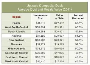

Three decks and a sunroom. Among the projects in the study are three decks, at different price points, and a sunroom. Two of the decks measure 16 feet by 20 feet and feature a railing, planter, and bench that match the decking; the less expensive of the two is decked with pressure-treated wood, and the other has composite decking and matching railing. The third deck is an upscale version of the composite deck, with a number of added features: a second, 10-foot-by-10-foot level; decorative balusters, post caps, and lighting; wrapped posts; and trimmed-out perimeter joists. All three decks have a stair with three steps to grade.

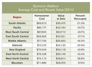

The sunroom, the priciest of these four structures, is 200 square feet with exposed post-and-beam framing and vinyl- or aluminum-clad windows with low-E, laminated, or tempered glazing and screens. It has 10 venting skylights, a ceiling fan, moveable shades, and a quarry tile floor.
Cost and value. Last year was tough on remodeling values — the average resale value of a remodeling project dropped 6 percent nationally from the year before. The declines in the values of two of the decks and the sunroom are close to that average: The value of the midrange composite deck is down 5.4 percent; the upscale deck, down 6.8 percent; and the sunroom, down 6.6 percent. The value of the pressure-treated deck dropped the most — 9.1 percent — of the four, but its cost dropped the most, too.
Overall, homeowners’ remodeling costs came down slightly (1.9 percent) in 2011, but not enough to significantly offset the decrease in values. That was also true for the midrange composite deck (down just 0.3 percent), the upscale deck (down 1.4 percent), and the sunroom (down 1.2 percent). The cost of the pressure-treated deck dropped by 5.7 percent.
That values decreased more than costs means the cost-value ratio, or return on investment, also decreased from the year before. The average cost-value ratio for remodeling in the latest report is 57.7 percent, 2.3 points lower than it was the year before, and a full 29 points lower than its peak in 2005. (That’s not a perfect comparison, however, as the current mix of projects is different from that in the 2005 edition.)
Likewise, the cost-value ratio is down 2.7 points for the pressure-treated deck, 3.4 points for the midrange composite deck, 3.1 points for the upscale composite deck, and 2.7 points for the sunroom.
Of all the projects in the study, fiber-cement siding replacement has the best return on investment, at 78 percent. The wood deck has the seventh highest return (70.1 percent), whereas the sunroom has the second lowest (45.9 percent), besting only a home office (42.9 percent).
