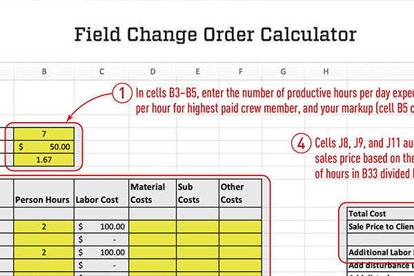

Field change order calculator. To help manage the costs of a change order, I use a spreadsheet tool I developed in Excel; you can download it by scanning the QR code (below) with a smartphone camera app. It’s easy to use: You simply fill in the pertinent time and cost information about the change in the yellow highlighted cells. The app autocalculates in the clear cells, then arrives at a change-order sale price to present to the client (see Field Change Order Calculator, below).
Click to enlarge
To help accurately price change orders, the author created an Excel spreadsheet tool that can be downloaded by scanning the QR code, below. The Field Change Order Calculator reflects the window example noted above, in which the clients requested the window to be larger and in a new location. Labor, materials, and tools related to the demo and reframing of the wall must be accounted for, as well as the costs for the new window and moving the furnace vent location. Other costs include exterior trim, dump fees, time for a lumberyard run, and administration time to estimate the change order.
Following through with the window example mentioned above, in cells at the top left of the spreadsheet, you’d fill in the number of productive hours per day expected by crew member (in this case, seven hours), your burdened rate per hour for highest paid crew member ($50), and your markup (1.67%).
Below these items, under the term “phases,” I list all the cost categories and project tasks that I would have in an estimate. The idea is to prompt the employee completing the form to think about all the possible implications of the change when reviewing the list. Is there any excavation? No. Any demo? Yes. Any concrete? No—etc.
For administration time, I entered two person hours, which automatically calculates two times the $50 labor rate to $100. I input two hours for the demo work ($100), three hours to reframe the wall ($150), $1,000 for the new, larger window plus one hour to install it ($50), and $50 for the exterior trim. To move the furnace vent 3 feet from the relocated window, I entered $200 for the HVAC sub, $50 for trash dump fees, and two hours for a lumberyard run ($100). The cells in the last row of the phases section autocalculate the hours and dollar amounts of the filled-in cost categories and project tasks.
The total cost ($1,700), sales price to client based on the markup ($2,839), and the additional labor days (the total person hours divided by the productive hours per day; in this case, 1.4 days) are autocalculated at the top right of the spreadsheet.

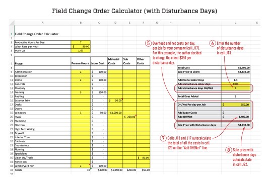

Disturbance days. A disturbance day is simply any day added to the overall schedule that’s not accounted for in overhead and net for additional labor as a result of a change order. Typically, if you have two days of labor, you charge for overhead and net for those two days associated with the labor. But if the scope of the change order pushes the job out, say, two days overall, who’s paying for those extra days in terms of overhead and net? If you’re being held up from finishing the job, how you can you start another? It’s called lost-opportunity cost, and you’re losing money on this unless it’s accounted for in the change order. (See the Field Change Order Calculator with Disturbance Days, below.)
Click to enlarge
Following through with the window example, the user can account for any disturbance days on the change order, if applicable. Disturbance days are delays to the project on the overall schedule that are not accounted for in overhead and net for additional labor as a result of a change order. On the right-hand side of the spreadsheet, four disturbance days were added because the change required rescheduling the HVAC sub to move the furnace vent location. The change pushed the job out another four days on the overall schedule, which increased the change order sale price.
For this example, I’ve decided to charge the client $350 per disturbance day, which I input in the “overhead and net costs per day, per job” line below the total cost, sales price, and additional labor days. This amount may be on the low side (a company I advise charges $1,275 a day, per job), so you’ll need to do the math to figure out what that cost is for your company. You must get compensated for those additional days because a client-generated change can impact your ability to start on future work.
Four disturbance days were added because the change required rescheduling the HVAC sub to move the furnace vent location. The change pushed the job out another four days on the overall schedule, which increased the change-order sale price of $2,839 by the “Add OH/Net” amount of $1,400, to $4,239.
