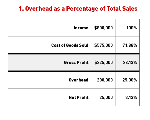

Mistake #1: Confusing Markup and Margin
A common mistake is to look at total overhead for a given period (say 12 months) and express it as a percentage of total sales for that period. For example, here’s a company with $800,000 in sales, less production and overhead costs. Dividing each amount by the total sales figure gives us the results shown in the right-hand column.
Starting with the 100% figure for sales, this company is losing 71.88% (or $.7188 on a dollar) to produce the work, and another 25% (or $.25 on a dollar) for overhead, leaving 3.13% (or $.0313 on a dollar) profit. Many contractors look at that and say, “OK, I need to take my costs and add 25% for overhead.” If they’re happy with the amount of profit they made in the past, they would probably try to perpetuate the strategy by adding another 3.13% for profit.
Let’s imagine, then, that the contractor by sheer coincidence happens to sell a single big job and he estimates the costs will be exactly $575,000. Let’s see what happens when he adds the 25% + 3.13% to the estimated costs. He should end up with a sale price of $800,000. What happened?
Remember that in the original Profit and Loss, all the line numbers (Cost of Goods Sold, Gross Profit, Overhead, Net Profit) were compared with total sales. Later, when our contractor was trying to price a new job, he added 25% and 3.13% based on the estimated costs of the job. Our contractor confused markup with margin. The terms are easily confused (they even sound similar), but markup always compares against costs, while margin is compared against selling price.

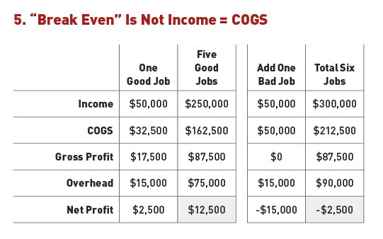

Mistake #3: Misunderstanding ‘Break Even’
I haven’t yet met a contractor who didn’t admit to selling a job at a price that he knew was too low. There’s always a rationalization: “I had to take it to keep the guys working” or “the job was right on Main Street; it was like free advertising” or “I made a ton of money on the last job and this one had some interesting challenges.”
The misunderstanding occurs when contractors assume that “break even” refers to charging enough for the job to cover the actual costs of the job. The logic error here is to forget that the sale price must cover not just the job costs, but also overhead, with enough left over to contribute to profit.
Let’s look at five identical “good” jobs, where “good” means that there was adequate gross profit to cover that job’s share of company overhead and contribute to total profit.
What happens when a job “breaks even”? If you think that “break even” means that costs equal sale price, you do not break even, you’re actually in the hole by $2,500. That’s because overhead costs keep coming in regardless of how you’ve priced your job.
True “break even” refers to a price that covers both the production costs and that job’s fair share of company overhead. There is nothing left to contribute to profit, but at least overhead is covered.
