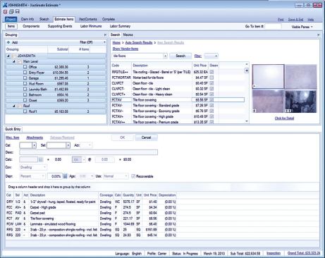

Preparing the estimate. Typically, you'll need to prepare your estimates in a format that's approved by your client's insurance company. This gives the company more control over costs and makes it easier for the adjuster to compare estimates.
Insurance companies don't like per-hour or per-day rates, because they're simply too vague. Instead, restoration estimating is done by unit costs — so much per square foot, per linear foot, and so on. Lots of books and software programs are available for unit-cost estimating, but the most widely accepted program in the insurance industry is Xactimate (see "Xactimate Estimating Software" sidebar).
After you've submitted the completed estimate to both the adjuster and the property owner, the adjuster reviews it to make sure it's in line with the previously agreed scope and to verify that your pricing is in line with industry standards. Adjusters will also compare estimates against those of other contractors bidding the same loss, and possibly against estimates they've written themselves for comparison. Once the adjuster has an accurate value for the loss, work can begin.

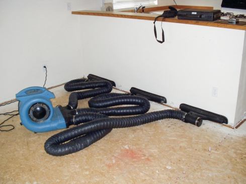

Restorative Drying
Emergency calls are common, and typically chaotic — such as the time we arrived at the house of a woman who had put some clothes in a sink, got distracted by her kids, and left for work with the sink stopped up and the faucet still running. In fact, the calls my company received most often were for structural drying after a building became wet. This process is known as "restorative drying" in the industry, because insurance companies increasingly expect to see building materials salvaged, not just torn out.
Proper drying requires the right equipment, plus specialized training such as the IICRC's three-day Water Damage Restoration Technician course (see "Training and Certification," page 58). The class covers the basics of how water affects a structure and what equipment and techniques are needed for drying various materials.

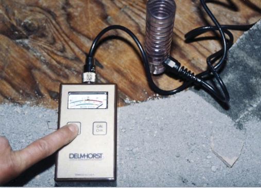

Equipment. A typical emergency water job begins with testing to find the extent of the water's movement. Our testing equipment included a thermo-hygrometer to measure temperature and humidity levels ($100 to $500) and various types of moisture meters to determine how wet different materials are ($450 to $600).

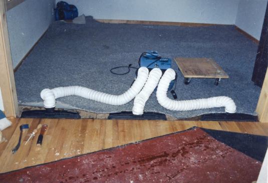

We also owned a number of air movers ($150 to $550), which are used to evaporate the moisture and get it airborne. A small wet job will require three or four air movers, while larger jobs can require 10 or more for the initial drying. Large restoration companies will often own 25 to 30 air movers or more.
Dehumidifiers ($1,300 to $3,600) are used to remove the moisture from the building. A minimum of one dehumidifier is required per job, more on larger jobs. A contractor getting started in insurance restoration should expect an initial investment of at least $10,000 in equipment and training, in addition to any franchise fees.

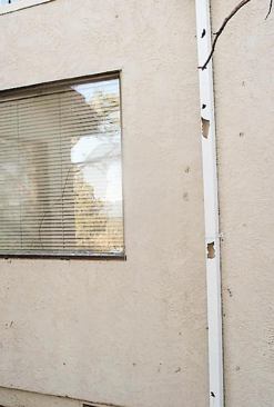

Water and Storm Damage

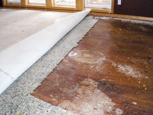

Water damage — from frozen pipes, broken appliance lines, overflowing plumbing fixtures, wind-driven rain, and other sources — accounts for most insurance restoration work. Storm damage from hail, wind, lightning, and other related natural occurrences is a close second.
Water and storm losses vary tremendously in size. One of the single largest residential losses our company handled was a vacant home up for sale. A frozen third-floor pipe broke and ran for three days before a real-estate agent discovered it, causing almost $200,000 worth of damage.
Flooding. It's important to realize that not all water damage is covered after a massive storm like Sandy or Katrina. "Ground water" — in a broad sense, water that came in contact with the ground before entering the house, including floods and tidal actions — is typically not covered unless the property owner has flood insurance. But if wind blew off the roofing and rain poured inside, both the shingle damage and the resulting water damage are typically covered.

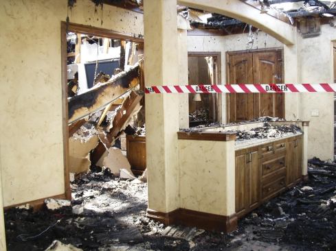

Fire Damage
From an emotional standpoint, no other type of loss — no matter how extensive — had the same effect on our clients as a fire. A burnt home can be virtually unrecognizable — a black, twisted, foul-smelling heap.
Fire-related insurance work can be broken down into two categories: repairing structural damage, and deodorization. The science and technology behind fire repair has made significant strides in recent years. As a result, adjusters have become increasingly used to working with skilled restoration contractors, and they don't want to pay to replace any items that can be cleaned and deodorized.
At a minimum, contractors working on fire restoration should receive the IICRC's Fire & Smoke Restoration Technician certification (or the equivalent). This training is also helpful for understanding the deodorizing chemicals and equipment used in fire restoration.
Smoke deodorization can be very tricky. One of our most difficult "fire" jobs resulted from a neglected pot roast that slowly burned to a crisp on a stove. While there were no actual flames or sooty smoke, the home's interior was coated with a sticky yellow film and permeated with the nauseating odor of burnt meat. We were able to remove the film and odor from all the home's nooks and crannies, but it took a tremendous amount of effort.

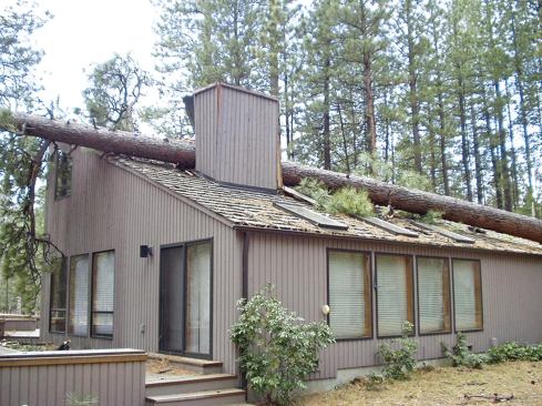

Insurance policies cover just about any type of damage caused by something hitting a building, from trees to drunk drivers. To me these are the most interesting and challenging types of losses, because they often involve structural issues that require the assistance of a structural engineer. For example, we once were involved in the repair of a house that had been partly knocked off its foundation after a runaway construction crane rolled into it.

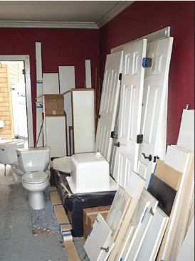

Contents Cleaning and Storage
In virtually every job, there are wet or smoky contents that need to moved, cleaned, or stored. This is an aspect of restoration that a lot of contractors don't give much thought to, but it can be very lucrative if you have the proper training, equipment, and warehouse space. You'll also need proper insurance — including coverage for handling, transporting, and storing materials (usually treated as three separate activities by insurance companies) — and strong organizational skills. Since you'll be dealing with your clients' personal belongings, you'll also need patience.
At first, our company handled just structural repairs and drying and subcontracted the contents handling to a specialized company. That allowed us to be a full-service contractor while avoiding some of the initial startup and liability costs of owning our own facility. Eventually, however, we built a dedicated warehouse and content processing facility, and brought everything in-house.
