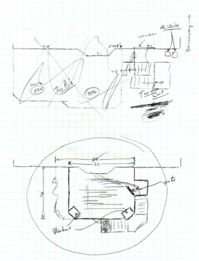

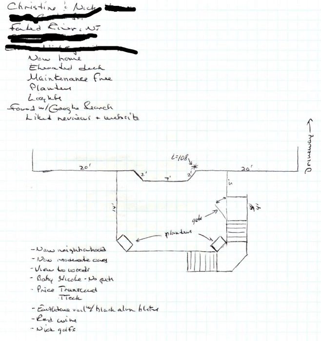

Keeping track of important client information on 1/4-in. graph paper allows you to also quickly sketch out the home's critical dimensions and even a preliminary deck design during your initial client visit.

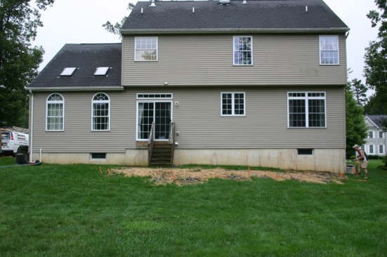

How do we get from “here”—a bare backyard—to “there”—a successfully completed deck project that accomplishes the homeowners’ design goals? Simple … we ask the homeowners for their guidance.

Before…
…and After

I made it a point to be on time and to come prepared with a good tape measure (I left the ratty ones on the jobsite), 1⁄4-inch graph paper, an architect’s rule, and some pencils so that I could sketch out designs right there.

Meanwhile, I would take reasonably accurate measurements of the back of the house, noting elevations and major features that I would sketch out on graph paper. I then would use the clients’ answers to my questions to draw a preliminary design following my general principles of traffic flow. At this point, I wasn’t too worried about nailing all the details, and I continued to take notes for later reference.

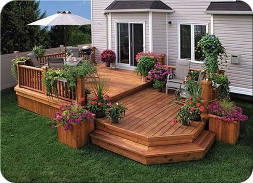

Sure, it looks nice...but dividing this small deck into two separate spaces with an awkward step makes it less functional, especially when traffic flows right through both areas.
Sure, it looks nice…but dividing this small deck into two separate spaces with an awkward step makes it less functional, especially when traffic flows right through both areas.

Unless I was designing to fit specific deck furniture or a feature such as a hot tub, I never split elevations on decks with less than 500 square feet of surface area. This may look good on paper, but in practice, the split level sacrifices function for aesthetics.

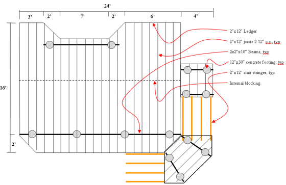

It's easy to sketch out different options while discussing the design with the homeowners and taking plenty of notes.
Once the design is finalized, it's possible to draw up a construction plan based on the field notes.
I also strove to minimize waste in my deck designs. For example, if there would be a picture-frame border, I sized the deck so that it measured 20 feet 10 inches wide instead of an even 20 feet, allowing me to use full 20-foot deck boards within the border.
Typically, I would be able to sketch out a basic design during our first meeting, using my clients’ reactions to that sketch to either modify the initial design or to totally start over. This is when we would talk more specifically about materials, railings, lights, and other features that would have a major impact on the appearance and cost of the project.
From before…
The homeowners should be involved in every step of the journey, from first sketches to the completed design.
…to After. Try to involve the homeowners in every step of the design process by asking questions and listening closely to their answers.
Before leaving, I would have a pretty good idea of what the final deck design would look like, and have sketches and notes on my original contact sheet to complete the working drawing back in my office. Later, I would schedule a follow-up meeting, when I brought my soon-to-be new customers wine or beer and something for their kids, which always made it easier for them to sign the contract so that we could get started on building their new deck.
