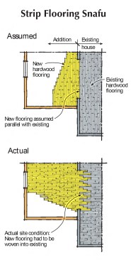

The biggest overrun – $335 for flooring – reflects the extra cost of blending new flooring into old.
My sub’s square-foot prices for flooring are usually pretty good, but in describing the job to him I made one little mistake: I told him that the new flooring could be installed the easy way – running alongside the existing flooring (see illustration). Had he visited the site, however, he would have noticed immediately that the flooring had to be installed the hard way. Weaving new strip flooring into the butt ends of existing boards involves a lot more work, and the sub charged accordingly.
Altogether, I lost $513 on these three items. What’s the lesson? I’d rather keep taking phone quotes, especially on relatively small parts of a project, because time will always be a factor in estimating. One solution is to add money to phone quotes to allow for contingencies, even if extra work is not apparent at the time of the project estimate. Actually, I did add a $400 contingency to the drywall bid of $2,354 on this project, to cover the extra cost of various patching I knew would have to be done. As it turned out, the drywall contractor didn’t ask for anything extra, so I got to keep the $400. This was not the result of good estimating, just good luck.

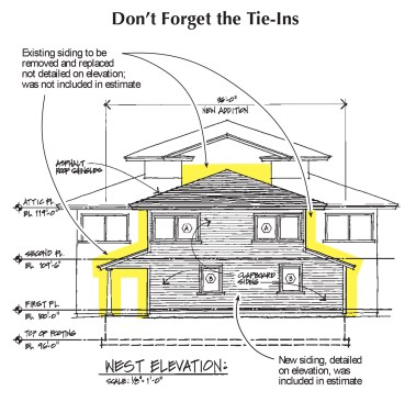

Elevations for house additions often show new areas of roofing or siding in full detail; adjacent existing areas, however, appear as blank, undetailed surfaces. While this technique clearly distinguishes new work from old, in doing takeoffs it’s easy to make the mistake of measuring only the new areas. This ignores the fact that existing areas are almost always disturbed and must be partially or completely redone.
On this job, I failed to account adequately for this work, which included roofing, siding, interior and exterior paint, gutters, flooring, and baseboards. I’d guess that at least some of the $150 roofing overrun mentioned above had to do with tying into the existing roof. My most serious failure in this respect was with siding, where I completely missed several sizable areas of existing siding that had to be removed and replaced to construct the addition. We were able to avoid additional materials costs by reusing salvaged siding. However, it took two carpenters nearly 16 man-hours to re-side these areas. At an average cost of just over $18 per hour, this error cost me almost $300.
This happened because I failed to take the time to really think through how the work would be done. I was aware of the tie-in problem, but didn’t foresee the extent of the work it would require. .

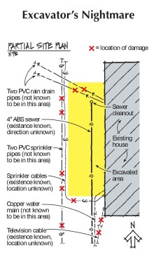

When I prepare a proposal, I choose from a list of standard contract clauses, including those that apply to the particular job. One clause deals with buried obstructions and says the following: “Underground Items: I will do my best to avoid damaging underground utilities during the course of construction. However, repairs to and/or rerouting of any such underground utilities will be an extra charge.” Since there’s no way to be sure what is buried where on a site, it’s fair to charge extra for any repairs, providing you do your best to avoid damage.
When we began excavating, we discovered that the side yard was full of buried pipes and wires (see illustration, above). We knew about the sanitary sewer and its cleanout, which would have to be relocated. We were also able, with great care, to avoid breaking the copper water main. Unfortunately, we were not so lucky with the PVC sprinkler pipes (broken in two places), the sprinkler control wires, the TV cable, or the rain drain from the existing house. Worse, when I checked the proposal for the underground utilities clause, I found that it was missing. Since there was no basis for a change order, I had to pay for the repairs myself. This included the TV cable and the sprinkler pipes, which were broken again later in the project. I calculate that all these repairs, in materials and time, amounted to $410 of work for which I wasn’t paid.

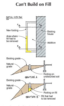

As luck would have it, this house was located on a hillside. The addition was to be built on the downhill side, which had been leveled when the house was built. However, when the excavation was complete and the form work for the foundation was in place, the building inspector noticed that the front outside corner of the foundation was still resting on fill.
I was ordered to remove this down to the level of the natural slope. I ended up doing the work myself, but – you guessed it – the excavation clause was also missing from the proposal. This omission cost me $140 of my own time – 4 hours of backbreaking work with mattock and shovel on a hot summer afternoon.
