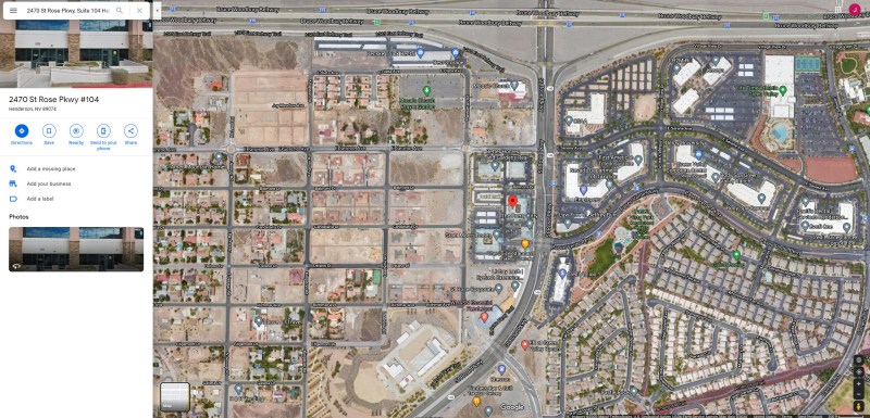

Example of map for communicating project location to other parties.
  • Collect and use images from tools like Google Maps and Google Earth. If possible, print these and mark locations on them. For example: If the problem is with the roof, driveway, or something in the backyard, an aerial image from Google or Bing with an indication of where the investigation is taking place can be an amazing aid in helping others understand the situation (example, above).

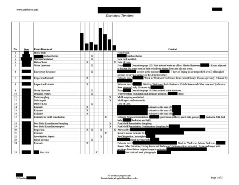

  • Collect the information necessary to make a list of people involved along with a timeline or a list describing the service history (example below). Or collect the information so someone else can create these lists.
Timeline example

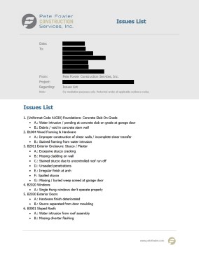

  • Prepare an “issues list” (this includes problems, complaints, damages, etc.) and print for use during your investigation to guide your photographs and documentation. Be sure to organize this information in a sensible manner for later review (sample below).

Example of part of an issues list.
