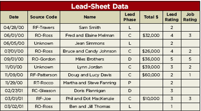

Our remodeling company has been using lead sheets — simple printed forms on which we record information about potential clients who call our office — for several years now. We described the process in a previous Business column (“Save Time With a Lead Sheet,” 8/07); here, I’ll explain how we use the data we gather to better focus our sales efforts on those clients and projects that best suit our company.
At the initial call, we fill in the lead sheet, then store it in a binder. Once every quarter, I enter the data from the lead sheets into a spreadsheet that has been set up to produce a number of graphs. The nice thing about a graph is that you can look at it and know immediately whether the trend is up, down, or steady. If we looked only at raw numbers, we might not see the larger trends.

One key piece of information we collect during the initial phone call is the source of the lead: Who told the potential customer about our company? Not only do we want to know where the leads came from for jobs we did get; we also want to track this data for jobs we didn’t get.
To record the source, we use a two-letter code that starts with an R (for referral): RF if one of our friends or family members made the referral, RA if the referrer is an architect, RT for a trade subcontractor, RC for a current client, RP for a past client, and RO for any other source. If the potential client is a repeat client, we use RR.
We also add the name of the person who made the referral; if it’s our friend Joe Patterson, for instance, we code the lead “RF-Patterson.”
Although most of our clients are referred to us, we do get leads from other sources: job-site signs, newsletters, mailings, our Web site. We have codes for all these things, but what the numbers tell us is that they are not good sources of business; they may bring in some leads, but rarely result in paid work.
Following the lead. Every project starts out as a lead, which we indicate with the letter L. But if the lead develops, we change the code as the job goes through its phases. If we meet with the potential customer and decide we want to work with them, we change the letter to a P. When potential clients sign a contract for us to design the project and develop specs and an estimate, the letter becomes a D; and when they sign the construction contract, it becomes a C.
Simple ratings. We rate leads on a scale of 1 to 5. A lead who seems unlikely to become a client is a 1. A lead who seems very likely to become a client is a 5. We also grade our projects after they’re done. If the project was neither profitable nor particularly attractive, it’s a 1. If it was either profitable or nice-looking, we give it a 3. Projects that are both profitable and good-looking score a 5.
So why do we record all this information? To begin with, it’s not much trouble and it’s very useful. Here’s one example: Say we analyze the data and find out that in the last five years our friend Joe referred 10 different people to us. That’s good to know — maybe we should do something nice for Joe. On the other hand, what if none of Joe’s referrals progressed past the lead stage, or those that did became problem clients? That’s good to know, too; maybe we should proceed cautiously with any referrals we get from Joe — or even avoid them altogether.
