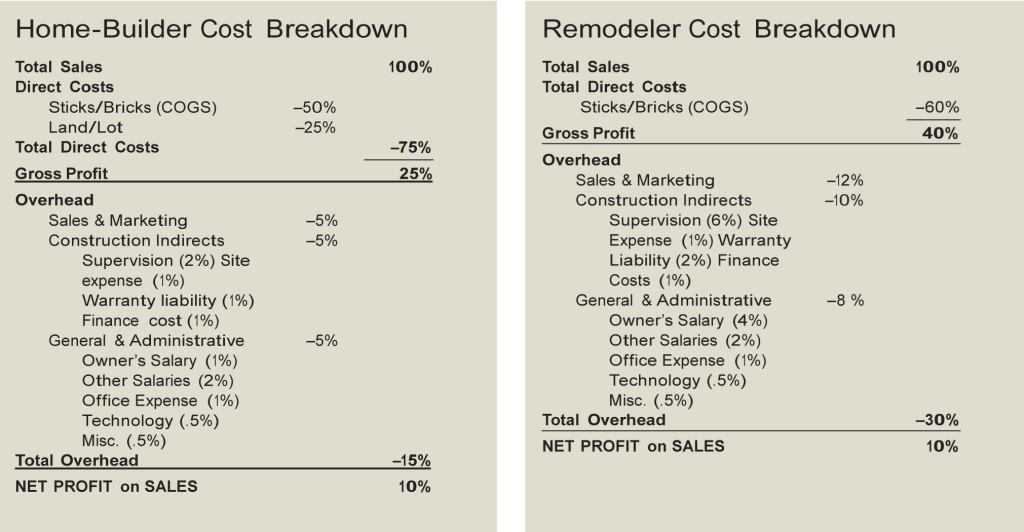

Gross profit (GP) is the difference between what you sell jobs for (total sales) and the cost of your “sticks and bricks” — the materials and labor required to produce the project. GP is what you have left before taking out any of your “overhead” (office expenses and utilities, for example) or any of your “indirect” job costs, such as supervision, warranty liability, or site costs like Porta-Johns and job trailers.
I’ll leave the details for a future column; for now, just remember that most new-home builders need to have a gross profit of 25 percent or so, but for remodelers that number jumps to 40 percent to 50 percent of sales. Why the big difference? Because remodeling projects are smaller in dollar volume, there are higher sales and marketing costs, there’s more supervision required, and there’s greater warranty exposure (see illustration, facing page).
