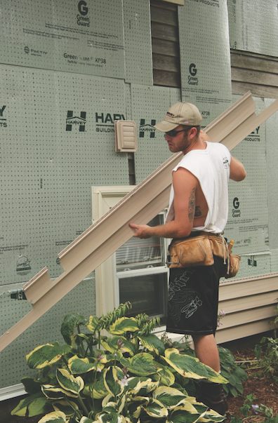

Best practice for re-siding a home calls for stripping off existing siding, then installing a good weather barrier. This can decidedly complicate a new siding job on an existing house. Instead, the industry has migrated towards what is widely marketed as an easy fix and a way to improve thermal performance and water resistance at the same time: installing fan-fold foam board over existing siding. But if it’s not applied properly, this route may lead to more problems than it fixes.

According to foam-board manufacturers, the advantage of fan-fold is really that the board provides a consistent surface over the old siding, eliminating cracks and crevices that lead to energy-robbing drafts. All manufacturers recommend taping the foam to help stop air leaks and prevent water that gets through the siding from leaking behind the foam. Unfortunately, tape is often overlooked by siders pushing to get the job done as quickly as possible. And even if you do tape, there may be problems.
“The danger is that you are putting an impermeable layer over the wall,” explains Steve Easley, a building-science expert who specializes in helping builders eliminate callbacks. “If the wall behind the foam ever gets wet—from a siding leak or a roof leak, even a plumbing leak from inside, or from excessive interior moisture condensing in the wall cavity, or whatever the moisture source—that wall will be very slow to dry.” Even when a perforated foam product is used, a solution that minimally improves the permeability of the foam, Easley argues that the potential for moisture problems will far outweigh the minor energy improvement afforded by the foam.

How about thicker foam? These days, many new homes are built with rigid foam on the exterior sheathing—a key thermal improvement that breaks the direct line of conductive heat flow through wall framing. Continuous exterior insulation works well for new construction when the walls are designed to dry to the interior. This means they have no interior vapor control layers, especially no vinyl wallpaper or vapor-blocking paints.
Remodeling is a different animal. If you install foam on the outside of an old house, and the interior walls are covered with vinyl wallpaper or have a build-up of interior paint from years’ and years’ worth of repainting, you’ll have a wall system that won’t ever dry if it gets wet. That will likely lead to mold or rot—liability no one wants to incur.
Continuous exterior foam can be retrofit to existing homes, but doing so without incurring risk requires careful attention to the interior walls. The thicker foam also complicates how you finish around windows and doors and is best done as part of whole-house rehab that includes new windows and doors, as well.
You also have to install enough foam. Because fan-fold doesn’t really do anything for thermal performance, there remains a risk of condensation. The same applies to too thin a layer of rigid foam in a cold climate: The sheathing remains cold, so there is a potential for water to condense on the inside surface—a quick way to start a mold farm. (To learn more, see “Avoiding Wet Walls” in The Journal of Light Construction, May 2017).
