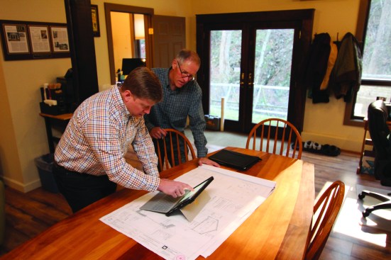

If I see that the job is going to require an architect—either because we need stamped drawings to pull a permit or because the work is too complicated for me to design without professional help—then I offer the clients a project-development agreement, which includes professional design services. If they agree, I call in an architect or interior designer, and the design process becomes a collaboration among the clients, the architect, and myself.
Typically, the architect will come up with three or four different concept sketches, which I will often present to the client to consider. On more complicated projects, where the interaction between design decisions and pricing is crucial, the architect and I will meet with the client together to present the choices. It may take several conversations to settle on the general approach, or they may just pick one and say “go with it.”
Once the clients choose, the architect will then produce a full set of drawings. Concurrently, I’ll produce the scope of work for the job. As with our basic work-scope agreement, this work occurs only after the clients have signed the agreement and paid the fee in advance (or, for larger jobs, in several installments).

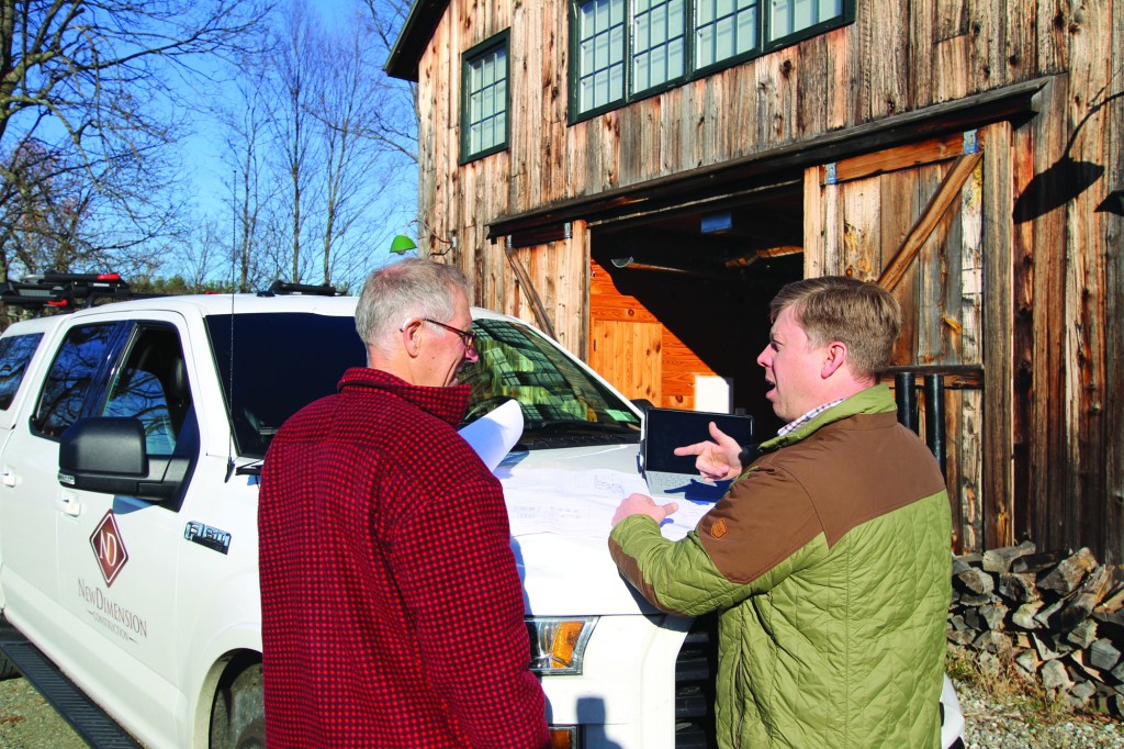

A detailed scope of work helps the author focus both the architect’s creative process ...
A detailed scope of work helps the author focus both the architect’s creative process …
... and the construction process on site, reducing wasted time and effort.
… and the construction process on site, reducing wasted time and effort.

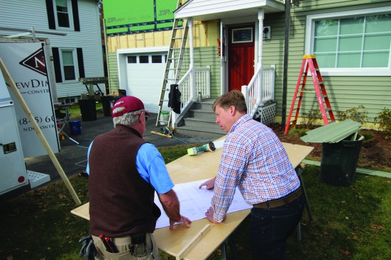

The scope of work becomes the basis for the contract—the specifications in it are the product we promise, and the costs that are called out in it make up the contract price. At this point, I can pass the job along to my production team. Kristen can handle ordering and purchasing materials for the job in a timely way, working from a rough schedule I create. My lead carpenters, Ryan Labrenz and James Curtis, can build our jobs from the plans, without much input from me. I may have to step into either the jobsite or the office situations occasionally, but because all the important decisions are already made and agreed on, I don’t have to continually manage the job.
There’s one more major advantage to structuring things this way: It draws a clear boundary for change orders. Change orders in the middle of a job can be disruptive, and in my experience, the problem occurs if the client thinks that what you are calling a change was included in the original price. That conversation used to go something like this. Client: “I think that should be included in the price.” Me: “Why do you think that?” Client: “Well, because I’m paying you a lot of money.”
But if I’ve already created a detailed scope of work that is part of the contract, I can say: “Well, yes, you are paying me a lot of money. But do you see this item you are requesting anywhere in the scope of work?” And that ends the discussion before it can turn into an emotional argument. Once we understand that this new idea involves a change order, the clients can decide whether they want that change enough to pay for it. And we can handle the change in accordance with our change-order process, which I had already explained to the client before we signed the contract.
