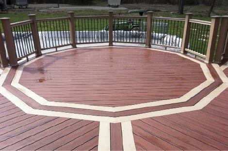

Be knowledgeable about different decking products and be ready to use them to suit clients’ tastes. I mix different manufacturers’ products in value details in order to hit a certain price point or to create a design feature.
Blending products from different manufacturers widens your palette and provides cost options. This border is made with Fiberon Horizon and CorrectDeck CX (now GAF DuraLife Siesta).
