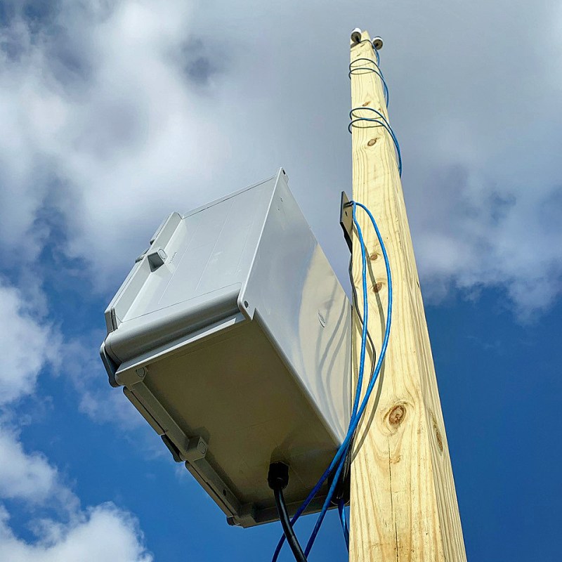

During the early phases of a new house build, Nelson Builders mounts a UniFi Protect camera system on a pole to monitor jobsite activity. It was initially installed as a security measure after a break-in, but Nelson Builders is now using it in conjunction with staged work schedules managed via Buildertrend to ensure social distancing on jobs.

I decided to go with UniFi Protect (unifi-protect.ui.com). I am the type of person who does not like to pay for something over time or be locked into a subscription; I would prefer to simply buy it outright and be done. The UniFi system has no monthly fees and allows us to store all the video on site on our own equipment. The cameras are relatively cheap (around $75 each), work off POE (power over ethernet) so they only need a Cat5 cable, have great night vision, allow remote access, can be set up with motion alerts, and can be expanded to as many cameras as we want. The picture below shows the inside of the equipment box, which has a POE switch, the UniFi “Cloud Key” (this runs the camera controller and saves all the video), a wireless AP, and a cellular modem. I could find nothing like this on the market so I had to make my own setup, down to the weatherproof enclosure.
The equipment box contains a POE (power over ethernet) switch, the UniFi “Cloud Key” (which runs the camera controller and saves all the video), a wireless AP, and a cellular modem. Unable to find such a system pre-made, the author set-up this system himself, including making the weatherproof enclosure.
