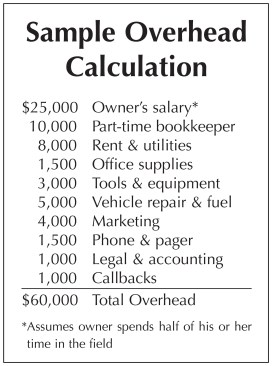

Figure 1. To find your overhead, add together all of the costs your company would incur for the year whether or not you took on any work. If you’re not sure of some amounts for the current year, make your best guess based on expenses for past years.
Calculating Gross Profit
Nobody who wants to stay in business for long can price a job at cost. In addition to the cost of materials, labor, and subcontractors for each project — called direct costs — a construction company has non-job-related expenses — called indirect costs or overhead — that must be included in the price of every job (see Figure 1). The selling price should also include profit, which every business needs both to compensate for risks and to provide capital for growth. Together, overhead and profit comprise gross profit, which is typically expressed as a percentage of total revenue.

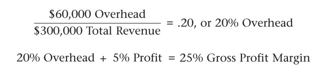

The simplest way to find the overhead percentage is to first calculate the total dollar amount of overhead, then divide by the total revenue. (If you can’t accurately estimate total revenue for the current year, make your best guess or use last year’s dollar volume.) To find gross profit, add a profit percentage to the overhead percentage. Using the overhead dollar amount from Figure 1 and a target profit of, say, 5%, the math looks like this if annual revenue is $300,000:

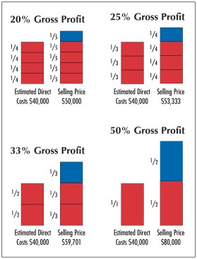

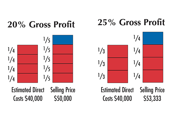

To understand why this is true, look at the four pairs of columns in Figure 2. In each pair, the left-hand column represents estimated direct costs (materials, labor, and subs) of $40,000, so every left-hand column is the same height. The right-hand column in each pair, however, changes depending on what gross profit percentage is being used to figure the selling price.
Figure 2. The left-hand column in each pair of columns is the same, and represents estimated direct costs of $40,000. The right-hand columns, which represent the selling price, vary depending on what gross profit percentage (blue boxes) is used. Taken together, each pair of columns shows how the fraction of estimated costs that must be added to arrive at the correct selling price is always higher than the fraction of the selling price that represents gross profit.
To follow through on our example, look at the pair of columns labeled “25% Gross Profit.” The blue box represents 25%, or 1/4, of the total revenue for the job. But this is 33%, or 1/3, of the estimated direct costs. In other words, when you’re done estimating direct costs, you have to add 1/3 of those costs to arrive at a selling price that will cover a gross profit of 1/4.
With a smaller gross profit of 20% or 1/5, you need to add 1/4 of estimated costs. For a larger gross profit — 33% or 1/3, for example — you need to add 1/2 of estimated costs. Finally, to earn a gross profit of 50% or 1/2, you have to sell the job at exactly twice your cost.
