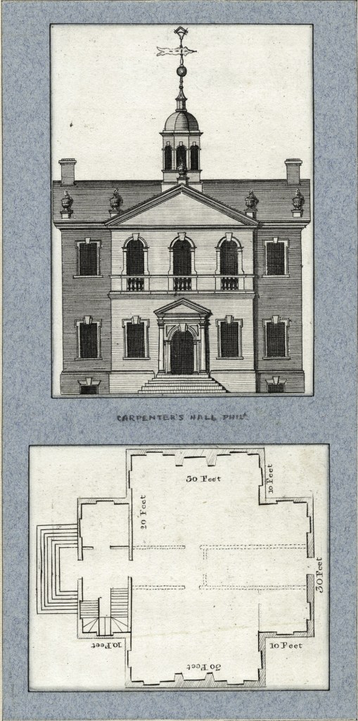

Delegates to the First Continental Congress decided Carpenter’s Hall—home of The Carpenter's Company—was a better meeting spot than City Tavern. If not for that historic meeting, the building might have been demolished by the middle of the 19th century.
New York City Public Library Digital Collections Delegates to the First Continental Congress decided Carpenter’s Hall—home of The Carpenter's Company—was a better meeting spot than City Tavern. If not for that historic meeting, the building might have been demolished by the middle of the 19th century.
Two blocks from Independence Hall, in a small courtyard off Chestnut Street, is a beautifully preserved Georgian building known as Carpenter’s Hall. This traditional meeting hall was completed in 1775 by “The Carpenters’ Company of the City and County of Philadelphia,” the oldest trade guild—founded circa 1724—in the U.S. Its members were the master joiners who built Philadelphia, and the building itself holds great historical significance as the site of the First Continental Congress.

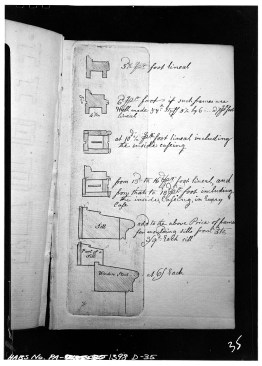

Window details shown in an original edition of the 1786 Rulebook.
Library of Congress/ Historic American Buildings Survey Window details shown in an original edition of the 1786 Rulebook.

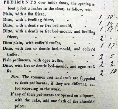

The “1786 Rulebook” contained “Articles” of association, much like union bylaws, and the “Rules for Measuring and Valuing House-Carpenter's Work,” which defined a specific process for setting prices and adhering to building standards. Included with the rules and prices were detail drawings of windows, doors, roof framing, and the like that demonstrated correct classical proportions.

Members of The Carpenter’s Company acting as measurers evaluated the work of their peers, using “rule book” prices. The book listed “plain” details along with more elaborate versions.
The Carpenters' Company of the City and County of Philadelphia 1786 Rule Book Members of The Carpenter’s Company acting as measurers evaluated the work of their peers, using “rule book” prices. The book listed “plain” details along with more elaborate versions.
