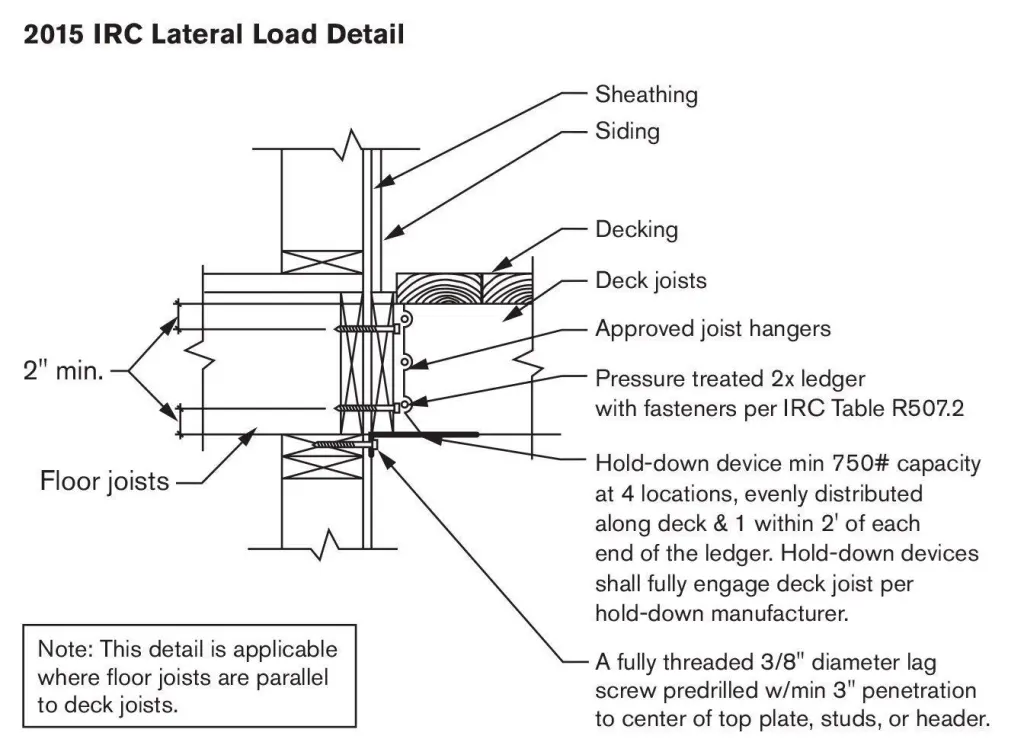

The new “permitted” lateral-load connection detail in the 2015 IRC won’t require invasive interior remodeling to install, just hardware that connects the bottom of a joist back to the wall plates, foundation, studs, or window or door headers. Currently there is no widely distributed hardware for this detail, but expect to see some prior to publication of the code in early 2015. Four evenly-spaced connections are required, each of which must resist 750 pounds.

When a lateral load anchor provision (R502.2.2.3) was introduced in the 2009 IRC, builders and code officials were confused about not only how to implement it, but also whether it was even required. While the 2012 IRC may have clarified that the detail was “permitted” rather than required, it still left questions about how to handle lateral loads if not by the “permitted” detail.
Many deck builders hoped that in the recently finalized 2015 IRC, the provision would be dropped. It wasn’t, but at least this version of the code offers an alternative that doesn’t require access to the home’s interior and is more effective and easier to install (see illustration below). Also, the new detail doesn’t create a thermal bridge, as the older one does (by connecting metal hardware located outside and inside the structure).

Partially as a result of this research, a proposal to remove the existing lateral-load provision was submitted to the IRC development committee. Another proposal provided a second “permitted” detail (shown in the illustration on page 16), based on the same assumed values of resistance in the current IRC:
R507.2.3 Deck lateral load connection. The lateral load connection required by Section R507.1 shall be permitted to be in accordance with Figures R507.2.3(1) or R507.2.3(2). Where the lateral load connection is provided in accordance with Figure 507.2.3(1), hold-down tension devices shall be installed in not less than two locations per deck, and each device shall have an allowable stress design capacity of not less than 1,500 pounds (6672 N). Where the lateral load connection is provided in accordance with Figure R507.2.3(2), the hold-down tension devices shall be installed in not less than four locations per deck, and each device shall have an allowable stress design capacity of not less than 750 pounds (3336 N).

The big news is that an alternative connection method was approved. The new “permitted” detail is installed in four locations rather than two, and requires a hardware connection between the bottom of a joist and a wall plate, foundation, studs, or window or door headers that can resist 750 pounds. The connections must be evenly spaced along the ledger and have the same 3,000-pound total capacity (even though that load value was essentially shown to be excessive by the WSU study) as the method that uses two 1,500-pound anchors.
