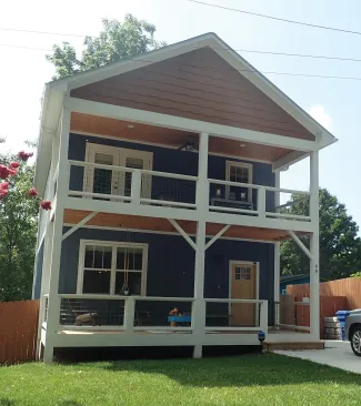

Let’s look at a typical two-story covered deck, as shown below. The roof and floor framing are supported by beams at each level that are connected to the house and three posts across the front. The residential floor live load is 40 pounds per square foot (psf) with a 20-psf roof live load. The deck dimensions are 8 feet by 24 feet with a 1-foot roof overhang, and the maximum vertical distance between the support beams is 9 feet, which is used to determine the post height.
OLYMPUS DIGITAL CAMERA
The tributary areas for each level and the roof, including cantilevers and overhangs, must be added together when sizing the deck posts that support the two-story 8-by-24-foot covered porch shown here. These tributary areas are illustrated in the drawing below.
Shaded above, at left, are the tributary areas supported by a corner post of the two-story 8-by-24-foot covered porch shown in the photo (top). The total tributary area supported by each post is 65 sq. ft. (roof) + 24 sq. ft. (second floor) + 24 sq. ft. (first floor) = 113 sq. ft. Similarly, above, at right, the tributary areas supported by the center post are shaded. There are no loads on the center post from the truss roof, while the tributary areas on the first and second floors measure 48 sq. ft. each, for a total tributary area of 96 sq. ft. Tributary areas are used to size the posts and footings.
Tributary area. In the illustrations below the photo, I show the tributary areas at each deck level that are supported by one of the corner posts (at left) and by the center post (at right). When you use the deck post sizing table (Table R507.4) in the 2021 IRC, the tributary areas for each level and the roof, including cantilevers and overhangs, must be added together. On our deck, each corner post supports a tributary area from the truss roof of 65 square feet, which includes the overhangs, and a tributary area of 24 square feet at each floor level. To find the total tributary area supported by each corner post, add the tributary areas for the roof and the two floors: 65 + 24 + 24 = 113 square feet.
Because of the truss roof, the center post supports only the first and second floors. The area on each floor supported by the center post measures 4 feet by 12 feet, so the calculation to find the total tributary area is 48 square feet x 2 = 96 square feet. Because the 113-square-foot tributary area supported by each corner post exceeds the area supported by the center post, I use the corner-post tributary area to size all three posts.
IRC Table R507.4 shows deck post sizes based on load, wood species, tributary area, and maximum post height allowed. For the load, I use the larger of the floor live load or ground snow load. From the table, a southern pine 4×6 post would be sufficient to support a 113-square-foot tributary area with a 40-psf live load or ground snow load for the building location and a deck post height less than 9 feet 8 inches. If a square post is preferred for aesthetic reasons, you could use a 6×6. Remember, a one-piece post ensures the load path is continuous to the footing as required by the code.
After calculating the tributary area and load, use 2021 IRC Table R507.4 to size posts according to height and wood species. In this example, with a maximum tributary area of 113 square feet and a 40-psf live load, either 4x6 or 6x6 southern pine posts could be used for the porch’s corner and center posts. Table R507.4 is copyrighted material excerpted from the 2021International Residential Code. Copyright © 2021. International Code Council, Inc. All rights reserved. Reproduced with permission. www.ICCSAFE.org.

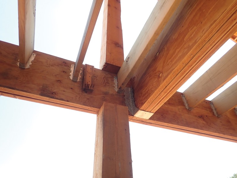

The connections are the most critical component of multilevel and covered decks and must be designed to resist gravity, uplift, and lateral loads. Roof beams should be connected to the post based on an uplift load that may be determined from IRC Table R802.11.
While probably not familiar to most deck builders, 2021 IRC Table R802.11 can be used to determine uplift loads on the deck-post-to-roof-beam connection. As shown in the shaded area, the uplift force for each truss connection is 356 pounds, or 178 pounds per foot along the length of the beam supporting the roof trusses. The total uplift load on the post = 178 x 5 (half the beam span + 1-foot overhang) = 890 pounds. Table R802.11 is copyrighted material excerpted from the 2021International Residential Code. Copyright © 2021. International Code Council, Inc. All rights reserved. Reproduced with permission. www.ICCSAFE.org.
In our example, the truss roof has a 5:12 slope and 24-foot span, and trusses are spaced 24 inches on-center. The building is located in a 140-mph ultimate-wind-speed zone with an Exposure Category B. According to Table R802.11, the truss-to-beam tie-down connector should be sized to resist 356 pounds. The beam uplift force to the post may be calculated by dividing 356 pounds by the truss spacing (2 feet) to arrive at a load of 178 pounds per foot. The tributary roof length to the post is equal to the 12 inches of the overhang plus half the 8-foot beam span, or 5 feet. The total uplift load to the post end is then 890 pounds (178 pounds x 5 feet). A post cap or notch (with fasteners checked for uplift) as shown in IRC figures R507.5.1(1) and R507.5.1(2) should be used at the topmost post elevation to attach the beam.

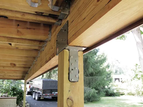

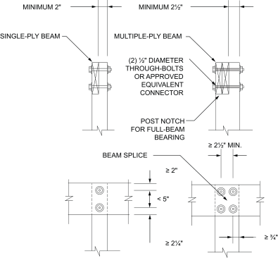

Metal connectors help keep posts and beams aligned at this critical load-path connection but also play an overlooked role in resisting uplift loads. The fasteners should be checked per Figure R507.5.1(2) (shown below) in the 2021 IRC for a covered-deck uplift load.

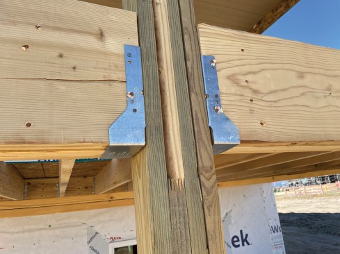

Each floor beam should be attached with a manufactured connector to a post that’s continuous through the floor cavity. The load for connector sizing can be calculated by taking the tributary area at each level multiplied by the sum of the floor live load or ground snow load plus 10 psf (in published tables, code assumes the weight of the deck framing members is 10 psf). In our example, the second-floor center beam has a tributary area of 48 square feet (12 feet x 4 feet). The beam load to the center post is 48 x (40 + 10), or 2,400 pounds. Roof gravity loads are determined in the same manner.
Beams at each level should be connected to the post face with manufactured hardware sized for the calculated beam load to the post (Figure 6). The post needs to be wide enough for the attachment, which—depending on the hardware—may require you to increase the size of the post. Steel hardware should have corrosion protection for the environmental conditions anticipated and meet a minimum of G185.
The post should be connected to the footing with a manufactured connector or embedment into the soil or concrete (see IRC Figure R507.3 for prescriptive post-to-foundation details). When choosing a post-base connector, be sure the manufacturer’s published gravity and uplift values exceed the calculated roof- and/or floor-beam loads to the post. In our example, the roof-beam loads to the post are 2,100 pounds downward (gravity) and 890 pounds uplift. Additionally, floor-beam loads to the post are 1,200 pounds downward at each level. Therefore, the post-base connection should have published capacities that exceed 4,500 pounds downward (2,100 + 1,200 + 1,200) and 890 pounds uplift.
When connecting beams to continuous posts, choose metal hardware sized to fit the posts as well as for the loads. Here, the connectors have inward-turning flanges.
