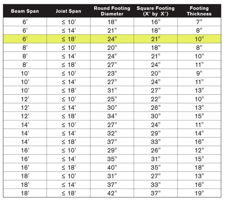

Footing size. Some deck builders use rules-of-thumb to size footings that may or may not be adequate. Others err on the side of caution and dig unnecessarily oversized footings. A third option for math-averse (but cautious) deck builders is to refer to DCA6’s prescriptive footing sizing table, which supplies footing sizes based on the beam span and joist span. The footing sizes are conservative—the assumed soil bearing capacity is 1,500 pounds per square foot (psf)—and not all beam and joist spans are listed, so often you have to move up to the next larger span. Unless your soils are really poor, you can’t go wrong using the prescriptive method.

Even though my calculations are based on a minimal bearing capacity of 1,500 psf, these footing sizes are still considerably smaller than if I had used Table 4 in DCA6. To start with, the closest table listing for a 16-foot-deep deck with 5-foot-9-inch beam spans is an 18-foot-deep deck with 6-foot beam spans. According to Table 4, round footings for this deck would need to be 24 inches in diameter and 10 inches thick for the middle footings, and 21 5/8 inches in diameter for the end footings (Footnote 2 permits a 0.9 reduction for end and corner footings: 24 in. x 0.9 = 21 5/8 in.).
