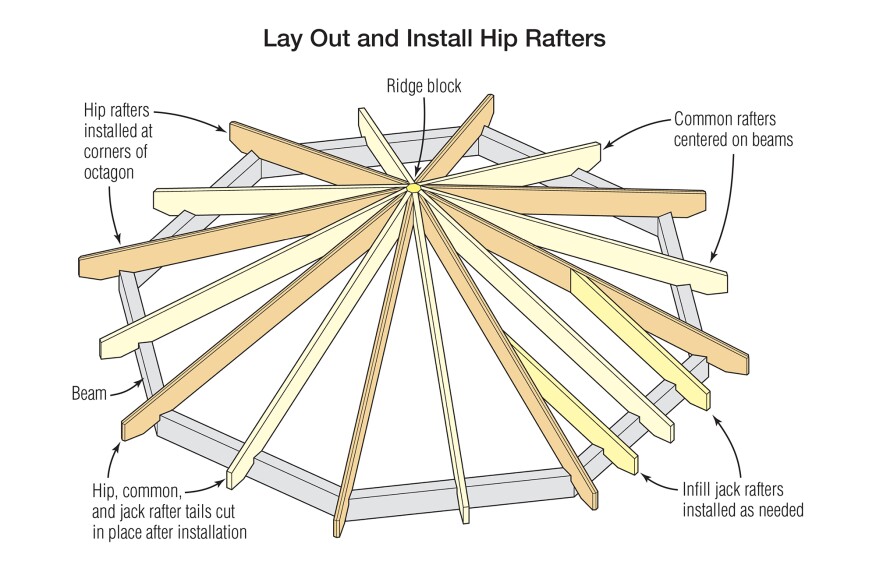

Framing the roof for an octagonal structure is a little more complex. If you ever have to build an octagonal roof, I recommend that you start by fabricating an octagonal ridge block or, perhaps, an eight-sided king post that extends down to the floor or to a beam at ceiling height. The first eight rafters, which are common rafters, will bear on the eight flat sides on the ridge block or king post. To avoid an awkward cut on the next eight rafters, which will be hip rafters, it’s imperative to make the flat sides the same width as the rafter material.

Step two: Lay out and install the ridge block and the common rafters. If there are provisions to keep the walls of the gazebo from spreading, an octagonal ridge block that’s at least the height of the plumb cut (8 1/8 inches on this roof) on the rafters may be used. In other cases, an octagonal king post that rests on the floor or on a structural beam at ceiling height may be called for. Either way, the bottoms of the joists should meet the ridge block or king post at a point that’s 33.342 (33 5/16) inches above the top of the beams.
The short points of the plumb cuts and the birdsmouth cuts should be 75.575 (75 9/16) inches apart. I discussed how to lay out these cuts in my “Rafter Layout” article, so I won’t go into those techniques here. The rafter tails can be cut in place later, after all the rafters are installed. For more on that process, see my article “Framing Eaves and Rakes” (Aug/16).
Click to enlarge
Common rafter measurements are taken from the bottom of the plumb cut and inside edge of the seat cut, or birdsmouth. These rafters are centered on the beams (or top plates) and should bear fully on the ridge block or king post, as shown.

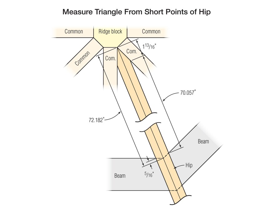

Step six: Find the distance between the short points of the plumb cut and the birdsmouth cut for the hip rafters. In step three, we established the base of the measuring triangle for the hip to be 72.182 inches. In step four, we used that dimension to demonstrate the pitch of the hip to be 6-in-13. You could use these numbers to calculate the altitude and hypotenuse of a measuring triangle for the hip rafter. But that triangle would be in the center of the thickness of the hip. So, you’d have to transfer the dimensions to the outside of the board in order to lay out the cuts at the top and bottom of the rafter. This transfer can be difficult to visualize and mark accurately.
I’ve found it’s easier to use a measuring triangle that runs along the outside edge of the rafter material. This will have a base that is significantly shorter than the one in the center. It starts at the short point of the 67 1/2° bevel where the hip rafters meet the common rafters at the ridge block and ends 5/16 inch short of the point where the beams forming the octagon converge. All told, it’s 2 1/8 inches shorter than the base at the center of the rafter. If you have a full-scale drawing, of course, you could just measure this dimension directly off the drawing. Otherwise, you need to subtract 2 1/8 (or 2.125) inches from 72.1825 to find this base, which is 70.057.
Click to enlarge
Because the hip rafters must fit between the commons, use a measuring triangle that runs along the outside of the rafter material rather than the center, as shown. The base of the triangle then starts where the hip rafters meet the commons, and ends short of the point where the beams (or top plates) of the octagon converge.
The altitude (or height) of this new measuring triangle is slightly shorter, too, because it begins slightly downhill from the altitude of the center triangle. Because we are dealing with a 6-in-13 pitch, we know that the altitude will rise 6 inches for every 13 inches along the base. Dividing the 70.057 base by 13 shows that there are 5.389 13-inch increments. So, multiply 5.389 by 6 to find the altitude. This comes to 32.334.
The hypotenuse of a right triangle with a base of 70.057 inches and an altitude of 32.334 inches is the dimension needed for the hip rafter layout. If you don’t mind doing a little geometry, you can find that dimension using the Pythagorean Theorem and a basic calculator, as shown in “Measure Length of Hip Rafters” illustration below. You can also plug these numbers into a construction calculator, or you can simply measure and mark 32 5/16 inches up the side of a sheet of plywood and 70 3/16 inches along the bottom. Measuring diagonally across from mark to mark should give you the hypotenuse within 1/8 inch.
