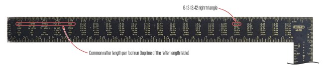

Ridge height and common rafter layout. On the first line of the rafter table (length of common rafters per foot run), the base of the triangle for all the entries is 12. The altitude is the number above the table. It’s cleverly hidden in the 24-inch scale along the edge of the square. The hypotenuse of the triangle is provided in the decimalized number just under the number indicating the altitude.
For a 6-in-12 pitch roof, then, assume a base of 12 and look under the number 6 to find the hypotenuse, or 13.42 (see annotated framing square, below). The task now is to expand this little, 6-12-13.42 triangle into a much larger triangle that preserves the angles of the little triangle and fits the roof you are building.
![To find the diagonal for a triangle with a rise of 6 and run of 12 (for a roof with a 6-in-12 pitch), look up the first entry beneath the number 6 on the framing square’s top scale. A 6-12 right triangle has a diagonal—or hypotenuse—of 13.42.](https://cdnassets.hw.net/dims4/GG/04ea8c8/2147483647/resize/876x%3E/quality/90/?url=https%3A%2F%2Fcdnassets.hw.net%2F4c%2F62%2Fde3654bb488fbe830948ada55fc9%2F0522-jlc-ttt-rafter-square-web-02.jpg)

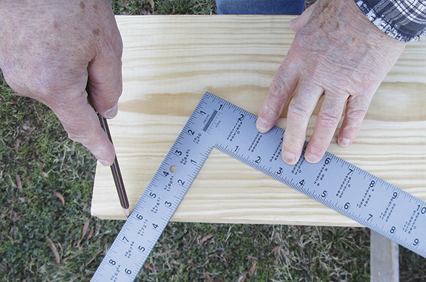

Using a framing square. To accurately lay out the plumb and level lines needed for these cuts, hold the framing square so the numbers representing the pitch align with the edge of the lumber. For this roof, the marks at 6 inches and at 12 inches should align with the edge of the rafter board. Scribing along the 6-inch side marks the plumb line; and scribing along the 12-inch side marks the level line.
![Holding the square with the 6-inch mark on the tongue and the 12-inch mark on the blade lined up with the edge of the lumber, scribe the plumb cuts using the 6-inch side and the level cuts with the 12-inch side. For greater accuracy, multiply the sides by 2 and make a plywood rafter jig with a fence, as shown in the illustration, “Laying Out the Cuts”, above and in the “rafter jig” photos below.](https://cdnassets.hw.net/dims4/GG/ffecfea/2147483647/resize/876x%3E/quality/90/?url=https%3A%2F%2Fcdnassets.hw.net%2Fe2%2F26%2Ff4f6fe55489b82d75bbc733de72d%2F0522-jlc-ttt-rafter-square-web-06.jpg)
Holding the framing square precisely, even with two marks, and at the same time scribing a line is a little tricky, so it’s helpful to clamp a fence at the marks. If you use a fence, here’s a handy tip: You can expand the size of the layout triangle by multiplying the 6 and 12 dimensions by 1.5. By placing the fence at the expanded dimensions, 9 and 18, you can mark the lines almost all the way across a 2x10.

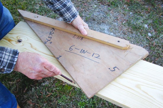

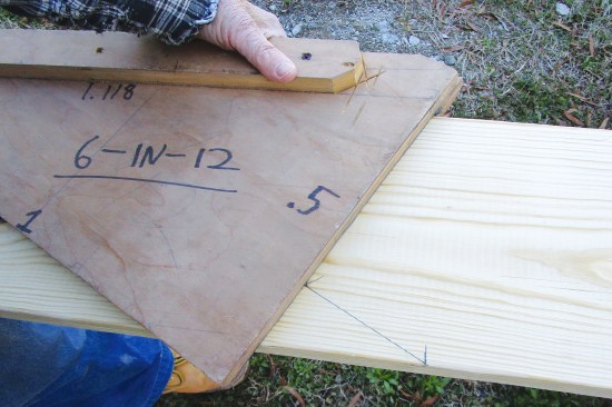

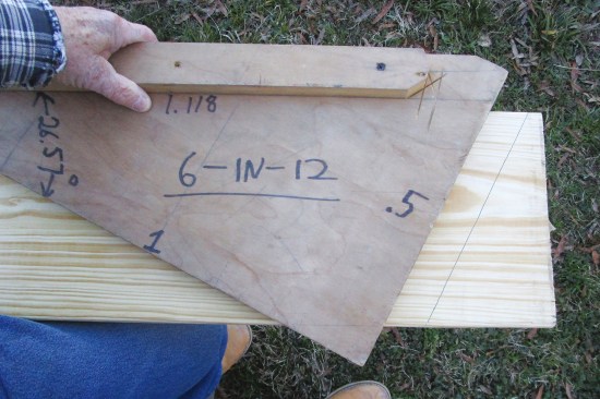

Site-built rafter jig. To help lay out the plumb and level lines on wide rafter stock, I like to make a simple plywood jig that I fabricate on site. To make the jig shown here, I start by expanding the 6-12-13.42 triangle by a factor of 2:
2 x 6 = 122 x 12 = 24
2 x 13.42 = 26.84
Doubling the size of the 6-12-13.42 triangle makes the jig big enough to reach across the width of a 2x10. Using a square scrap from the end of a sheet of plywood, I measure and mark up 12 inches up from the corner and 24 inches out from the corner. After marking a sloping line that connects those two points, I make a second parallel line 2 inches above the first, then cut the triangular piece along this second line. I complete the jig by attaching a 1x2 fence along the sloping line on both sides of the template.
To lay out the plumb cut, I hold the jig against the top edge of the board and scribe along the vertical side. Next, I measure and mark 156 5/16inches from the short point of the cut to lay out the location of the birdsmouth cut. To provide a surface to hook my tape measure to, I clamp a Swanson Big 12 Speed Square across the board and over the short point of the cut, and hook the tape to the part of the square that extends past the edge of the board.
![Fabricated from scrap plywood with a true 90-degree corner and carefully measured dimensions to match the roof pitch …](https://cdnassets.hw.net/dims4/GG/298b391/2147483647/resize/876x%3E/quality/90/?url=https%3A%2F%2Fcdnassets.hw.net%2F7f%2F2c%2Fe7b059c04c4fb3e9bee16288284f%2F0522-jlc-ttt-rafter-square-web-08.jpg)
![… a rafter jig is an accurate layout tool.](https://cdnassets.hw.net/dims4/GG/f2323dd/2147483647/resize/876x%3E/quality/90/?url=https%3A%2F%2Fcdnassets.hw.net%2Fa5%2F30%2Ffb9cce704546aa2c69bfdd1d7a69%2F0522-jlc-ttt-rafter-square-web-09.jpg)

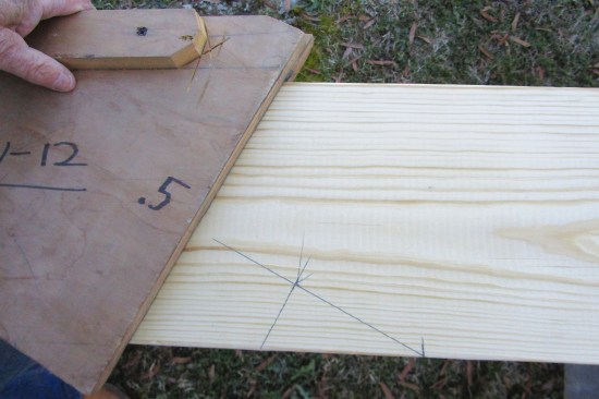

At the 156 5/16-inch mark, I use the bottom edge of the jig to lay out the level line of the birdsmouth. To do this, I keep the jig oriented in the same position, with the fence against the top of the board and the vertical side to the right. I slide the jig until the bottom aligns with the mark, then scribe the level line along the edge. To finish the birdsmouth, I make a mark on the level line that will be slightly beyond the outside of the wall. In this case, I measure and mark 4 1/2 inches along the level line. Keeping the jig in the same position, I slide it down the board until the vertical edge aligns with the mark on the level line, then scribe along the vertical edge to mark the plumb line of the birdsmouth.
![The author measures the rafter length from the short point of the plumb cut …](https://cdnassets.hw.net/dims4/GG/49ae6a9/2147483647/resize/876x%3E/quality/90/?url=https%3A%2F%2Fcdnassets.hw.net%2F93%2Ffe%2F6760bf88418ca1366f7947b3db32%2F0522-jlc-ttt-rafter-square-web-10.jpg)
![… to where the level cut for the birdsmouth begins.](https://cdnassets.hw.net/dims4/GG/0d46d67/2147483647/resize/876x%3E/quality/90/?url=https%3A%2F%2Fcdnassets.hw.net%2Fb5%2Fed%2F5296e7724251a8aa65cdadabcfac%2F0522-jlc-ttt-rafter-square-web-11.jpg)
![The long edge of the rafter jig is used to mark the level cut, which for this rafter is 4 1/2 inches long. The short edge of the rafter jig …](https://cdnassets.hw.net/dims4/GG/641b312/2147483647/resize/876x%3E/quality/90/?url=https%3A%2F%2Fcdnassets.hw.net%2F12%2Fb2%2F6a36235a4ed6897cae918833a39f%2F0522-jlc-ttt-rafter-square-web-12.jpg)
![… is used to mark the plumb cut of the birdsmouth.](https://cdnassets.hw.net/dims4/GG/68cc830/2147483647/resize/876x%3E/quality/90/?url=https%3A%2F%2Fcdnassets.hw.net%2Fa2%2Fa3%2F974fb10346bd9c62fec4c1ffa39f%2F0522-jlc-ttt-rafter-square-web-13.jpg)
Sometimes, near the end of a board, there isn’t enough surface left to hold the fence against. If this happens, you can rotate the jig (or the framing square/fence assembly) 180 degrees and hold the fence against the bottom edge of the board. You can also do this when, on wide material, the vertical edge of the jig or square doesn’t reach to the bottom of the rafter board.

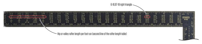

The second line of the rafter table provides the hypotenuses of 17 triangles, which all have as their base the number 16.97. To crack the code for this number, you have to go back to the phrase “per foot run.” As indicated above, that phrase means 12 inches. But, since the hip or valley runs diagonally across the layout (in plan view), the base of the little triangle is actually 12 x 1.414 (the diagonal of an isosceles right triangle if the sides equal 1.0), which is 16.97. As with the common rafters, the altitude is in the scale above the table, and the hypotenuse is in the table.
![The second line of the rafter table is used to determine the length of a hip (or valley) rafter. The second number under the 6 on the 24-inch scale, or 18, is the hypotenuse of a triangle with a rise (or height) of 6 and a base (or run) of 16.97, rather than 12.](https://cdnassets.hw.net/dims4/GG/15ac66a/2147483647/resize/876x%3E/quality/90/?url=https%3A%2F%2Fcdnassets.hw.net%2F04%2F52%2Fd7e6f6404e889aaaaadb59ff2fc8%2F0522-jlc-ttt-rafter-square-web-14.jpg)

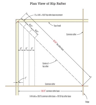

For a 6-in-12 roof, then, the little triangle for a hip or valley is 6-16.97-18. To find the length of a hip or valley to fit the 6-in-12 roof just described, use the same 11.65 multiplier used above to find the length of a common rafter. Both the altitude and the base of this triangle have already been established by the layout of the main roof. The altitude, which determined the height of the ridge, is fixed at 69.875. The base is 1.414 times the length of the base for the common rafters. The math looks like this: 1.414 x 139.75 = 197.61.

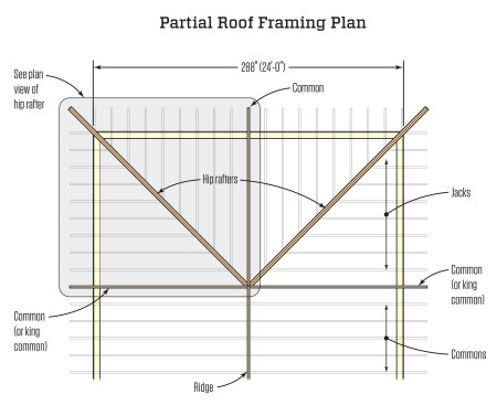

![Because hip rafters have longer spans than common rafters, they typically are framed either with engineered lumber or with doubled sawn lumber, as shown above in the “Partial Roof Framing Plan”; in either case, measurements must be made in the middle of the assembly.](https://cdnassets.hw.net/dims4/GG/3e5cfce/2147483647/resize/876x%3E/quality/90/?url=https%3A%2F%2Fcdnassets.hw.net%2Fae%2F5b%2F09de729c4a9a9a0cbaa19817c78d%2F0522-jlc-ttt-rafter-square-web-15.jpg)
![To find the length of the hip rafter base, multiply the common rafter base (139.75) by 1.414.](https://cdnassets.hw.net/dims4/GG/75e9387/2147483647/resize/876x%3E/quality/90/?url=https%3A%2F%2Fcdnassets.hw.net%2F13%2Fd1%2F3273aae94abaa83c643bf450e23b%2F0522-jlc-ttt-rafter-square-web-16.jpg)
To double-check the lengths of the altitude and base and to find the only dimension missing—namely the distance between the short points of the ridge cut and the birdsmouth—multiply all three numbers of the little triangle by 11.65. As you can see in the elevation view below, the altitude and the base check out and the critical dimension for the hip or valley is 209.7 inches, or 209 11/16 inches. This dimension, by the way, has to be measured and marked in the center of the thickness of the hip or valley.
