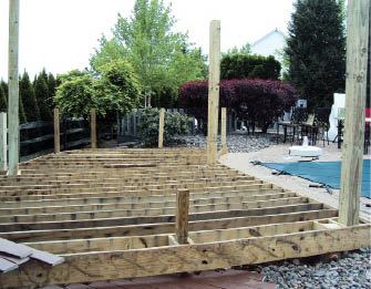

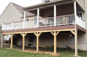

Several common situations call for a deck to be freestanding. Maybe there’s no supporting structure adjacent, as when the deck is in the middle of a lawn or around an aboveground pool (Figure 1). Or a deck may have a small connection to another structure, but not enough to borrow any stability from it (Figure 2).
Figure 1. Isolated decks, like those built around aboveground pools, have to be freestanding.
Figure 2. Decks that have only limited contact with an existing structure must be freestanding.

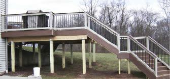

The recent code revisions regarding lateral-load support, along with the various interpretations I’ve heard from local code officials, have prompted me on a number of occasions to build a freestanding deck where previously I’d have put in a standard ledger and beam system (Figure 3). Of course, this adds a beam up against the house, and often I will still secure the ledger to the house for lateral bracing, but not for primary support.
Figure 3. Sometimes, it’s easier to build a freestanding deck than it is to comply with the new lateral-bracing codes that apply to decks with ledgers.

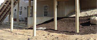

Something to keep in mind for a freestanding deck adjacent to a house is that the support posts will typically be in the over-dig next to the house. To land on undisturbed earth, the footers must extend down to the original house-footer depth. On some properties that’s not a big deal, but if the basement is 9 feet deep and the ground comes all the way up to the first floor, you could be in for quite the excavation.

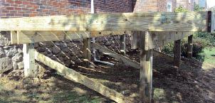

The solution to most problems is bracing (see “Bracing Details”). But where and how? Bracing designed to resist motion parallel to the house is familiar to most deck builders. Typically, it consists of 4-bys bolted at an angle between the posts and the outer beam (Figure 6). Freestanding decks also need to be braced parallel to the joists (Figure 7), something not needed on most attached decks because the house braces them in this direction.
Figure 6. Standard bracing between posts and the outer beam is used on freestanding decks, as it is on many decks attached to houses.
Figure 7. Unlike decks attached to houses, freestanding decks must be braced perpendicular to the house.
An engineer or inspector might detail a specific bit of bracing, but don’t stop there and rush into construction. Think about how the structure will age and look for potential areas of weakness or movement, then find ways to permanently address those problems. A brace needs to be strong enough to do its job years into the future. Simple nails or screws can pull out as wood dries, so use bolts, brackets, and hardware whenever possible.

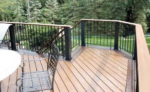

Additionally, freestanding decks need to be kept from twisting. Sometimes, the geometry of the framing itself will brace a deck against twisting (Figure 8). Installing the decking at an angle will also help (Figure 9), as will design elements like corners, landings, and steps, if they’re secured to footings (Figure 10). Other times, you’ll need to figure out some other approach, such as lagging a 2x4 diagonally across the bottoms of the joists.
Figure 8. Angled framing creates triangular shapes that brace decks against racking.
Figure 9. Angled decking adds rigidity to a square frame.

Movement can sometimes be mitigated by extending the supporting posts down below grade to a footer, instead of attaching them to an at-grade pier (Figure 12). The compacted dirt around the post acts as a brace, and helps prevent the structure from lifting. Buried posts also come into play for very low decks (Figure 13), and extending buried support posts up through the deck and the framing into the railing can make very sturdy guardrail posts (Figure 14).

Figure 13. Buried posts may be the only practical way to brace a low deck.

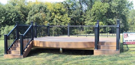

Ramps, though smaller than decks, pose their own challenges. We usually build several ramps each year, most designed to be short-term solutions. While they must be safe and secure, they also need to be easily removed without leaving permanent damage to the property once they are no longer needed. Often they float over existing walkways that limit where posts can be installed. One way to secure these temporary structures is to backfill the framing with dirt or stone. Though not an ideal long-term solution for a large deck structure, it’s great for this use (Figure 16).
Figure 16. Low decks and ramps can be stabilized by backfilling the framing with dirt, or better, gravel.
