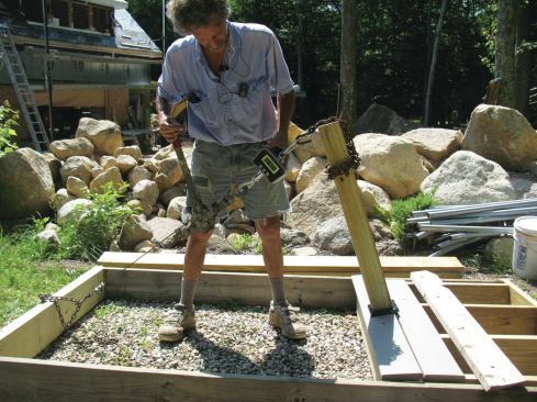

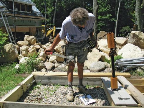

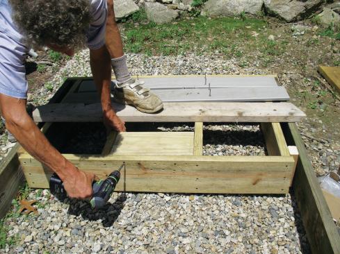

By code, guardrails must be able to resist 200-lb. concentrated loads anywhere along their length and in any direction (2012 IRC table 301.5). To that requirement, I applied a safety factor of 2.5 (as I do for wood post assemblies; see “Code-Compliant Guardrail Posts,” May 2011). IRC section R317.4 calls for wood-plastic-composite guardrail systems to comply with ASTM D7032, which requires that guard posts be capable of supporting a 500-lb.-per-square-foot concentrated load at their tops. ICC-ES Acceptance Criteria for manufactured guardrail systems—AC273 and AC174—use the same load requirements as, and similar language to, the ASTM standard.
Third-party testing services use calibrated equipment and follow set protocols to conduct tests that are recognized by engineers and code officials. My homemade test assembly was not as sophisticated: Made of 2x8s, it was a 54-inch-wide by 8-foot-long framed box, with a “rim joist” and 3-foot-long SYP “joists” set 16 inches on-center (see photo, facing page). I fastened blocking between the two middle joists and to the rim joist according to each product’s installation instructions (or drawings). I wrapped a chain at 36 inches or over the top of each post (whichever was lower) and also around a header at the end of the framed box. A 1,500-lb. digital crane scale measured the load on the post, and a hand cable winch provided the force. The downward angle of the winch cable mimicked the direction of a force exerted by someone leaning against a guardrail.
I repeated the test two or three times with each post and bracket. In some cases, if the assembly failed before the load reached 500 lb., I changed the blocking arrangement and measured the highest load the attachment could handle before it pulled apart.

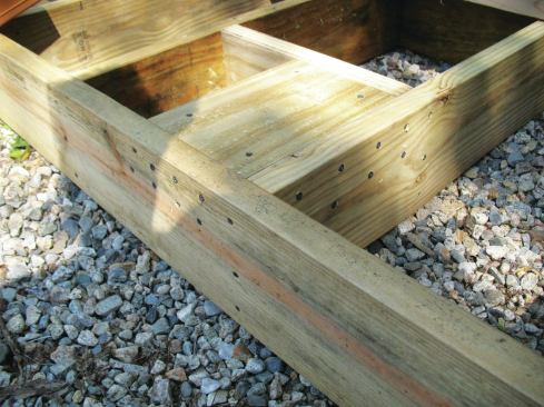

Blocking
Most of the instructions provide only sketchy blocking and fastener details, and don’t include block sizing or fastener quantities. Many include a statement that places the burden of determining proper attachment and code compliance on the installer, and some recommend review by an engineer, an architect, or a building official. I was left feeling that—just as with mounting 4×4 wood posts directly to the deck frame—installers are on their own to sort out the finer field details..

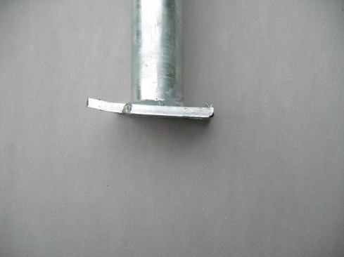

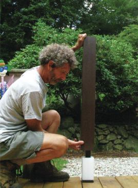

EZ Post Mounting System (ezmount.com). The EZ Post is a 36 1/2-inch-tall round galvanized pipe with a 3 1/2-inch-square base plate. Round plastic EZ Mounts that come with the kit space the post sleeve and are sized to fit either 4×4 or 5×5 sleeves. Their round design enables you to tweak the post sleeve to be perfectly square to the railing section (the other kits require the post base plate to be installed perfectly square). The company also has a 42-inch-tall version that lists AC174 compliance.
I couldn’t find installation instructions online or in the box, so I set double 2×8 blocks perpendicular to the rim joist and screwed them to the rim and to a vertical block screwed between the joists. Then I installed the post using 3/8-inch by 5 1/2-inch galvanized bolts and regular washers. At 373 lb., the double blocks broke through. I did another test—this time adding a metal plate beneath the blocking, through all of which ran the bolts—and reached 500 lb., though the bottom plate on the post bent a little.
The post doesn’t come with leveling shims, but you could stack washers between the decking and bottom of the post to plumb it.
The EZ Post kit is available through EZ Mount’s website for $37.50 plus shipping.

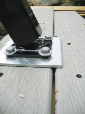

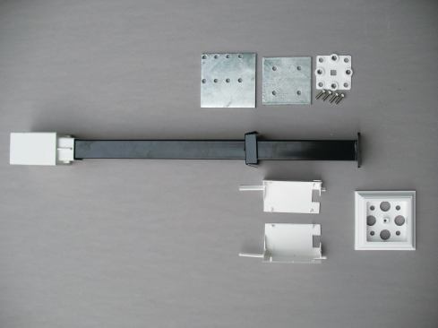

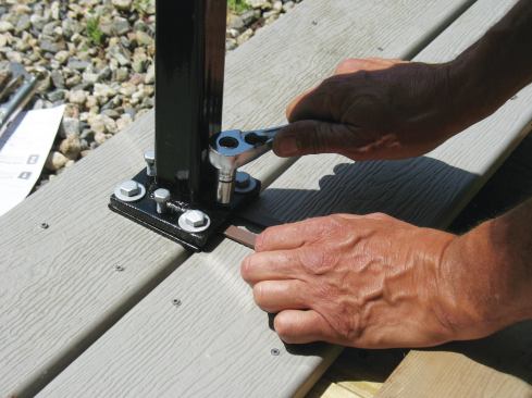

TimberTech/Azek Secure-Mount Post (timbertech.com). The Secure-Mount post is made of heavy-gauge square steel tube and a 3 1/2-inch-square base plate and comes with leveling shims to adjust the post plumb. Repositioning a set screw in the top plastic spacer block adjusts for 35 1/2-inch or 41 1/2-inch heights. The install kit includes four 3/8-inch by 5 1/2-inch galvanized anchoring bolts, nuts, and washers; a leveling plate and adjusting bolts; and a thick steel reinforcing plate. The eight predrilled holes in the reinforcing plate hug two edges so the bolts can be located within 1/4 inch of the rim joist and side joist. The holes align with those in the post’s base plate.
The blocking requirements—double 2×8 blocks run flat and perpendicular to the rim joist, with a vertical block between the joists to pick up the end of the flat blocks—are fairly clear in the included installation diagram. The blocks must run alongside one of the joists. The installation figure shows four #10 x 3 1/2-inch screws driven into the edge and ends of the blocks for a total of 12 screws. I erred on the conservative side and installed double rows of screws—one row into each flat block. The installation was rock-solid with less than 2 inches of deflection when the post was subjected to a 500-lb. load.
Expect to pay between $75 and $90 for a post and another $20 to $25 for the wood-deck installation kit.

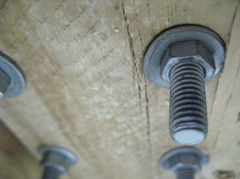

UltiMount ProSpec 36 (americanwaymfg.com). This post is made of a medium-gauge square steel tube with a 3 3/8-inch base plate. A heavy-duty 42-inch post is also available, as are kits for concrete and wood decks. The wood-deck kit includes a post, surface leveling plate, leveling bolts, block reinforcing bottom plate, and anchor bolts. While the posts are 31 inches tall, plastic top-rail stabilizer caps extend the overall height to 36 1/2 inches. The lower post stabilizer is a sheet-metal ring welded onto the post; a separate snap-on plastic rail stabilizer is installed once the post is fixed to the deck.
The instructions show a single 2-by flat block and a single vertical block between joists to pick up the edge of the block, with no references to the type or size of fasteners; I used 3-inch exterior wood screws and drove three in through the ends of the block and four along the edge into the vertical block. The weld between the post and the base snapped at 354 lb. during the test. A close look revealed a poor weld job—even though the weld bead ran all the way around on the base plate, barely 30% of the steel tube’s perimeter was welded properly. The paint finish had bridged the gap between the weld and the side of the post, obscuring the defect.

Plumb Perfect Adjustable Mount (palisaderail.com). Vinylast’s Plumb Perfect is a 37-inch-tall heavy square steel tube with a 3 1/2-inch base plate. The installation kit includes bolts and a reinforcing base plate. The post itself is 32 1/2 inches tall and the top block is bolted through the center of the post. What sets the Plumb Perfect apart is the adjustable top post-sleeve block. A large hole in the bottom of the plastic block permits access to the bolt in the center so it can be loosened to adjust the top block 7/16 inch in any direction. Steel plates sandwiched at the bottom of the block reinforce the bolt connection to the post. When the metal post within is out of plumb, the post sleeve can be adjusted plumb from the top after it’s installed—just remove the post cap to access the bolt. There’s no need to deal with adjusting bolts or shims at the base.
The blocking diagram is the same as in the TimberTech/Azek instructions. When installed according to the instructions, the Plumb Perfect showed minimal deflection under a 500-lb. load.
Each post sells for about $30 to $50, depending on the distributor, and the mounting hardware kit runs about $15 more.

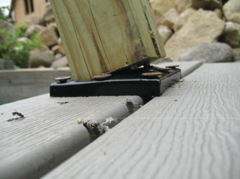

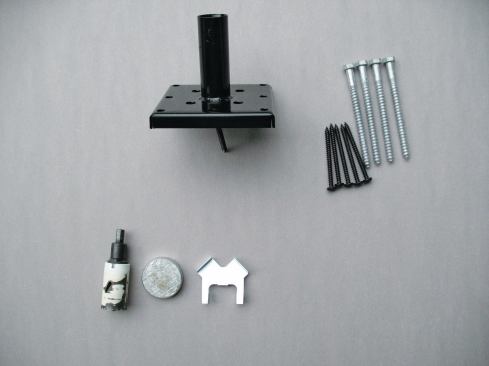

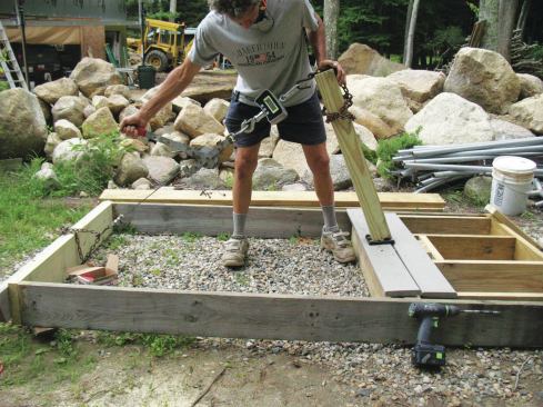

Titan Post Anchor (titanbuildingproducts.com). The Titan post mount consists of a steel cylinder welded to a base plate. The cylinder is designed to fit into a hole bored by the installer into the center of a wood post. The bottom plate is then screwed both to the post and into deck blocking. The anchor is available in galvanized, powder-coated, and stainless steel versions for 4×4 and 6×6 posts, and is sold with or without the screw hardware kit. The system can be used with site-built wood railings or with a composite railing system with post sleeves that fit over the wood posts.
For the 4×4-sized Titan anchor, I drilled a 1 7/8-inch-deep hole in the center of a treated SYP post using a 1 1/4-inch-diameter hole saw, leaving the plug core in place when I removed the saw. Then being careful to orient the anchor square to the post’s edges, I drove it onto the post using a small sledgehammer. For hardwood posts, the hole needs to be at least 3 1/4 inches deep. To reach this depth, you’ll need to either remove the first cut center plug using a hole saw, or bore the hole partway using a Forstner bit. The cut can be finished to the final depth using the hole saw—just leave the second cut plug core in place.
Titan offers two accessories to get you to this point: a center guide that positions the hole saw in the middle of a 4×4 or 6×6 post, and a hammer cap to assist in driving the anchor onto the post. The alternatives are to draw a cross between the post corners to get the centerpoint; or to drive the anchor using a 5-pound sledgehammer and a hardwood block to protect the bottom plate finish.
Four 3/8-inch by 5-inch galvanized lag screws are used to fasten the bottom plate to the post. Holes are predrilled in the plate but pilot holes are required in the 4x4s to prevent splitting.
The blocking diagram included with the kit shows a single 2×8 fastened on the flat between joists. The instructions don’t specify the size, type, or number of fasteners, but a note from the company recommends three #10 x 3 1/2-inch screws through each side joist into the ends of the block. The Titan anchor is then secured to the decking and the blocking beneath with six 1/4-inch by 3-inch screws.
According to the manufacturer, independent testing had determined that the Titan anchor complied with ICC-AC 273, where the main test is a 500-lb. load at the top of a 36-inch-tall post and a deflection measurement at a 200-lb. load. When I installed the Titan anchor according to the instructions, the inner screws pulled out of the block and decking at between 220 lb. and 270 lb. of force. I tried a different blocking arrangement using double 2×8 blocks with the grain parallel to the tension force and used through-bolts and washers instead of screws. Though the post deflected about 12 inches in the second test, the arrangement reached up to 374 lb. of tension before splitting the bottom of the post.

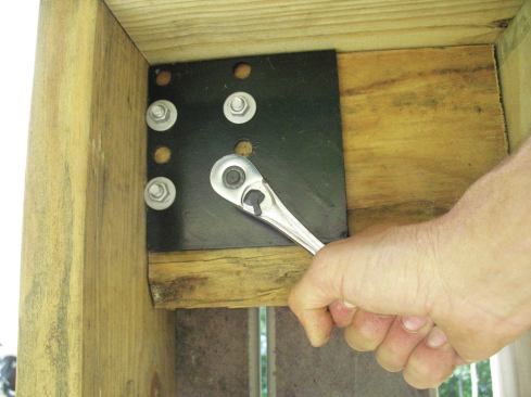

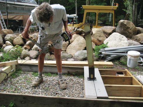

Fiberon Post Sleeve Surface Mount (fiberondecking.com). The Fiberon post mount is a powder-coated steel box with a welded base plate that bolts through deck blocking (Figure 6). Also included in the Fiberon kit are a rabbeted PT 4×4 that fits inside the base, and fasteners for anchoring to concrete (5/16-inch concrete screws and heavy-duty fender washers).
The box that receives the post measures 3 1/2 inch­es on each side so that a 4-inch post sleeve will slip over it. The blocking instructions are explicit: Fit double 2×8 blocks on the flat between the joists and against the rim board and install a vertical block between the joists at the opposite edge of the flat blocks. The 38 3-inch-long stainless steel screws needed to fasten the blocking together and to the joists and rim are not included in the kit, nor are the four 5/16-inch by 5-inch galvanized hex-head bolts used to secure the mount through the decking and blocking. Holes are bored in the sides of post receiver box for screws, to attach it to the 4×4.
There’s no out-of-plumb adjustment built into the Fiberon mount, but you could slip some washers between the bottom of the mount and the decking as shims before tightening down the thru-bolts.
One issue Fiberon doesn’t address in its instructions is how to mount bottom rail brackets to the post sleeve. Since the steel post box is 8 inches tall, I suppose you’ll have to drill through the side of the metal post box to keep the bottom rail at the proper height off the deck.
According to Fiberon, this post mount is ICC-AC174 compliant. My test scale reached more than 500 lb. with only about 3 inches of deflection at the top of the post—and that was mainly due to the washers crushing into the block by about 1/4 inch.
