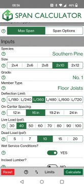

But even the L/360 limit is a bit conservative, because the IRC tables are based on #2-grade treated lumber, while some lumberyards stock mixed #1- and #2-grade treated lumber and others stock all #1 grade. When you use better than #2-grade lumber, the allowable span based on the American Wood Council’s joist sizing tables is greater than the span in the tables published in the IRC. For example, the span difference between #2- and #1-grade 2x8 southern pine treated lumber used for deck joists is 7 inches. So your decks are already stiffer with less deflection when you purchase better-grade treated lumber and size the joists based on the code table. If you want to take advantage of the even greater spans allowed when using #1 treated lumber for deck joists, you can size your joists using the AWC’s free joist- and rafter-span calculator (see screenshot below).
American Wood Council The AWC’s Span Options Calculator for Wood Joists and Rafters (awc.org) can be used to determine joist and rafter spans for most species and grades of softwood and hardwood lumber under different loading conditions. The free app (shown here on an Android phone) is also available in a web-based browser version for desktop.
