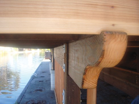

I framed the deck with pressure-treated Doug fir, rounding over the edges with a 3⁄8-inch-diameter router bit wherever the framing is exposed to view. On the ends of the support beams, I cut my signature scroll detail, also rounded over (photo above).

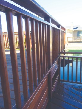

I milled the decking, railing, and trim material on site from rough-sawn #2 grade redwood from Big Creek Lumber, one of two primary sources of redwood in the Bay area. After ripping and planing the material to size, I used a belt sander to prep it for the final finish, up to 120 grit for the decking and treads, and up to 220 grit for the rails and balusters (photo below).

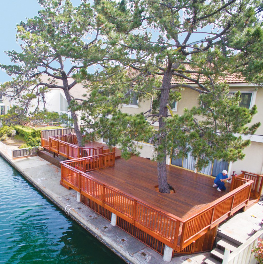

I like to notch rail-to-post connections, then round over the notches with a 1⁄4-inch-diameter bit to highlight the joints. Virtually all the other trim details on the deck, such as the coping around the tree wells surrounding the pine trees, are rounded over too.

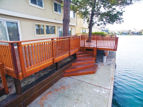

For an informal, “beach-like” feel, I gave the stairs down to the concrete patio next to the lagoon a wave-like design (photo above). To bring out the redwood’s beautiful natural color, I applied two coats of Sikkens ProLuxe transparent matte penetrating oil finish.
