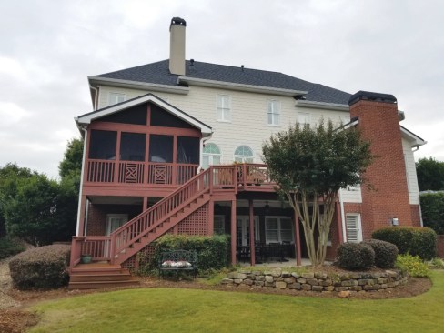

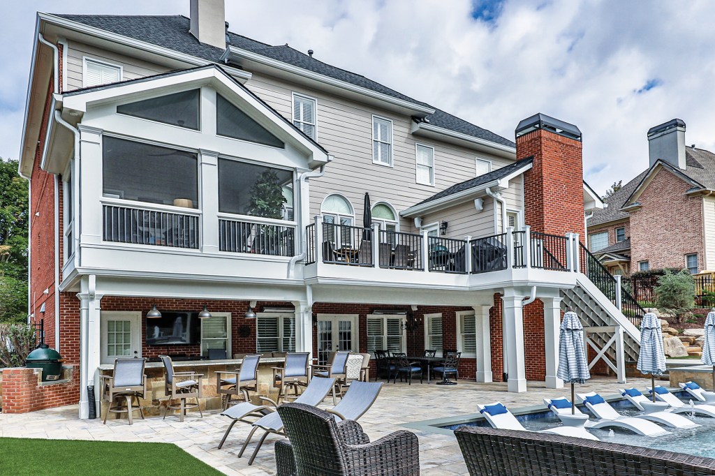

Shown here is a home's existing deck as seen during a preliminary site visit by the author. This article will walk through the process that resulted in the outdoor living space shown above, from initial contact to the final design.

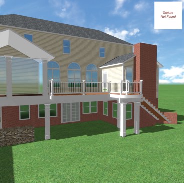

Design phase. After the estimate meeting with a client, I take the data and measurements that I’ve collected and work on a design using our standard design features. These features are versatile and look great on almost every home style we work on in our area. The look we have developed for our projects is upscale and impressive, so that our clients will feel that their project will be the nicest one in their subdivision when done.
I have prebuilt pricing models for everything in our repertoire, and they make designing and estimating efficient. For a typical deck and porch project, I can design it and have a proposal prepared in under 30 minutes of seat time. I don’t have to wait on pricing from suppliers or do many, if any, calculations. I use the standard design features as building blocks and am just entering quantities in my estimating software. That being said, I have invested a significant amount of time on the back end to make this quick day to day. It is worth it. If you have not invested in an estimating system, you should.

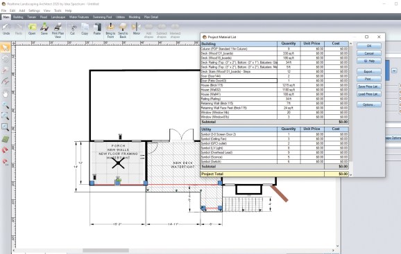

The author uses information from the client worksheet and his library of standard details to create potential plan views (above) and 3D renderings (right) in Realtime Landscaping Architect CAD software.

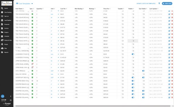

He then loads the deck’s square footage and component list into Projul construction management software, which he has preloaded with pricing, to determine a project’s estimated cost and share it with a client in the proposal.

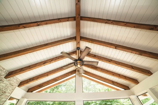

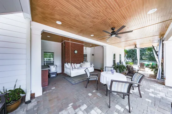

One of the two standard porch ceiling options offered by the author is exposed Douglas fir rafters and T&G roof decking.
John Humphries

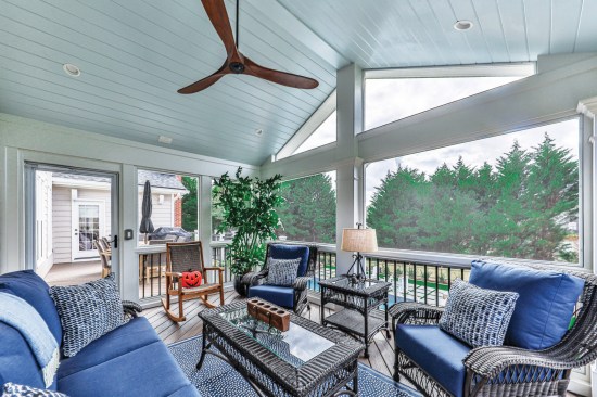

He also offers standard roof framing with a T&G ceiling. Pricing for both is based on roof pitch and square footage.

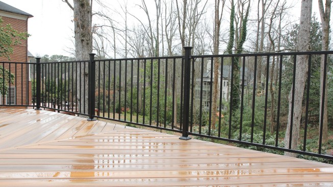

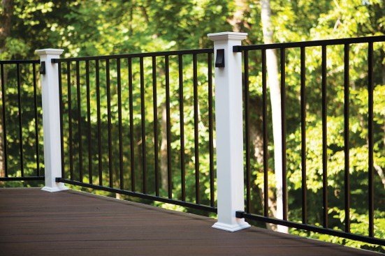

Another way the author streamlines the design and estimating process is by offering a limited number of railing options. In the two examples shown above and at right, the same black aluminum railing panel is shown with two different post styles.
Finalizing the design. Once a potential client is under contract, we use our standard details to build their project. Here’s the thing—clients don’t necessarily look at them as standard details. Walking through our showroom, they see these details as beautiful options that can be worked into their project. It’s like selecting items from a menu: A little of this, some of that, and in 30 minutes, we will have designed and specced out a $150,000 outdoor project. It’s painless for them—fun, even—and easy for us. Everything is black and white and locked in.
Sure, there are times when we do add custom components. We would be crazy not to offer them, but working with standardized options is much easier. The feedback I get all the time from clients is that they hate having to make decisions when there are too many options. Three to five options is a good range for most people. In some cases, we simply say, “This is the way we do it because we’ve found it’s the best way,” and they typically will defer to our judgment.

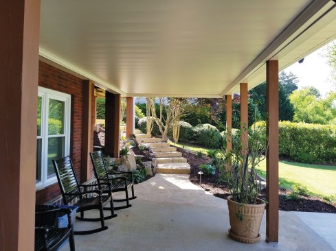

Under-deck ceiling options can also be standardized. The author’s premium waterproofing package includes column wraps, wood ceiling, and crown molding.
The basic waterproofing package that he offers uses an aluminum under-deck system and costs considerably less.

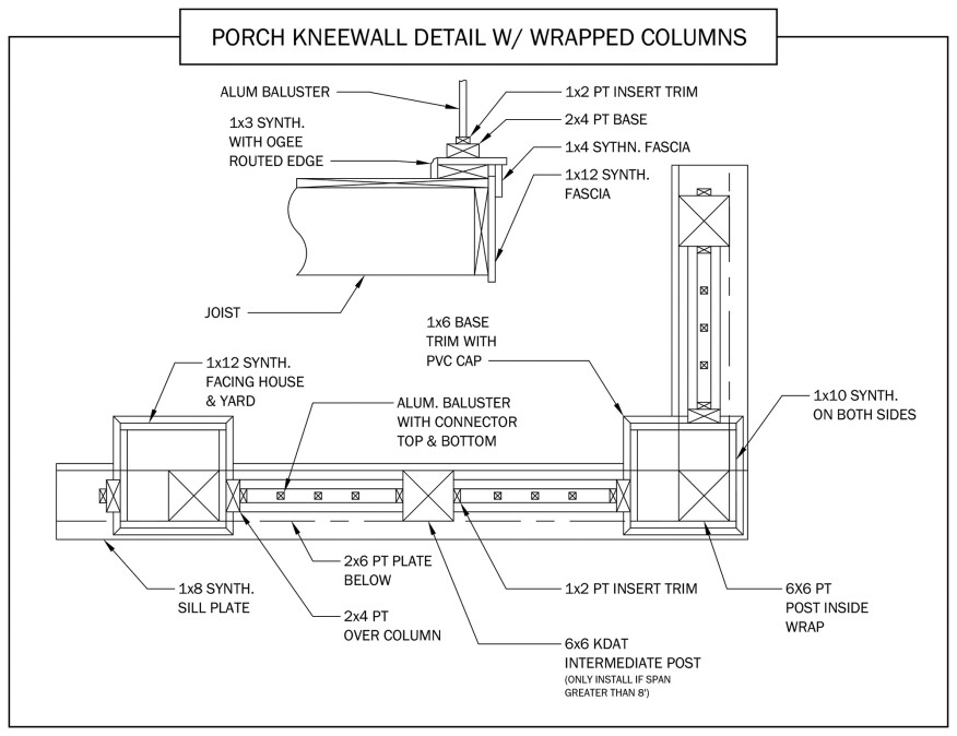

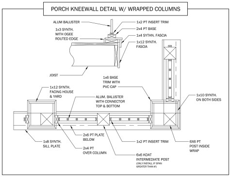

The way we do this is by drawing out the details in plan and section form and saving them in a library of drawings in the cloud that the crews can access at any time if they have a question. What we’ve found is that most of crews memorize the details after a couple of jobs. They love the fact that they aren’t standing around scratching their heads on every job and can just do what they know.
Workers in the field can refer to the author’s cloud-based library of construction details, such as the porch knee-wall detail shown here, which have been standardized to eliminate errors and produce repeatable results.
Using standard construction details results in fewer estimating/take-off mistakes, which means more profitability. We know exactly what we’ll need on site to build them. No less, no more. And because the crews have had a lot of practice building the same thing the same way over and over, we see a lot fewer mistakes. They know exactly what materials and tools they’ll need that day to complete the job.
