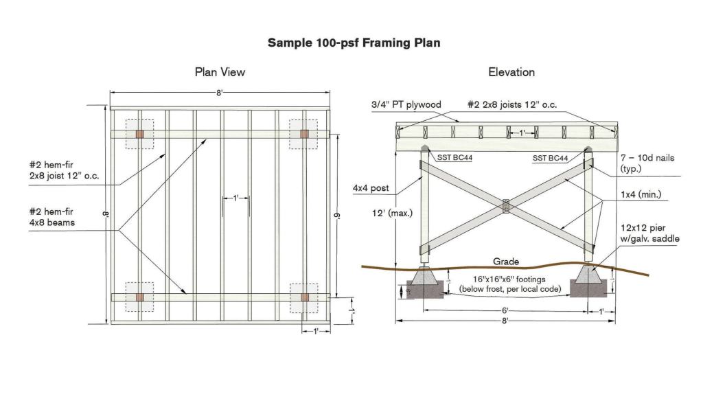

On the West Coast, this is a common framing plan to support a 7x7 tub with a potential 100-psf live load. The footings and piers are reinforced and connected to each other with #4 rebar, and the 4x4 posts are reinforced as shown with diagonal bracing. Note the 12-inch on-center joist spacing, and 3/4-inch PT plywood decking for the tub.

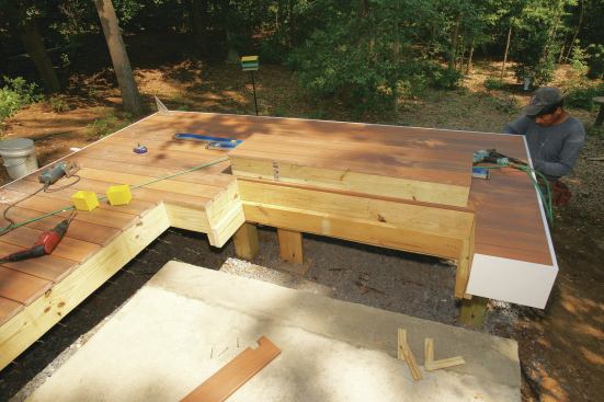

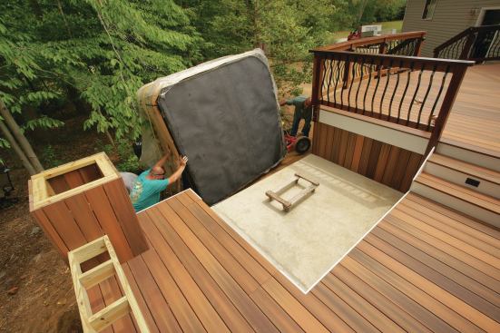

Hot tubs must be placed on a flat, level surface, such as a concrete slab or a deck, without any shims. Beyond that, many structural and design decisions depend on the particular hot tub chosen, so clients need to select their tub early in the process. Only when you know the tub’s dimensions, dry weight, water capacity, and suggested occupancy can you figure out how much weight the slab or framing will need to support.

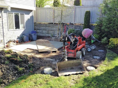

For a ground-level tub, we generally pour a 3 1/2-inch concrete slab, but large tubs may require a thicker one. If a hot tub is going to be elevated, the framing will have to support it. Because the loads from the tub, the water, and the occupants can exceed 100 pounds per square foot—and most decks are designed to support combined live and dead loads of only 50 pounds per square foot—additional structural support is usually needed.
Calculating loads. A typical 7 1/2-foot by 7 1/2-foot hot tub, for example, with a dry weight of 855 pounds can hold 420 gallons of water and six to seven people. That much water weighs about 3,500 pounds (1 gallon weighs around 8.3 pounds, depending on its temperature), while seven people with an average weight of 185 pounds have a combined weight of 1,295 pounds. The 56-square-foot tub filled with water and people would therefore have a total weight of 5,655 pounds, so the framing must be able to support a design load of at least 101 pounds per square foot (5,655 ÷ 56 = 100.98).
If you’re installing a used hot tub, look inside the pump compartment for the specs. Otherwise, you can estimate its volume (in cubic feet) by multiplying the tub’s length by its width and depth. Then, multiply the volume by 62 pounds per cubic foot to find the weight of the water that the tub can hold.
Engineering. Prescriptive beam and joist sizing tables for 100-psf loads can’t be found in the IRC or in DCA6, so I refer to a custom Excel spreadsheet designed by my engineer. Tables and calculators for different loads and wood species are also available from a number of sources, including the American Wood Council’s online span calculator (awc.org), but these are more conservative than an engineered design and typically result in an overbuilt structure. A better option for sizing joists and beams for heavy loads is StruCalc Lite (strucalc.com), a relatively inexpensive beam-design software package that is particularly well-suited for deck builders.
Most municipalities we work in require an engineered design for an elevated deck—a good idea even if it isn’t required. Nonengineered decks tend to be over-designed and overbuilt, and even then, have problems with safety. Hire a good engineer; you will have to pay his fee, but you’ll probably spend less on materials and experience less anxiety.

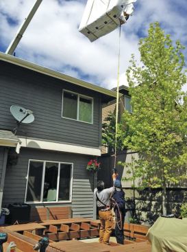

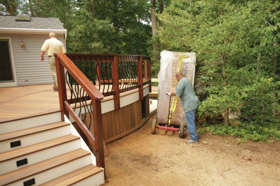

Delivery. Hot-tub deliveries are usually handled by the manufacturer’s crew. Most companies want at least one responsible party (usually the homeowner) to be present so they don’t need to come back to explain start-up procedures, controls, and the like.
When access is tight, it may be necessary to rent a crane to lift the hot tub into place. Boom-crane rental and setup can be costly, so carefully evaluate access to the backyard when estimating installation costs.

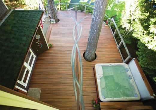

Locating the Tub
Even when the owners have an idea of where they want the tub to be located, we always review this decision carefully with them. On smaller decks, we’ve placed tubs as close as 12 inches from a house wall, which allows for the cover lift to function and provides air circulation. On a larger deck, locating a tub 17 inches from a wall leaves room for a table made up of three 5 1/2-inch-wide deck boards. If traffic needs to circulate between the tub and the wall, we place the tub at least 4 feet from the wall.

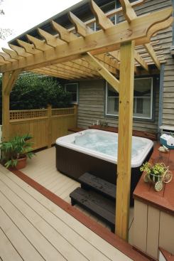

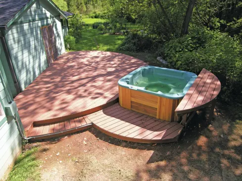

Height. A hot tub can be installed on top of a deck, flush with a deck’s surface, or somewhere in between. We don’t recommend dropping the tub so that it’s flush with the deck, though a couple of clients have opted for this. Because stepping down into a slippery spa is unstable at best, a handrail should be installed. Having the edge 2 feet or more above the deck is safer, as small children (or unobservant adults) will have a harder time accidentally falling in (for more on security barriers for hot tubs and spas, see Question & Answer,Jan/Feb 2008 and Nov 2012).
Depending on the tub’s brand, the first accessible area inside is about 13 inches down from the top, typically a step formed by the compartment containing the pump, heater, and controls. If the deck is also about 13 inches below the top of the tub, a person climbing in or out won’t be changing elevation, making it easier to balance. And since that also puts the height of the tub close to the average height of a bench, a person could also sit on the edge and swing around into the water safely.
If the tub is installed on top of a deck, a step is usually required. When framing the step, we make it removable to provide access to the pump motor.
