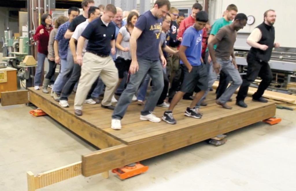

Lateral loading, possibly the most controversial topic in deck construction codes, was also discussed quite heavily. A call-in from Dr. Don Bender of Washington State University regarding his research on lateral loading of decks was eye-opening. Dr. Bender briefly explained that he had assembled a mocked-up floor system of a home and attached a deck to it. Rollers supported the outside of the deck, and it was loaded with moving people (see photo, page 14). Sensors at the ledger connections recorded the magnitude of lateral force that resulted from the movements.
One discovery was that without bracing to keep the deck from deforming out of square, significantly more force acted on the ledger, making failure at the hangers likely. The width-to-length ratio of a deck had an impact on this as well. Similar to how a longer wrench can loosen a stuck nut, the farther a deck projects out from a house compared with its width against the house, the more lateral force was generated at the ledger. Dr. Bender said that while important discoveries were made, they were not comprehensive enough to use as a basis for modifications to the current lateral-load details provided in the IRC. The results were limited by the few conditions tested. More tests are needed, but there is a lack of funding to perform them.
It is likely that the current lateral attachment requirement, along with the troublesome language of “shall be permitted,” will remain in the IRC for one more code cycle before a well-prepared alternative can be provided. Assuming the decking industry can provide the financial support, Dr. Bender is prepared to deliver the research needed to develop safe, cost-effective solutions to the problems of handling lateral loads.
