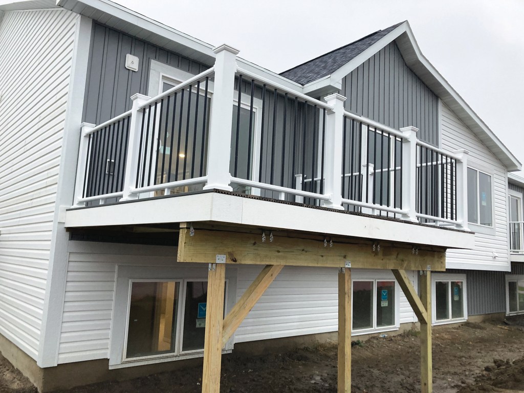

This is not to say that our decks are low quality; they comply with building codes, and we employ best practices to build them. The way we save on costs is by omitting some custom details like picture-frame borders. As the photo above shows, the result is a design with exposed deck-board ends.
For our business plan to be successful, we must be available at short notice and able to install decks quickly. Many developers in our area are short-staffed and under tight schedule constraints while dealing with hundreds of subcontractors. Consistently providing a quick turn-around is the key to best serving this client base. With modular construction, our final design can be installed on site in about four hours.

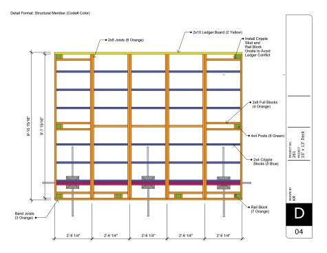

Design is the most important part of the process of building a modular deck; structural, aesthetic, and sizing problems are expensive to fix after installation. SketchUp is our 3D design tool of choice, helping us to make sure everything will be right the first time. It enables quick concepting and fine custom detailing without the unnecessary frills of other deck design software that we’ve tried.
Here is a typical framing plan for a 10-by-13-foot modular deck, which the author designed using SketchUp. This design consists of 2-foot 6 1/4-inch-wide modules that are fabricated in the shop, then later assembled on site.
The idea behind modular decking is to build sections approximately 30 inches wide by the length of the deck; in this example, about 10 feet. This is about the maximum size that we can handle in our shop and load onto our trailer without machinery. On a standard deck framed with joists 16 inches on-center, each joist supports 16 inches of tributary area. In our framing plan, the two 2×8 joists that make up the long sides of each module can support up to 32 inches of combined area, so normal span tables still apply. On our modular decks, the supported area is completely inside each pair of joists that make up the long sides of each module.
As we assemble the sections, we install 2×4 blocking (to support the decking) and 2×8 blocking (for the railing posts). While this extra step uses more lumber versus building on site, the time and labor savings make it worthwhile, since decking and railing posts can be added to the modules before we transport them to the jobsite. Another advantage is that the extra 2×4 cross-blocking helps to stiffen the joists.

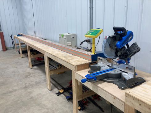

We use the plan created in SketchUp to output a cut list for all the framing, decking, fascia, and railing, which allows us to precut all of the material prior to assembly. We invested in a pre-owned TigerStop SawGear automated cross-cutting system to speed up this process, but this system isn’t required. Any setup that ensures repetitive cuts are as accurate as possible would work.
To speed production, the author uses a TigerStop SawGear automated cross-cutting system.
The modules are assembled from a parts list based on the SketchUp plan, and require dozens of accurate repetitive cuts.

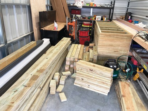

As we assemble the sections, we install 2×4 blocking 16 inches on-center between the 2×8 deck joists so we can run the deck boards parallel to the joists. At the same time, we install full 2×8 blocking where needed for railing posts. In some cases where there is a potential conflict, such as at the ledger, we hold off installing blocking until we are on site.

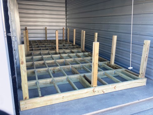

Once we’ve built the individual modules, we arrange them so that they are aligned with each other as they would be on site, but not actually screwed together. Then we install the railing posts, followed by the decking.
Shown here are the modules needed for two decks, with blocking and railing posts installed.

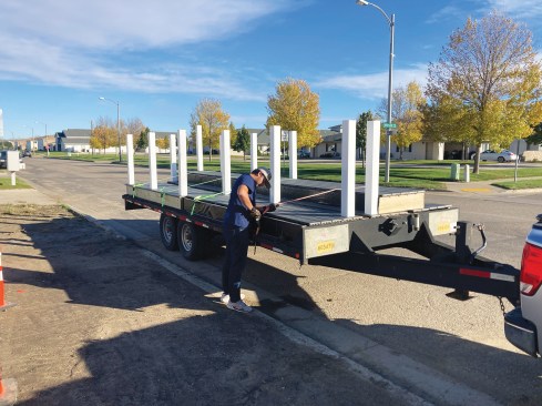

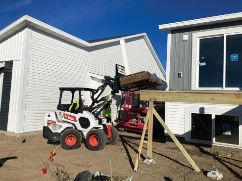

After the decking is installed, the modules can be loaded onto a trailer and transported to the site. Each module weighs about 10 pounds per square foot; in this case, the modules weighed around 300 pounds each. We moved them by hand in the shop but used a rented Bobcat L28 articulated loader to move them on site. This machine works perfectly as it allows for very fine positioning. For longer modules, we would need a forklift to move them in the shop.
After the decking is attached to the framing with clips, the modules are loaded onto a flatbed trailer for delivery to the site.

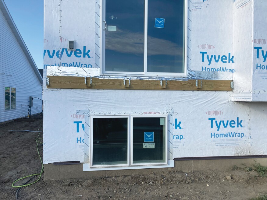

On site. Before the modules arrive on site, the ledger needs to be prepped and mounted to the house. Typically, the builder installs a dummy ledger with properly installed flashing before the siding contractor does their work. After siding is completed, we come in and replace the ledger and fasten it to the house framing with LedgerLoks. Our ledger has premounted double joist hangers to hang the modules.
The deck ledger is precut and fitted with double joist hangers off site, per the framing plan, and is installed by the crew once they arrive on site with the modules.

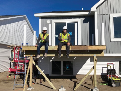

Once the ledger and Diamond Pier footings are installed, the crew installs posts, knee braces, and support beams. While we determine post heights with a laser level and then cut them to length on site, we are able to precut the knee braces in the shop. All beams are precut and nailed together in the shop so that we can simply set them in place during final assembly.
Finally, we use an articulating loader to set the modules into the joist hangers on one end while resting on the beam on the other end. Since each module acts as a kind of “mini deck” and doesn’t depend on adjacent modules to support loads, we only need to use a few structural screws to join the modules together.
After the ledger is screwed to the house framing, the crew installs Diamond Pier pin-pile footings, support posts, and the preassembled beam and knee braces needed to support the modules. Then they use an articulated loader to lift the modules into position.

The partially completed deck shown here took 15 man hours in the shop to build the modules and four man hours on site to install them.
