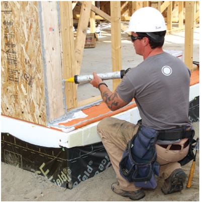

Construction proceeds as follows: After the foundation slab is poured, we frame and brace the first-story stud walls, frame and deck the second floor, and frame and brace the second-story walls. Then we apply the SIPs to the outside of this stick frame. As we stand up and attach the SIPs one by one, we apply beads of R-Control adhesive sealant to the EPS foam and also to the edges of the inner OSB skin of the SIPs. We bed the panel bases in sealant and apply sealant to any penetrations or gaps.
At the top of the wall, we extend the ceiling air barrier (Zip sheathing) under the truss heel and seal it to the outer airtight skin of the SIPs using tape (B).To integrate the wall system air and vapor barrier into the slab foundation, we fold the heavy plastic sub-slab vapor barrier around a PT plywood sill under the SIPs panel and sandwich the end between the mudsill and the bottom plate of the inner wall (C). Then we seal the corner before setting the SIPs.
