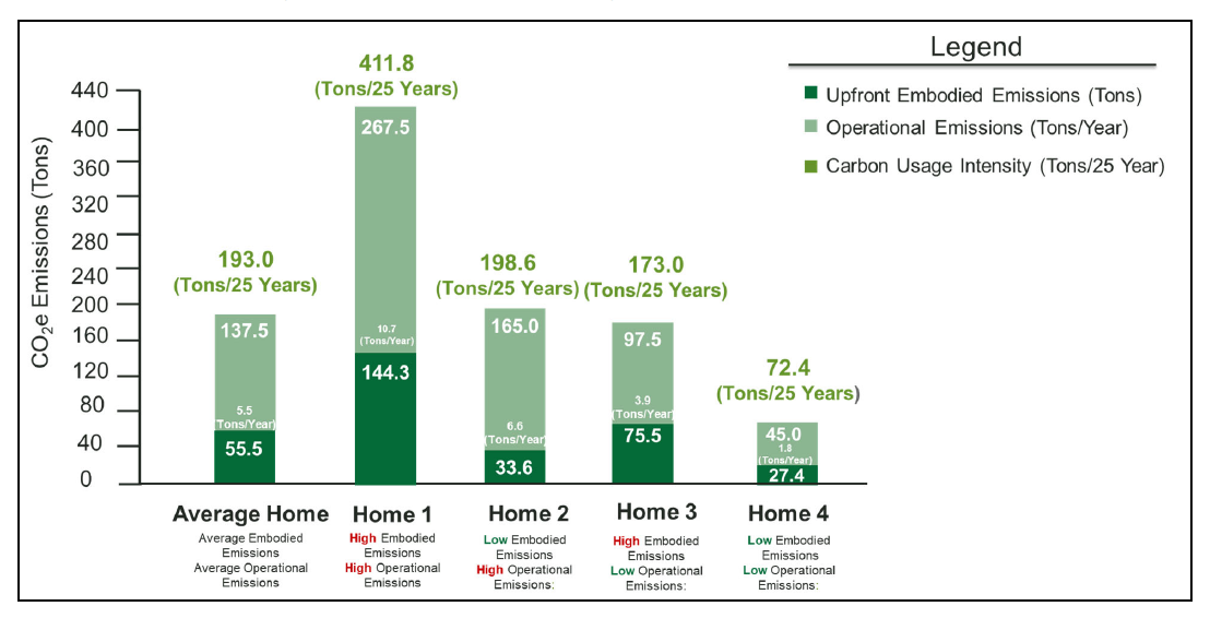

The 100 homes in the study sample produced a combined total of 5,555 net tons of CO₂ equivalent (CO₂e) in embodied carbon emissions – an average of 55.5 tons of CO₂e per home over 25 years. To put that figure in perspective: The total of the embodied emissions from this sample alone is equivalent to that of a gas-powered vehicle driving 14 million miles.
Over a 25-year horizon, embodied carbon can account for as much as 32% of a home’s overall carbon emissions. The study found that operational emissions contribute an average of 5.5 tons of CO₂e annually per home.
Extrapolating the study’s average ECE figure to Massachusetts’ broader housing market underscores the stakes. In 2024, Massachusetts built 11,390 new homes. At 55.5 tons of CO₂e per home, those homes collectively generated an estimated 632,145 tons of CO₂e in embodied carbon emissions.
Home size and type drive significant variation
The study found wide variation across individual homes. The highest-ECE home in the sample—an extremely large residence exceeding 8,400 square feet with a walkout basement, significant poured concrete, extensive open-cell spray foam insulation, and a dual-fuel heating system using both a propane furnace and an air-source heat pump—produced 144.3 tons of CO₂e. The lowest-ECE home, a compact residence under 700 square feet with minimal concrete and a single air-source heat pump for heating and cooling, registered just 18.5 tons of CO₂e.
By home type, single-family detached homes with two or more stories had the highest average net ECE at 59.2 tons of CO₂e, compared to 52.8 tons for one-story detached homes, 45 tons for duplexes, and 39 tons for townhomes. Townhomes also performed best in cumulative 25-year carbon—showing 26% lower MEP-system ECE, 32% lower building enclosure ECE, and 38% lower operational carbon than the sample averages.

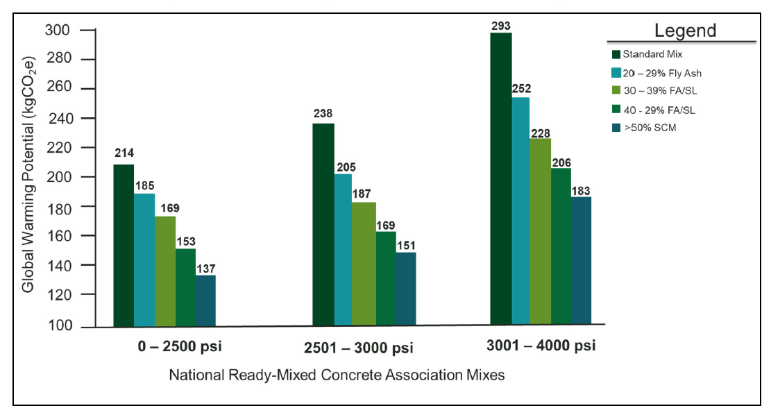

Concrete. The largest ECE contributions come from foundation walls, footings, slabs, and other concrete structural components. The study assumed all homes used a baseline National Ready Mix Concrete Association’s average mix , with a majority of the sample using a 3001- to 4000-psi standard mix (see chart below). Switching to a lower global warming potential (GWP) concrete mix could significantly cut each home’s ECE—the study found that the GWP of the most common concrete mix used in the sample was 46% higher than the lowest GWP alternative available.

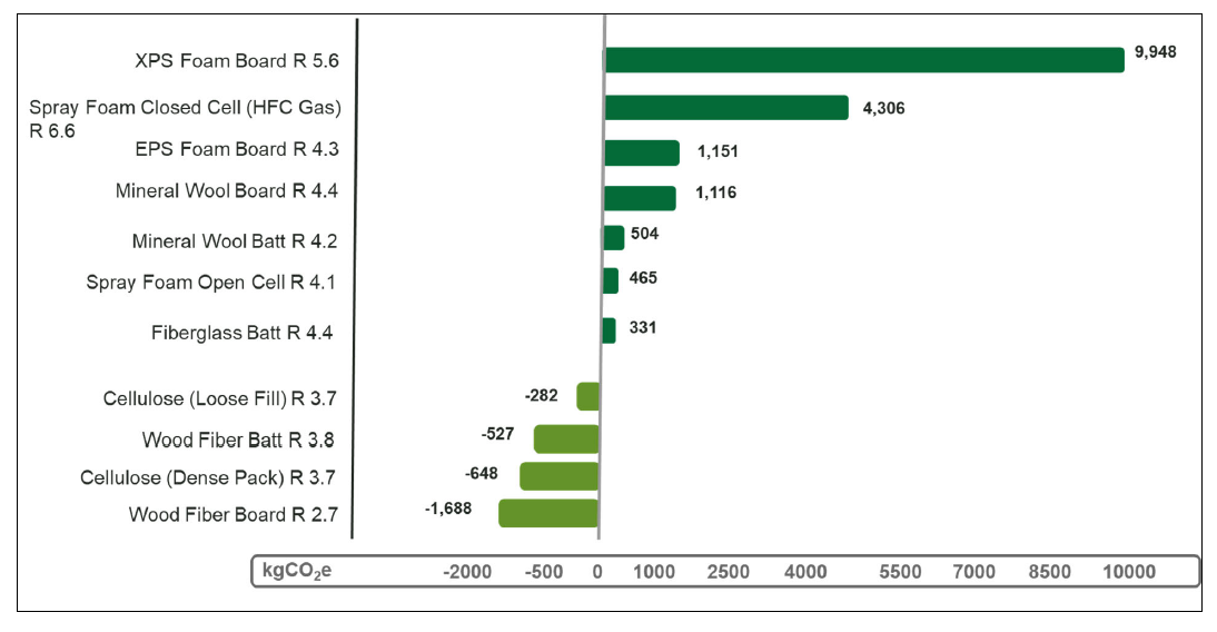

Insulation. The contrast between insultation materials is especially stark. XPS foam board carries a GWP of approximately 9,948 kg CO₂e per 1,000 square feet and closed-cell spray foam approximately 4,306 kg CO₂e per 1,000 square feet. Bio-based and cellulose-based alternatives, such as wood fiber board and dense-pack cellulose, store carbon, resulting in net-negative embodied emissions for those materials.
