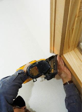

Installation. Sized so that they are 1/2 inch to 1 inch taller than the baseboard, the plinth blocks are installed flush with the door jamb (10). I install the side casings next, giving them a 1/4-inch reveal on the door jamb and on both sides of the 4-inch-wide plinth blocks. After touching up the glued corner joints with sandpaper, I nail the head casing in place (11).
