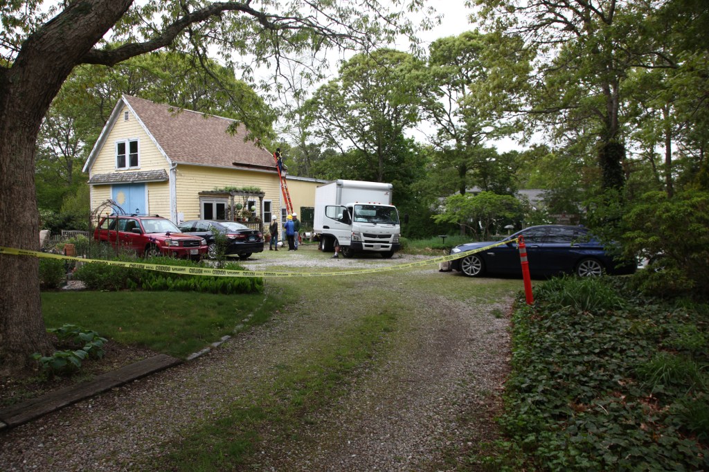

When the crew first arrived to remove the solar panels, they stretched tape around the entire work area, designating a hard-hat zone.

Two months and two days after the fire and almost four weeks from their first attempt, a second panel-removal crew finally arrived. This time they meant business. There were four guys on the removal crew plus a team of investigators from one of the companies whose equipment had been used in the array, and another couple other officials besides. I was in my office working when I heard the vehicles pull into the driveway. I came down the stairs to find yellow caution tape stretched across the door to my studio. In fact the entire perimeter of the driveway “work area” had been taped off. My quiet little property looked like a crime-scene hard-hat zone.

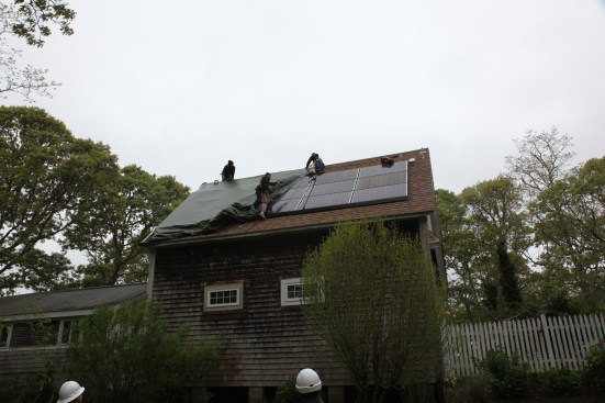

Before the crew  could remove the panels, they needed to peel back the tarp that had been protecting the area of the roof damaged by the solar-panel fire.
Roe Osborn
I knew the safety drill from my work on jobsites with cranes and telehandlers, and I knew right where to find my hard hat. I made a bee line for the workshop, and grabbed the hard hat so that I could walk around and take pictures without being chastised for not wearing the proper safety gear. Camera in hand, I got to the side yard in time to see the roof crew peeling back the green tarp.

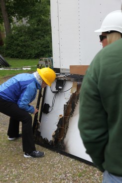

An investigator from the team examines the first solar panel (from the back), after it was taken down from the array.

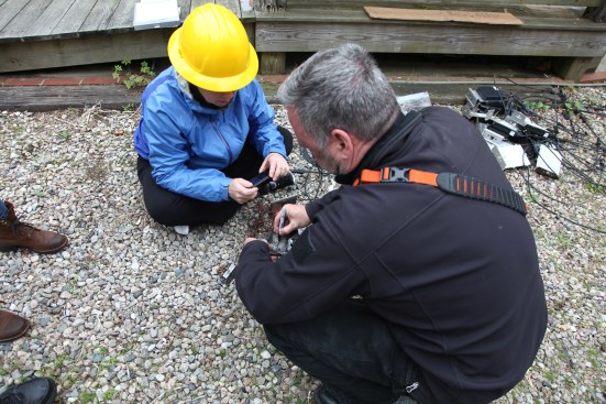

Then the investigator hunkers down on the driveway to get a close look at all the parts involved in the fire.
Roe Osborn
The first panel came down and the investigators went to work immediately. With the panel leaning against the work truck they shot pictures from every conceivable angle. As the crew removed the panels, piles of parts began to accumulate in the driveway. One of the women on the investigation crew plunked down cross-legged on the driveway stone to get a close-up view of the charred parts. Dave, the lead person on the removal crew brought pieces over her, identifying which panel each part came from. She painstakingly examined every burned part, taking numerous close-up photos in the process.

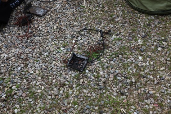

A charred part identified as an optimizer awaits scrutiny from the investigation team.
Roe Osborn

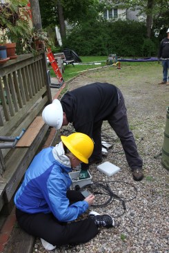

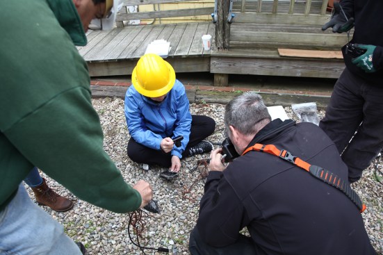

At one point they turned their attention to a badly burned piece of equipment that they identified as an optimizer. I later learned that optimizers are converters installed with each panel to maximize the output of that panel and increase the overall output of the array (someone please correct me if I got that description wrong). As she looked closely at the remains of the optimizer, she pointed to a cylindrical unit on the cable, a connector, noting that it was still intact and had not failed, which meant that most likely it had not been the cause of ignition. With all the intrigue of an NCIS television set, the crew carefully labeled each part and put the part in a zip-lock plastic bag.
The team examines all of the burned electrical parts in an effort to determine the cause of the blaze.

After examining each part, a member of the team labels the part and places it in a zip-lock bag to keep as evidence.

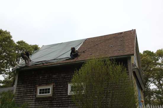

With all the panels removed, the crew re-deployed the green tarp, leaving the panel-mounting “pucks” still attached to the roof. Dave explained that removing them before the roof was reshingled would leave holes for potential leaks. He cautioned that the roofing crew should unscrew the lags holding the pucks in place and not simply yank them out to avoid damaging the framing and sheathing.
After removing all of the panels, the crew reattaches the green tarp one last time to protect the roof until the roofers could replace the damaged shingles. The mounting pucks for the panels remained in place until the roofers stripped the shingles from the damaged roof.
