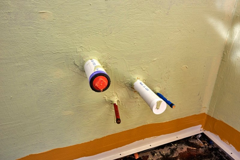

1. For circular penetrations: Circular holes for HVAC and other hose or pipe penetrations require a different approach to wrapping and flashing because of their shape. There’s a good, better, best approach for these penetrations. The good approach is to use a flexible flashing tape. When using this method, first cut a flap in the housewrap above the pipe and fold it up out of the way. Next, install flexible flashing tape in a half moon below the pipe, overlapping the housewrap. Install a second half-moon of flexible tape above the pipe, lapping the ends over the half-moon below and tape the seams. A better way is to use a flexible flashing that can stretch around the pipe for a tighter seal. But the best practice is to use a liquid-applied sealant that comes in either a tube or brush-on application that will seal out water and air in one application.

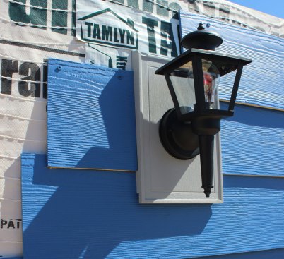

3. For all openings: Housewrap should only be slit so the opening can be flashed and the housewrap folded down over the flashing to avoid reverse shingling. For best results, flash all penetrations first, and then install specially designed mounting blocks, such as Tamlyn XtremeBlocks. These molded plastic mounting blocks come in a variety of configurations with built in flanges, flashing and slope to protect against moisture and encourage proper water runoff. While more expensive than wood blocks, the slight additional cost of XtremeBlocks easily offsets the labor required to create a water-sealed, airtight penetration and provide a finished, professional look In addition, the installation of specialty mounting block can be done after mechanicals are installed, which solves trade sequencing problems.
