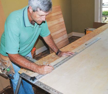

When I plan my layouts, I usually try to emulate the look of a traditionally built raised-panel door. Bottom rails are typically 10 inches wide on this type of door, top rails are usually 4-1/2 to 5-1/2 inches wide, and lock (or center) rails are typically 6-1/2 inches to 7 inches wide and centered 36 inches up from the bottom of the door. Stiles are typically 4-1/2 to 4-3-4 inches wide. I use a drywall square marked with these dimensions to record my layout on the door slab (see slideshow).
When laying out the door, it’s a good idea to check the door hardware in case there is an unusual doorknob or a huge escutcheon. It’s always a lot easier to modify the layout than to try to work around a panel design that interferes with the function of the lockset. And when I use embossed moldings, I spend a little extra time laying out the design and planning the cuts so that the pattern looks reasonably continuous around the miters.

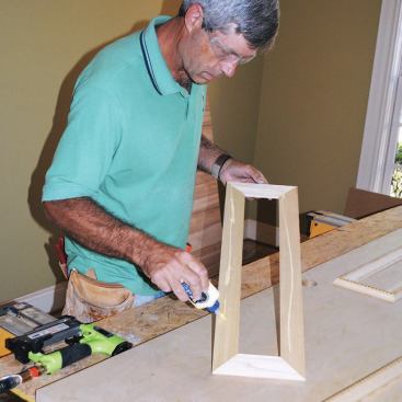

Some of the moldings I use cost more than $2 per lineal foot, so I try to cut them as carefully and systematically as possible to avoid wasting expensive trim. I set up for the right-hand miters and cut the longest pieces first, using a good-quality 80-tooth crosscut blade in the miter saw to get clean cuts. Then I switch to the left-hand cuts, using a stop block to speed production. Production cutting is good, but remember that this is finish work, not framing; you have to stay focused so that the molding is tight against the fence and accurately positioned to get perfect miters.

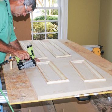

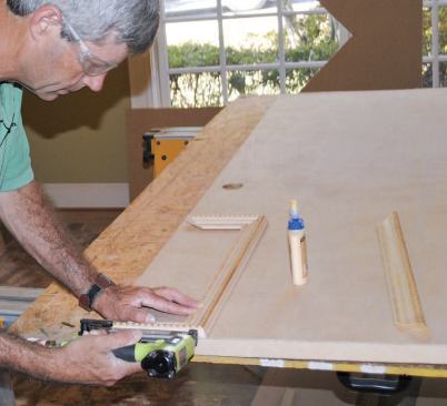

After the pieces are cut, I use glue and 1-1/8-inch-long headless 23-gauge pins to put the frames together. I also use glue when I pin the assembled frames to the door, with my layout marks serving as a guide. I’m very careful with glue squeeze-out, especially if the door is going to be stained. Instead of wiping excess glue off, I wait until it starts to harden and then use a chisel or sharp utility knife to remove it, since the residue will interfere with the way the door absorbs stain.
