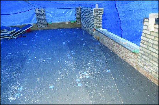

Roof installation keys. For the roofing that goes under a rooftop deck, we’ve developed a set of installation procedures (see “Low-Slope Roofing Details That Work,” Nov/19). First, we use a heat-seamed membrane—almost always TPO (thermoplastic polyolefin)—because the joints don’t require regular resealing, unlike the glued joints of EPDM. We’ve seen a lot of premature EPDM roof failures, typically at seams and joints rather than in the middle of a sheet. Whether those are due to poor workmanship or material problems, it’s not practical to remove a deck to fix the roofing, so we use roofing that doesn’t need regular maintenance.
In addition, we always install the membrane with a minimum 1/4-inch-per-foot slope. This is code, and a good idea. Even with this much slope, complicated seam buildups can sometimes pond water, which can lead to freeze-thaw damage, smelly biological growth, and warped wood decking.
One way to create the necessary pitch is to add 8- to 12-inch tapered rips to the top of the framing (on the outboard draining edge of the roof) before sheathing the roof, as shown in the detail “A Well-Drained Roof” in “Low-Slope Roofing Details That Work.”
Another way to add the needed pitch is to install sloped roof insulation above the roof sheathing, which allows for simpler flat framing. Tapered exterior insulation can also be used to fix existing framing that doesn’t have enough slope (see Tapered Insulation With Pedestal Supports, page 36). We typically use R-15 fiberglass-faced polyiso above-sheathing rigid foam, which is the code-recommended minimum in our climate zone, 4A (for other climate zones, see section R806.5 of the International Residential Code). From a building science perspective, this is a better assembly than rafter bays filled with fiberglass batts, and it’s less expensive than using lots of spray foam under the roof sheathing. Our typical goal for total roof insulation is between R-38 and R-49, depending on the jurisdiction we’re working in, but the approach we use also depends on the balance between air-permeable and air-impermeable insulation (see illustrations, below).
One wrinkle with common foam roof insulation, however, is that it is not strong enough for concentrated loads like sleepers. Our solution, which helps to distribute loads over a wider area, is to add strong high-density cover boards over the foam prior to roof membrane installation. I like the 1/2-inch-thick R-2 polyisocyanurate cover boards, such as GAF EnergyGuard HD, Carlisle SecurShield HD, and Firestone Isogard HD [since publication, Firestone Isogard has become Elevate Isogard] that are available from our roofing suppliers. Gypsum-based cover boards are also available, such as Georgia-Pacific’s DensDeck Prime, which has fiberglass facers that aren’t mold food and a coating that the roof membrane adhesive readily adheres to. To counter uplift, the cover boards are glued to the foam insulation with a manufacturer-approved polyurethane adhesive applied in a zigzag, 9-inch-on-center pattern.
Fastener location. One trick to installing the cover board—and any multilayer insulation—is to fasten only the bottom layer, then use glue for the layers above that. This common method is familiar to most roofers, and can be cheaper, as it saves a lot in fastener cost. The most important benefit is that it keeps the fastener heads away from the underside of the roof membrane. When we add sleepers or pedestals on top of a membrane, it’s best to not have a screw head right under it, because a sleeper could rub or punch down on the screw head and puncture the membrane.
Protection layer. Once the firmly supported heat-seamed membrane has been installed with the proper slope, the next step is to put down a protective layer to isolate the roof membrane from the movement of the sleepers. This movement is caused by temperature and moisture changes, as well as by people walking on the deck. There was a time we would cut strips of roofing membrane and put one under each sleeper, but now we roll out (without adhesive) EPDM over the whole area. The full coverage provides better protection during construction, plus the black color of the loose-laid EPDM membrane is less visible through the gaps between deck boards, compared with the light-colored TPO.

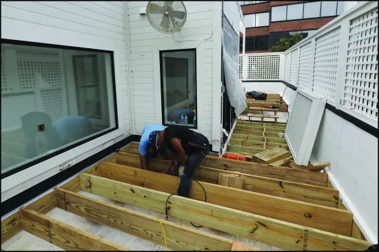

Sleepers
We typically cut sleepers from pressure-treated 2-by stock. Usually we taper these so the deck is level, rather than lay them flat following the roof slope below. Leaving at least 1 1/2 or 2 inches at the short end of the taper allows enough wood for the fasteners to grab, plus enough room underneath the decking to wash out debris later. See “Sloped Framing With Tapered Sleepers” illustration below.
When installing decks over living space, the author adheres to a code-mandated minimum 1/4-inch-per-foot roof slope, which can be achieved by either sloping the roof framing or using a tapered insulation system. While uniformly deep 2-by “floating” sleepers laid across a sloped roof may be installed…
…most clients prefer a level walking surface, so sleepers are typically tapered. Note, the tapered sleepers rest on a loose-laid EPDM “protection layer” placed over the roof’s TPO membrane.
Though not usual, sleepers may be fastened to 2-bys laid on the flat, which helps distribute loads over a wider area, particularly when a protection board is not installed between the roof membrane and insulation or when a roof insulation with a lower compressive strength is used. Here, the guardrail posts are secured to the framing below and flashed with TPO post sleeve flashing, and the EPDM protection layer is fit around the posts.
Once the decking is added, the total height is around 2 1/2 to 3 inches, which places the top of the decking roughly from 1 1/2 inches below to flush with the threshold—we typically design our decks with a minimum of 4 inches of clearance from roofing to door thresholds. When sleepers are more than 4 inches high, we block between them to keep them vertical, leaving a space underneath the blocking to allow for drainage.

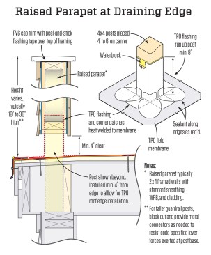

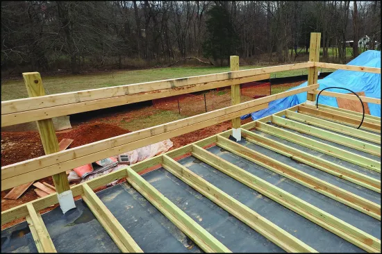

Guardrail posts. When the sleepers are tall and enough blocking has been added, they can be used to anchor railing posts. When the sleepers are not beefy enough, we’ve resorted to custom-welded steel angles. Anchoring posts to sleepers can be tricky structurally, but if our engineer can come up with a solution that meets the IRC’s 200-pound load requirement (500 pounds after applying the required 2.5 safety factor), this approach prevents leaks at posts anchored through the roofing membrane to the house framing.
But we have also found TPO post sleeve flashing to be pretty reliable, so we’re comfortable putting posts through the membrane when necessary. We definitely cover the entire post with a good WRB all the way to the top to prevent the classic “water leaked through a crack in the post” that can still happen with the best roofing job (for a post connection detail that will work with a raised parapet, see “Raised Parapet at Draining Edge Detail” in “Low-Slope Roofing Details That Work” ).

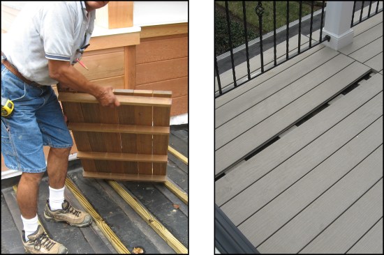

Removable deck sections. For clients to be able to clean out drains or scuppers at the low end of the roof, access to the roof membrane is crucial. But over the years, we’ve found that decking screws are challenging to remove: The coated ones rust and get stuck, while the stainless steel ones are too soft and snap or cam out.
So, instead of attaching all of the deck boards to the joists, we screw some of them to 2x2s set next to the joists, creating a removable section of decking of three or four boards. This keeps the spacing correct—with a 1/8- to 1/4-inch gap between boards for drainage—and allows the boards to be lifted easily. Don’t make the mistake of making the removable section too large; when the materials are soaking wet, they can be quite heavy. I’ve struggled wrestling with 25-square-foot panels (they must have weighed well over 100 pounds each) and would recommend keeping them smaller than 10 square feet where possible. We like to make removable sections at the high end as well so we can stick a hose in to wash debris down the slope.
Removable access panels are recommended on the deck above both the high and low ends of the roof (left, right), to provide access to the roofing membrane for maintenance.

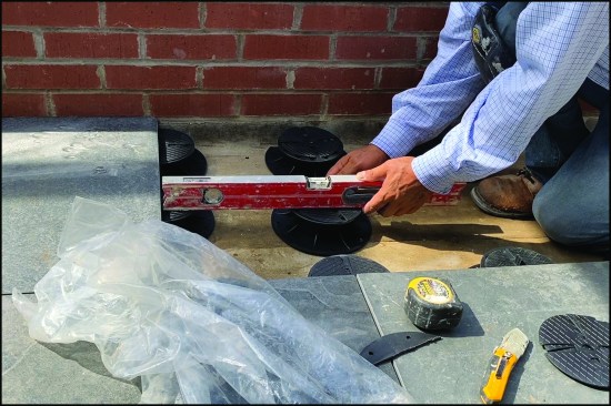

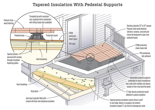

For clients who want a stone or tile deck over finished spaces, pedestal systems are a great alternative to traditional stone and tile assemblies. Mortared assemblies are expensive, requiring multiple layers of specialty materials and constant on-site vigilance during installation. They also build up to nearly 3 inches thick, which may not fit in a remodel situation—unlike with pedestal or sleeper systems, water can’t drain through the walking surface of a mortared assembly and significant clearance has to be left under doors. Setting materials in mortar essentially guarantees efflorescence, which must be managed, and freeze-thaw damage is always a possibility with tile or stone set in mortar. Most clients don’t like the tilted surface, which must be sloped 1/4 inch per foot for drainage. And, should a leak occur, it’s a daunting task just to access it, usually involving a tile subcontractor, diamond saws, rotary hammers, temporary rain protection, and a mess.
Adjustable pedestal supports, which—like sleepers—can be set level, are available from a number of suppliers such as Bison Innovative Products. They basically consist of two cylinders that thread into each other so their height can be adjusted. These suppliers also offer pedestal-compatible decking materials, typically in 24-inch-by-24-inch sections, including wood (in parquet-style pallets), ceramic tile, concrete, and natural stone pavers designed to span over the pedestal bases. See “Tapered Insulation With Pedestal Supports” illustration below.
The pedestals install right over a normal low-slope roof (we use the same methods as for sleepers, with supportive cover boards under a heat-seamed membrane and a protection layer). If we ever need to fix a leak, we can just lift up the decking pieces and pedestals and get to work. Although the joints between the tile, stone, and concrete decking pieces aren’t grouted, the installed walking surface looks like what most clients expect with a mortar-set assembly. Pedestal systems are much easier and less expensive than mortar-set materials, and much easier to live with later.
Pedestal supports are well-suited for roof systems with multiple slopes, including tapered roof-deck insulation sloping towards scuppers for drainage.
When we order pedestals, we work with a supplier and send it a drawing showing the slope(s) of the roof; the supplier works out the layout details and sends us sets of different types of pedestals, as they have a limited adjustment range and come in shorter and taller versions. We lay them out correctly per the plan, fine-tune the height, and drop the walking surface on top. Some pedestal systems need to be shimmed to account for the slope of the roof, but we’ve also used pedestals with base levelers or threaded top sections that can be tilted slightly in lieu of shimming.

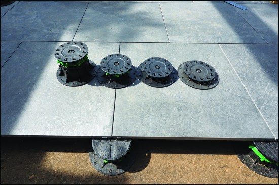

Most pedestals are adjustable and are supplied by their manufacturers in varying heights depending on the roof configuration.
The sets we’ve used also include little shims that can be used to level any pieces that are different thicknesses, since the corners of four different pieces land on the pedestals. When the surface is wood, we usually install it ourselves (we have terrific carpenters), but recently we had a mason install a tile deck; their wet saw was the right tool to cut the 24-inch tiles at the deck perimeter, and they have a patient and careful guy who set the pedestals just right.

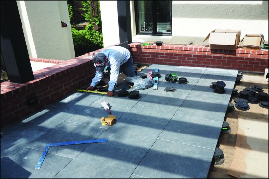

Installation is a simple matter of following the manufacturer’s layout and adjusting the pedestals so that they are level with each other. Here, the 24-inch-by-24-inch-by-3/4-inch-thick ceramic tile pavers are installed (the tile pavers are designed to span over the pedestal bases and typically weigh approximately 50 pounds each).

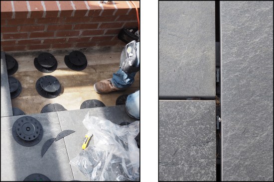

Some pedestal systems need to be shimmed to account for the slope of the roof. Here, manufacturer-supplied plastic shims (full-diameter-width and partial ones) are installed on top of the pedestals (left) and set with construction adhesive. Pedestals with base levelers or threaded top sections that can be tilted slightly in lieu of shimming are also available. Open joints allow for deck draining (right).

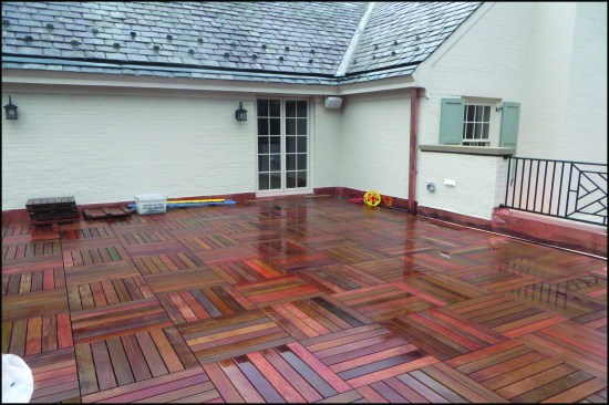

A newly-installed parquet-style wood “tile” deck installed over adjustable pedestal supports.

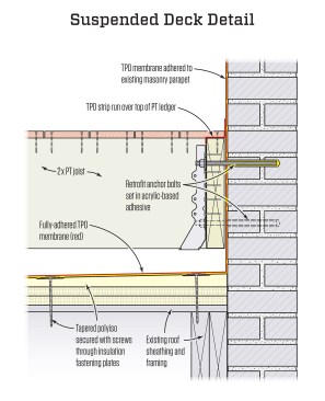

When adding a rooftop deck to a masonry townhouse, we can often simply bolt ledgers into the masonry parapet walls and span joists all the way across, rather than install sleepers or pedestals. This is a simple solution, but it will work only on certain buildings. This makes for a clean install with little complication to the waterproofing and roofing. In fact, we often leave existing roofing in place when it’s relatively new and doesn’t seem to have any existing problems.
Where the roof deck is enclosed by a masonry parapet, ledgers can simply be bolted to the house framing and parapet to support standard deck joists.
Depending on the wall construction, our engineers have provided us with bolted ledger connection details using various types of fasteners, lately specifying anchored bolts with acrylic-based adhesives for several types of wall. Apparently, epoxy adhesives lose a lot of strength when the temperature is high, so acrylic-based adhesives are preferred for rooftop applications that are exposed to the hot sun.
We’ve had success using Simpson Strong Tie’s AT-XP and OptiMesh acrylic injection and screen tube system to anchor ledgers. When purchasing an acrylic-based adhesive system, I look for the following: high-temperature performance and low-temperature application; approved use for block, masonry, “cracked concrete”-type conditions (we do a lot of rehab work with existing masonry walls and many anchors are rated for “good” concrete but not for conditions we typically see); and single 10-ounce tubes that fit in normal caulk guns, rather than systems that require special dispenser tools with multiple plungers.
To reduce the chances of water flowing behind the bolted ledgers and penetrating the bolt holes, we flash the tops of the ledgers, typically with a TPO strip sealed to the wall and running over the ledger (see “Suspended Deck Detail,” below). Even though our fastener holes are not large, it seems prudent to try to keep the area behind the ledger dry.
Ledger flashing is needed to keep water from penetrating the bolted ledger connections, which are typically specified by an engineer.
