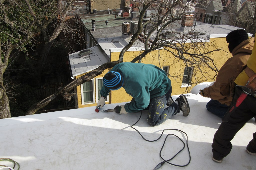

By “low slope” roofing, we mean any roof that is pitched at less than 4 inches of rise in 12 inches of run, or 4/12 pitch. Regular asphalt shingles and standard skylights will work at pitches of 4/12 or greater, but at lower pitches, you have to use different materials. That includes soldered metal roofing or synthetic membranes. So in this story, I’m going to focus on details for membrane roofing, and in particular, TPO (thermoplastic polyolefin) membranes.

When we encounter trouble on any membrane roof, the problems are always related to joints, edges, and penetrations. Let’s take a look at the details that work in those situations.
Membrane roofing materials are flexible, tough, and durable. Short of a tree branch dropping through them, they can stand up to conditions on a roof. Trouble can occur, however, at joints, seams, penetrations, and intersections. The illustration below shows areas where careful attention is important.
