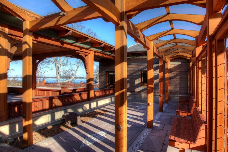

On a Craftsman-style home on Cape Cod, arched, red-cedar cross beams support a glass covering for this arbor.
Our crew was recently asked to build an arbor for a Craftsman-style house we were building on Cape Cod. The arbor created a covered connection between a greenhouse and a garage in a T-layout. The framework for the arbor was pretty simple: Horizontal 4×10 (actual) red-cedar beams notched into pressure-treated posts to form the “T.” (The posts later received a cedar veneer.) On top of the beams, we built 16 cross beams, also made from 4-inch-wide red cedar. Each cross beam had a gently sloped top surface and an arch below. Horizontal “wings” extended from the ends of each beam to overhang the support beams by about 18 inches at each end. Angled notches at the ends of the wings completed the detail.

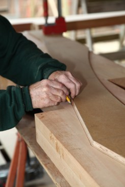

We’d made two MDO templates—one for each size of cross beam—working directly from the dimensions on the architect’s blueprints. The templates served two purposes: First we used them to lay out for the rough cutting, and then later they became router-bit guides for our initial finished cut.
To lay out for the rough cut, we centered the template on the blank with the bottom edge of the template lined up with the bottom edge of the blank and clamped them together. We indexed the template to the blank so that we could reposition it after the rough cut. To mark out for the rough cut, we placed a small, 1/4-inch-thick block of wood against the template and drew a pencil line outside the block. When we’d marked the edges of the beam that needed to be cut, we removed the template and set it aside.

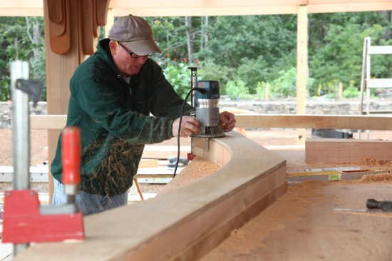

With the rough-cutting done, we re-clamped the template to the beam and worktable, taking care to position the template on the beam exactly where it had been before. For the first router pass, we mounted a top-bearing flush-trim bit in a fixed-base router. With the router-bit bearing riding against the template, we cut back the edges of the beam, moving the clamps as necessary to complete the pass. Whenever you’re routing in this manner, it’s always important to push the router against the rotation of the bit so that it cuts into the work without tearing out.
A router with a top-bearing flush-trim bit follows the template for the first finish cut.
The 3/4-inch-diameter bit was removing only about 1/4 inch of material, so it wasn’t over-taxed and stayed sharp for a longer period of time. As soon as we noticed the bit cutting more slowly than normal, we stopped and changed it, usually after cutting three or four beams. The result was a glass-smooth surface that would be easy to sand. But more importantly, we needed that smooth surface to guide our second pass with the router.

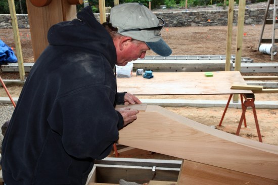

We removed the template and flipped the beam over before making the second pass with the router. This time, we used an industrial-grade up-cutting spiral bit with a double bearing on the bottom of the bit. With the bearings following the surface from the first pass, the bit cut perfectly flush with that surface. The up-cutting action of the bit minimized the chances of tear-out, and again we carefully monitored the sharpness of the bit, changing it before it could start burning the wood. When the routing was finished, each beam received a thorough sanding.

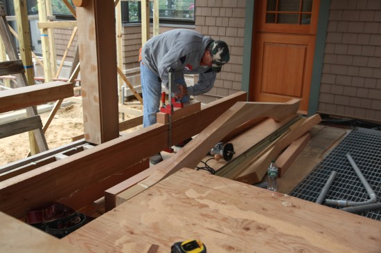

To locate the holes for the through-bolts, we set each beam in place, centered it, and scribed the bolt positions onto the beam. To drill the holes, we started with a Forstner bit that made a large, flat-bottom hole for the nut and washer on the top side of the beam, and a clearance hole on the bottom of the beam for the nut already threaded onto the bolt. We connected the top and bottom holes with a spade bit slightly larger than the bolt diameter to give us a little wiggle room for positioning the beams. After slipping the beam into place, it was just a matter of measuring the overhangs for an exact placement before tightening the nuts.

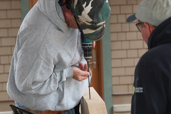

A crew member carefully drills  slightly over-size holes for the screws. A Forstner bit creates pockets for the screw head on the top side of the beam.

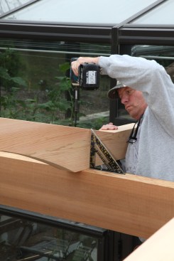

We used a different approach for the structural screws that attached the other beams. On the bottom edges of each beam, we measured in the distance from the beginning of the arch to the horizontal beam (about 2 inches), and then set a small template in place that located the screw positions.
We drilled guide holes at every screw position, then drilled a hole through from the bottom of the beam to the top while keeping the bit as square to the beam as possible. As with the through-bolts, the bit we used was slightly larger than the thread diameter of the structural screws. After drilling all the way through, we flipped the beam over and chased the holes with a 1-inch Forstner bit, for a flat-bottomed hole for the screw heads to bear on.

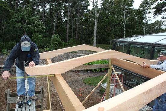

Crew members center each cross beam on the horizontal beams.
After setting the beams in place, we again centered them side to side over the horizontal beams. Because the screws fell on the sides, not in the center, of the cross beams, we took special care to keep the beams vertically square to the beams below as we torqued the screws with impact drivers.
Then they drive the structural attachment screws while keeping the beams square to the top surface of the carrying beams below.
To complete the installation, we cut wooden plugs and glued them into the holes above each fastener. After cutting the plugs flush, the beams were ready to support the glass covering that would provide protection for people walking below.
