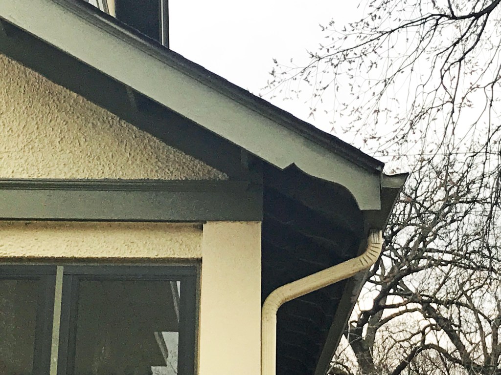

Even with a drip edge, rainwater can flow down the bottom of a rake board. This decorative detail is a nice way to force water to fall before it runs down and soaks the end grain.

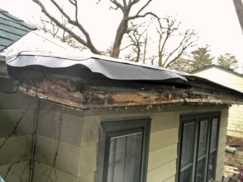

Omitting roof drip edge can result in severe deterioration
Whenever I work on the exterior of a home—even if I’m not repairing damage caused by a roof leak—I first survey the condition of the roof. My goal is not to guess how many years the shingles have left but to get a sense for the slope and overhangs. How efficiently does the roof get rid of water? Is there a correctly installed drip edge that directs water away from the eaves, or is water leaking in behind gutters and fascias? Are roof-wall intersections properly executed with step flashing and kickouts? Much has been written in JLC about the importance of roof flashings. Two must-reads are Mike Guertin’s “Drip-Edge and the IRC” (May/18) and “Kickout Flashing: Required by Code, Yet Often Overlooked” (Oct/19). Just installing the drip edge and kickout flashings correctly will avoid a high percentage of the most common roof leaks.

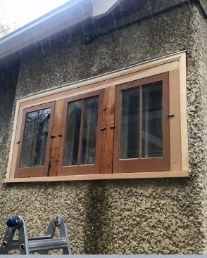

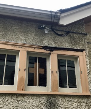

Water highway. The rot on this window head occurred because an ice-melt wire, which ran down a valley and was plugged in under the eaves, created a “water highway” that soaked the wood. Surface tension caused the water to cling to the wire and travel along it until it drained off the dip just over the window.
After rebuilding the window, the author advised the owner to move this outlet (and replace it with an exterior-rated GFCI unit). In this photo, the outlet has not been moved but the wire is gone for the time being.

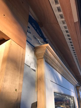

Horizontal surfaces must be sloped to allow any water to run off. The top edges of deck ledgers, skirtboards, transition rails, sills, thresholds, headers, porch and deck railings, and post caps are all elements that need to be beveled at least 10 degrees. The steeper the bevel, the faster it will shed water.
Fail. A wood head cap can serve as an effective way to shed water, but in this instance, it is a fail—the premilled drip kerf should have been installed face down, not up.

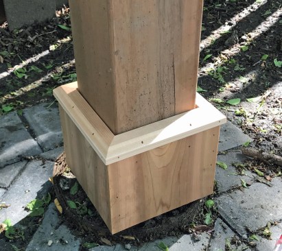

To build a durable base for an exterior column, the author creates a ventilation space, oversizing the base about 1/4 inch on all sides.
This space can be capped, leaving a smaller space of about 3/16 inch between the trim and the column.
With a column base, provide space between the two wood layers. I build each side of a column base about 1/4 inch larger than the sides of the column. A few shims provide a nailing surface with minimal exposure to capillary action. Then I close the gap at the top of the base with a drip cap. I have to resist my impulses as a finish carpenter to make the cap fit tight to the column, though. Wood butting wood presents a minute gap that can wick and hold water, so instead of butting the cap to the face of the column, I leave a gap of about 3/16 inch to allow any water to drain through.
Another example of a capillary break is a 3/8-inch gap between the siding and a window head or skirtboard. Wherever there is a chance for water to pool rather than drain off quickly, increase this gap to an inch or two. Examples include the gap between siding and the flashing surface at roof-wall intersections and the gap between siding and the top of the flashing on a deck ledger. In these two cases, it is often the sheer volume of water in these locations that increases the chance that the water will be deeper than 3/8 inch. Similarly, open the gap to an inch or two any place wood runs to grade (though where there is the possibility of roof runoff splashing back, this space needs to be at least 8 inches).
Allow for drying. The gap around the column base points to a third important strategy to avoid water damage: The gap not only breaks the surface tension of water and prevents capillarity, but it also allows air to circulate between the column and the base to allow drying.

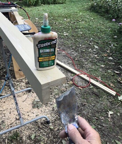

As stated earlier, end grain wicks water more readily than the face and edges of boards, so focus on the ends. I make it a habit to keep a bottle of Titebond 3 (Ultimate) wood glue near my cut station and smear cut ends with this. It serves to seal the end even if I’m not depending on the glue joint, per se. Of course, often I am purposefully creating a glue joint. In that case, I smear the entire surface with glue, and I clamp the connection to ensure a truer bond.
When using preservative treated wood, I use an end-cut sealer matched to the type of treated wood I’m using—something like Wolman CopperCoat for green wood or Nisus Bora-Care for borate-treated woods.

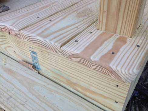

For this simple set of exterior steps, the budget was tight, but the author was still able to incorporate several principles to prolong its life. A gap between each step and riser allows water to drain and the wood to dry freely. In addition, the deck boards are installed with the growth rings curving down (bark-side up). The author believes this is the best way to ensure that pressure-treated deck boards that cup will drain water rather than hold it (see discussion of why below).

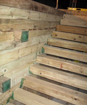

Bark-side up or bark-side down? As carpenters, we should also pay attention to the grain. I think on porch and deck boards, it’s best to install the growth rings so they curve down (bark-side up). I feel this is the best way to ensure that the boards will shed water when they cup, rather than hold water. Whether boards should be installed bark-side up or barkside down, however, is the subject of avid debate. Here’s my thinking on this topic:
In theory, the original moisture content of a piece of lumber is the best predictor of a board’s final shape. Wet, or air-dried, lumber will tend to cup toward the bark side as it dries. In essence, the growth rings will want to flatten out, causing the board to cup towards the bark side. This argues for installing boards bark-side down. But it’s not always so simple as that. Kiln-dried lumber behaves quite differently; it is usually surfaced after the lumber has been dried and will tend to cup away from the bark side as it gains moisture. When using a kiln-dried after treatment (KDAT) decking product it makes more sense to install boards bark-side up.
In practice, no matter which face is up, the final shape of a board will depend on its in-use moisture content. If one side is wetter than the other, that side will expand and cause the board to cup. With a deck built close to the ground, it’s usually the underside of the board that swells, as the underside experiences higher relative humidity than the upper surface, which is exposed to wind and sun and boards usually cup upward. With any deck that is close to the ground, it’s critical to provide as much air circulation under the deck as possible.
But there are still other issues that need to be taken into account with deck boards that argue for installing them bark-side up: For starters, heartwood is difficult to impregnate with wood-preserving chemicals, while sapwood is easy to treat. As a result, the most resistant face of pressure-treated (PT) wood – the face that is 100% treated – is the bark side. This argues for placing the bark side up when using PT deck boards.
In addition, repeated cycles of wetting and drying can cause the layers of earlywood to separate from the layers of latewood. This separation, called shelling, occurs infrequently but when you see it, it is usually on deteriorated PT deck boards that are laid bark side down. Placing deck boards bark-side up reduces the chances for shelling on the exposed face of the board. For more on these issues, see the Forest Products Laboratory factsheet: “The Bark-Side/Pith-Side Debate” (PDF).

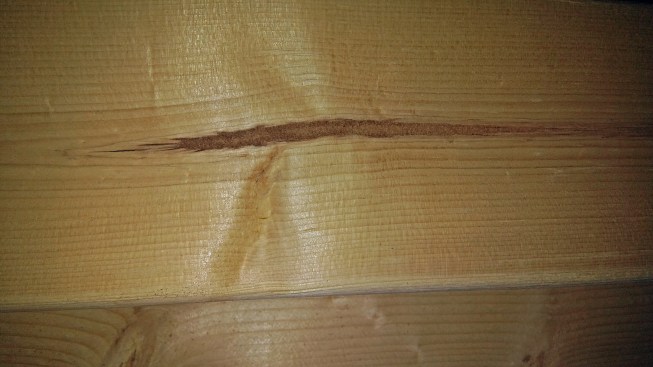

When selecting boards at a lumberyard, avoid selecting boards with pith, like the one shown here. Studies suggest that lumber without pith is stiffer and less likely to deform in service conditions.
Avoid diagonal grain and pith. I always tell carpenters to avoid boards with grain that runs diagonally across the face and to avoid boards with pith—grain that shows full-circle growth rings on the end or the dark center of a limb on the face of the board. Both types of boards will tend to bow and twist more over time, even if they are fairly straight when you buy them.
The very best, of course, are boards with growth rings as close to 90 degrees from the face of the board as possible. Wood will move, and the straighter the grain, the more evenly and predictable that movement will be, limiting how much a wooden assembly will work itself apart with changes in temperature and humidity.
