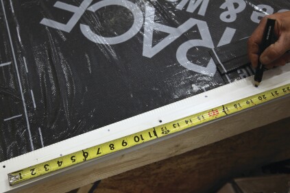

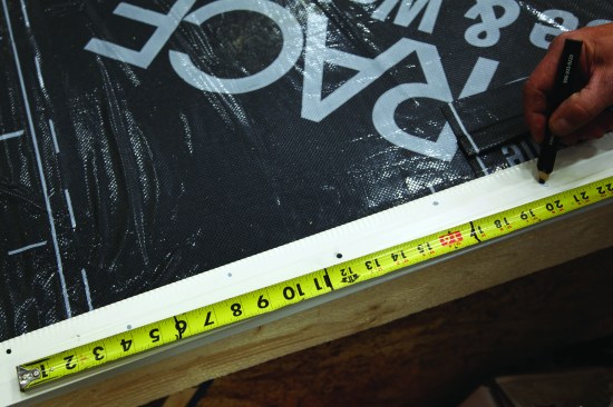

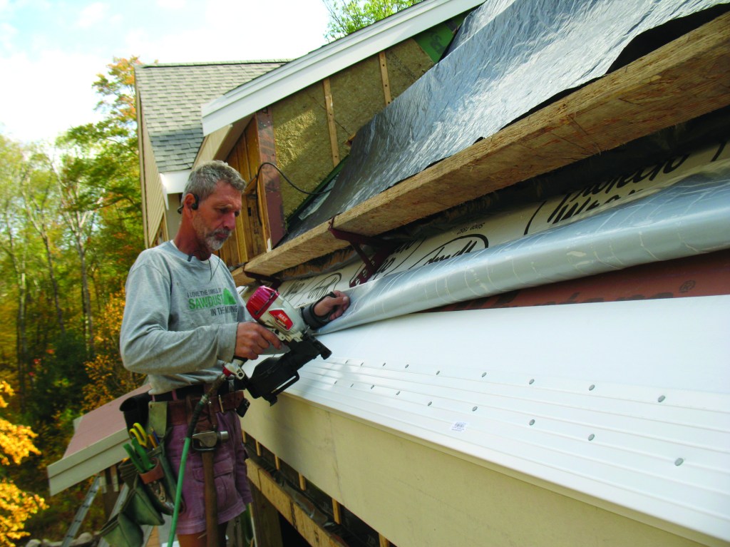

Section R905.2.8.5, Drip Edge, in the IRC spells out what the IRC requires: “A drip edge shall be provided at eaves and rake edges of shingle roofs. Adjacent segments of drip edge shall be overlapped not less than 2 inches. Drip edges shall extend not less than 1/4 inch below the roof sheathing and extend up back onto the roof deck not less than 2 inches. Drip edges shall be mechanically fastened to the roof deck at not more than 12 inches on center with fasteners (1, 2) as specified in Section R905.2.5 [roofing nails with minimum 12-gauge shank and 3/8-inch-diameter head]. Underlayment shall be installed over the drip edge along the eaves and under the drip edge along the rakes.”
Code requires that the drip edge extend at least 2 inches onto the roof from the fascia board. This drip edge extends much farther. Nailing along the eaves should be spaced at no more than 12 inches on-center.
In both of these examples, the installer arranges the fasteners in a W pattern to put the drip-edge attachment closer to the edge of the roof.

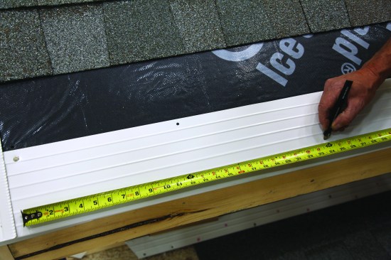

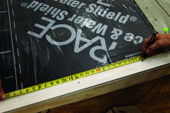

For regions prone to high winds, the Fortified Home program recommends that the nails for the eaves drip edge be no more than 4 inches apart, instead of the code-required 12-inch spacing for drip-edge nails.
The recommendation for rake drip edge is the same (4). Nails should be driven in a two-row W pattern. The Fortified Home guidelines also call for the shingles along the eaves and rakes to be bedded in an 8-inch band of roofing cement.

The Fortified Home guides go beyond the basic code requirements by recommending that drip-edge sections overlap at least 3 inches, and that the drip edges be fastened with roofing nails at 4 inches on-center in a two-row W pattern (3, 4). Ideally, there should be a 2-by subfascia or solid blocking between rafter or truss tails for sheathing attachment; the bottom row of drip-edge nails can be driven into that blocking.

Drip-edge profiles are available in a variety of designs and sizes. You’ll often see them designated as a “Type” or “Style” followed by a letter: A, C, D, F, L, T. These designations can get a bit confusing because manufacturers use different designations for similar-looking drip edges. When you boil it down, there are two basic drip-edge profiles suitable for asphalt shingles. One is a simple “L” shape with a 90-degree bend between the roof leg and fascia/rake leg (NRCA calls this Type L, but others refer to it as Type C). The other profile has an extended edge that projects past the fascia or rake boards by about 1/2 inch before bending into the vertical leg (the NRCA calls this Type T, while others refer to it as Style D or extended drip edge). Either style of drip edge is suitable for eaves or rake use.
I generally choose the extended-style drip edge along eaves edges, so water rolling off the edge of the shingles will tend to drip away from the fascia and into a gutter. And to keep things simple, I use the same drip edge along rake edges. Some roofers prefer to use the extended drip edge along eaves edges and the L-shaped drip edge along the rakes.
It’s important to get the proper size roof and fascia/rake legs when selecting the drip edge for your project. Wider roof legs provide more surface area for nailing. I usually select drip edges with at least a 4-inch roof leg along the eaves edge and a 2-inch leg along rakes. The code calls for the fascia/rake leg to extend 1/4 inch below the roof sheathing and the Fortified Home guides call for 1/2 inch. But I like to use drip edge with at least a 1-inch fascia/rake leg.
