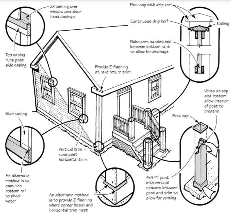

Exterior joints should be designed to shed water (see illustration). Trapped water will cause excessive wood movement, splitting, and — ultimately — rot, bugs, and fungal infestations.
Run verticals past horizontals. Where a vertical down board or casing stile meets a horizontal skirt board or rail, I either run the vertical past the horizontal, or bevel the top edge of the horizontal board. I also arrange vertical trim pieces so that there’s no exposed end grain, which is the part of the board that’s most likely to absorb moisture. That’s why I cap the same stile at its top edge by another rail.
Avoid miter joints in exterior trim work. When a miter joint inevitably opens as the wood shrinks, the end grain of both boards will be exposed to the weather. Dadoed tenons and lap joints can be made to work outdoors, if they’re made according to the same principles. I also use metal flashing wherever possible to help water find a path away from horizontal trim pieces.
Slope top surfaces. Railings, thresholds, and other flat surfaces can be made to shed water by bowing or sloping their top surfaces. In addition, saw or rout a drip groove along the underside edges. An example is the built-up post in the illustration above. I’ve cut the top cap in sloped facets and routed a drip groove on the underside. Drain and ventilation holes at the top and bottom of the post keep condensation from accumulating inside.
