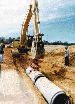

The Pipe Man (short for “pipe manipulator”) robotic pipe-laying device could prevent dozens of deaths a year by avoiding the need for sewer and utility workers to work in trenches.
Trench collapses account for the majority of excavation deaths in recent government statistics. Although OSHA safety requirements for sloping or shoring trench sides are effective ­ the agency says deaths declined by 60% after rules were tightened in 1989 — the precautions are still widely omitted. In the case of the Newark accident that killed Gary Dillon, the rules might not have applied in any case: The 4-foot-deep trench that buried Dillon did not reach the safety rule’s 5-foot threshold.
But even a shallow trench can kill. One reason trench risks are taken lightly in the field may be that people underestimate soil’s deadly nature. As Small Flows Quarterly pointed out last year, “A cubic yard of trench soil weighs 2,700 pounds, about the same as a mid-sized automobile. A person buried under only a couple of feet of soil would experience enough pressure on the chest to prevent the lungs from expanding. Suffocation would occur within about three minutes.” The force of falling earth can also crush organs and break bones, and the crushing of large and small blood vessels and cells releases toxins into the body. Victims who don’t suffocate often die of internal bleeding or shock.
The Fall 2003 Small Flows article introduced a new technology that could sharply reduce trench risks, if adopted. The robotic “Pipe Man” device developed by Leonhard Bernold and colleagues at the North Carolina State University’s Construction Automation and Robotics Laboratory (www2.ncsu.edu/ncsu/CIL/CARL) eliminates the need for workers to hand-lay pipe in the trench. In tests, Bernold says, the device was faster and cheaper than traditional methods. But he says commercialization is held up by a lack of funding for final refinements.
