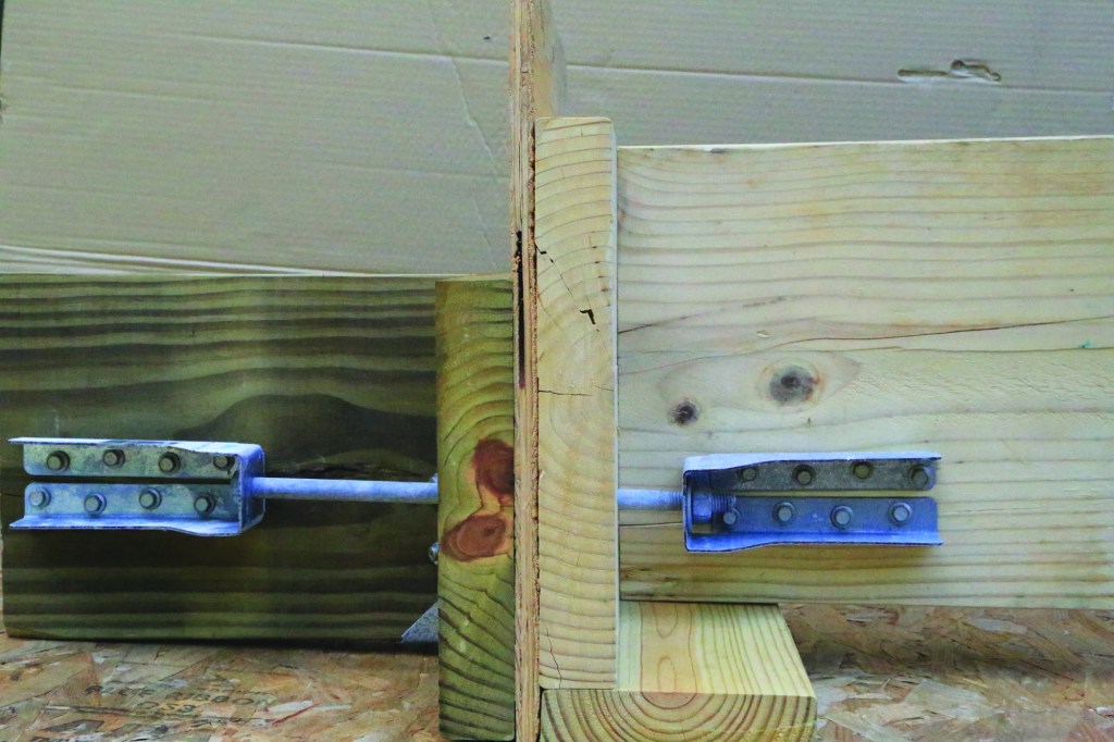

When deck and house joists are parallel, screw a metal tie to the side of a house joist and another to a deck joist with structural screws.
By code, all decks must be designed and built to resist lateral loads, the forces that tend to pull a deck away from a house. Since 2009, the IRC has included a couple of prescriptive details that allow deck builders to meet that requirement. In part 3 of his 3-part series on proper deck ledger installation, Mike Guertin discusses the fasteners and metal hardware needed to follow the IRC’s prescriptive details and win the approval of your building inspector.
