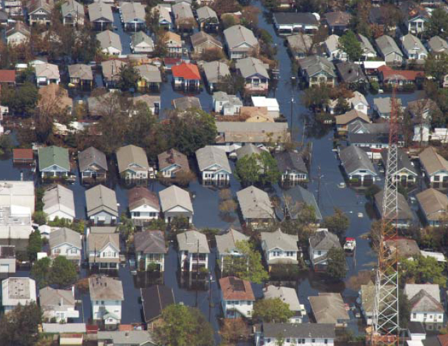

Tropical storms and hurricanes damage coastal housing in multiple ways. As building scientist Joe Lstiburek observed in a November 2005 ASHRAE Journal article, “We learn our lessons from disaster. Hurricane Andrew (1992) taught us about wind. Hurricanes Charley, Frances, and Jeanne (2004) taught us about rain. The Red River of the North Basin taught us about floods. Hurricane Katrina had it all: wind, rain, and flood.”
But insurance companies consider the Katrina disaster to be primarily a flood event (although the storm reached Category 5 intensity at sea, winds in most affected land areas were no higher than a Category 2 storm, and wind damage was relatively light). And as Joe Lstiburek points out, Katrina’s flooding was to some extent predictable, and some of its effects could have been avoided.
Even as floodwaters rose in New Orleans in late summer 2005, Lstiburek predicted in an interview, “The buildings in the older part of New Orleans that were built elevated, using water-tolerant materials like masonry and cement plaster, and with no cavity insulation, will be relatively less damaged and will be able to be cleaned up and put back into service. But houses that are flooded that were built more recently using wood frames, gypsum wallboard, and fiber cavity insulation are going to be much worse damaged, and many of them will never be usable again.”
Almost a year after Katrina, Lstiburek’s predictions are borne out by experience. Many older buildings in New Orleans (especially in higher terrain) have been put back into service, while most of the newer structures in lower-lying areas are candidates for demolition. And if the lessons of Katrina could have been known in advance of the storm, says Lstiburek, they should certainly be learned now.

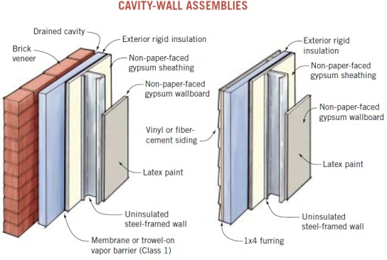

Shown here are two options for drainable and dryable cavity-wall assemblies suggested by building scientist Joseph Lstiburek. The wall designs share several key characteristics: (1) No water-sensitive materials are used; (2) exterior cavities are vented to the exterior; (3) interior cavities can be opened to allow passive air-drying in the event of a flood by removing strips of wall material at top and bottom to encourage convective airflow.

Like the cavitywall assemblies suggested by Lstiburek, these mass-wall assemblies are designed to dry by vapor diffusion toward both the interior and the exterior: The most moisture-impervious material (closed-cell rigid insulation board) has been located at the center of the wall profile.

Lstiburek also offers a masonry mass-wall detail. Rigid insulation is installed on all masonry walls, walls are framed without cavity insulation, and the water-tolerant gypsum board is applied in the same fashion as for the steel- or wood-frame assemblies, to allow air-drying after a flood event.
