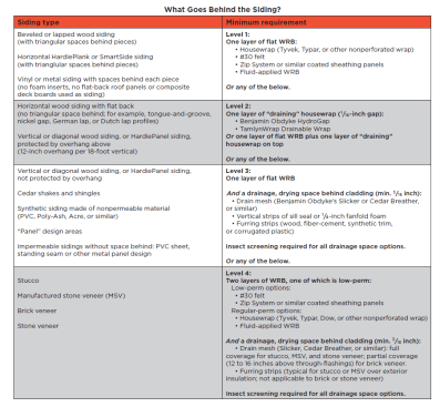

The author’s company defines four “levels” of protection in its guide for crews installing different types of siding.

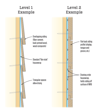

Level 1
In the chart’s first category are permeable siding materials with spaces behind each course and lots of joints and openings. Lap siding made of wood, fiber-cement, or wood-fiber composites all fit this category, as does standard vinyl or metal siding (with hollow-back profiles, not filled with foam). Based on our experience disassembling many houses built with these materials, we know they perform adequately in our climate even when installed over flat WRBs (those with no special draining provisions), so that’s our minimum requirement.
Two notes on this: Other provisions in our company’s standards require wood siding to be fully back-primed; this is important when plastic wraps—which will lose water repellency when raw wood tannins soak into them—are installed. Also, we note that highly insulated walls need more drying capacity than the “Level 1” requirement provides. We’ll often have a conversation with clients about paint durability, as well. Our experience (including on my own house) is that adding a drying space behind wood siding provides a tremendous boost in paint longevity. For a client planning to stay in their house for a long period, this upgrade is often worthwhile.

Lapped or beveled siding (above, at left) has triangular spaces behind it and requires only Level 1 protection. Flat siding profiles, such as shiplap (above, at right), require Level 2 protection.

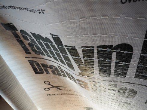

Another option is Tamlyn's Drainable Wrap. Drainage wraps hold the siding about 1/16 inch off the WRB surface.

Level 2
The second level for siding protection uses a “draining” housewrap to provide a small drain cavity (a couple examples of these “bumpy” wraps are shown in the photos above). These products typically have a 1/16‑inch gap for water and air to move through, offering much more drainage than a flat WRB, but they still retain some water due to water’s surface tension. Though a 1/16‑inch gap isn’t wide enough to offer much drying capacity, it’s more than a flat wrap provides.
We use draining WRB materials for permeable sidings like wood and fiber cement, which have a flat back surface; the bumpy wraps keep water from seeping through the WRB, which can happen when water is trapped against it (for more about this, see “Water Managed Wall Systems,” by Joe Lstiburek, Mar/03).

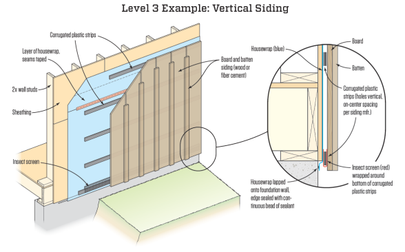

Vertical (as well as diagonal) sidings have proven to be leaky on the author’s past projects, so he specifies “Level 3” protection. Here, the drainage space is created by corrugated plastic battens, one choice among several his company specifies.
Level 3

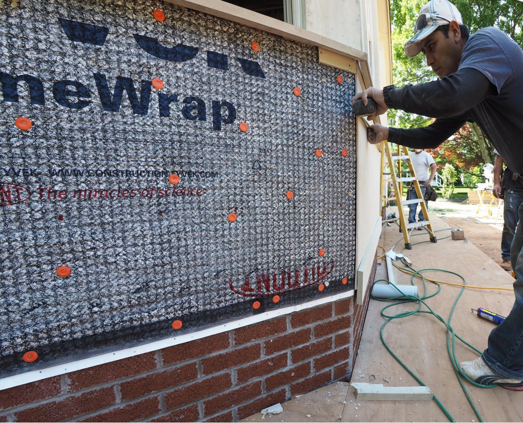

The third level replaces the 1/16-inch bumps on “draining” housewrap with a wider, 3/16- to 1/4-inch drain space. To create this space behind siding, we almost always use drain-mesh products since they’re commonly used around here. They have the advantage of allowing horizontal, along with vertical, drying and air movement. (For more, see “Increasing the Effectiveness of Drainage Spaces.”) We sometimes use other materials, as well, including strips of 1/4-inch fanfold insulation, corrugated plastic, or sill seal foam.
We call out this level for several risky claddings, including solid, plastic-based sidings like cellular PVC, “poly-ash,” and the new rice-hull-PVC product. These materials don’t allow any moisture through at all, so we have to make a clear path for it to dry out from behind.
We also call out this enhanced protection for “panel” designs (see illustration, below). In addition to the panels having a flat back and limited drying through their materials, they tend to leak at joints near the rails, which trap water. Cedar shingles with their multiple layers, which also tend to hold water, benefit from this level of protection, as well.
Click to enlarge
Large panels have fewer joints and fewer ways to dry out. Fiber cement is more permeable than PVC-type panels, but the author still specifies Level 3 protection. Here, the drainage space is provided by a drainage matrix, such as Cedar Breather.

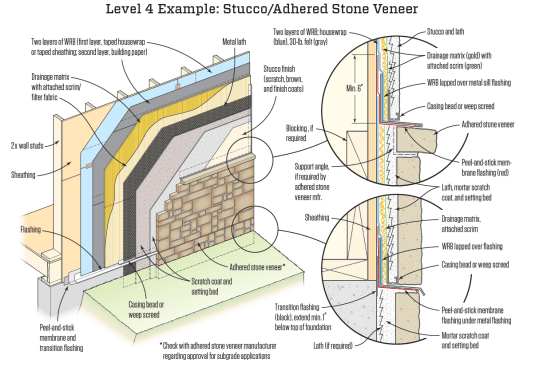

Level 4
The fourth level of protection adds a second layer of WRB material for redundancy and code compliance. Claddings in this category—including stucco, adhered stone and manufactured stone, brick veneer, and stone veneer—hold rainwater, and when the sun hits the cladding, that moisture is driven into the wall. In our climate, one of the WRB layers should have low permeability; for instance, felt or one of the coated OSB sheathing materials, such as Zip System.
Click to enlarge
Stucco and manufactured stone are examples of claddings that can absorb and hold water. These materials require Level 4 protection provided by a two-layer WRB (required by code) as well as a drainage and drying space.
