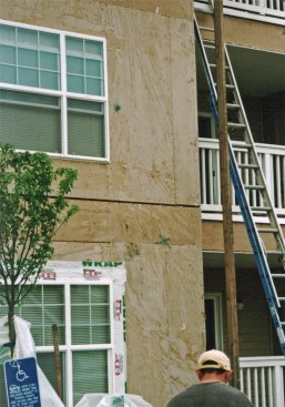

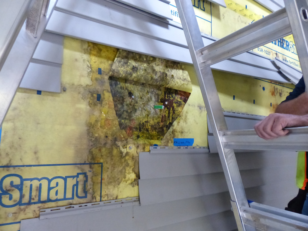

The walls of an Oregon housing project. Note the green pen knife, which easily penetrated the deteriorated OSB. The fact that this was a multifamily project plays a distinct role in why indoor moisture has so severely damaged these walls.

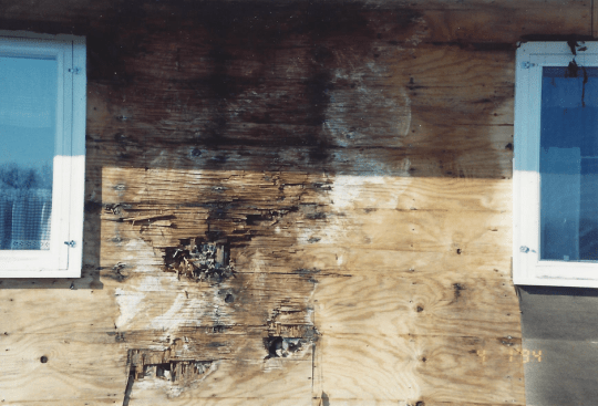

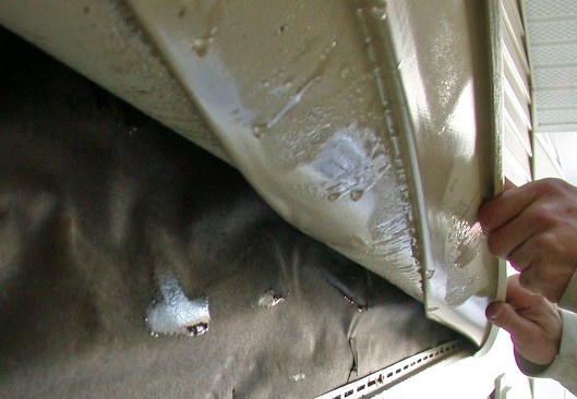

The effects of trapped water vapor. The walls on single-family homes in northern Wisconsin had been covered with a weather-resistive barrier (WRB) that acted as a vapor barrier.
Moisture-laden indoor air migrated toward the outdoors by air leakage and vapor drive and condensed on the back of the sheathing, leading to extensive rot.
I saw an example of what can happen when single-family walls are installed with a vapor barrier on the outside of the wall cavity when I had the opportunity to remove all the hardboard siding from 15 single-family homes in Wisconsin (climate zones 6 and 7) that mistakenly had a low-permeability (0.6 perms measured) exterior water-resistive barrier (WRB) installed. This WRB had trapped moisture coming from indoors in the plywood sheathing. Inspections prior to mine had found widespread sheathing damage in hundreds of these homes. Fourteen of the 15 homes I inspected had plywood decay, with 12 severe enough that the plywood could easily be torn apart by hand. We determined that the extensive and widespread damage (see examples in photos above) was caused by vapor diffusion and air leakage from indoors rather than from rain leakage from the outside of the wall cavities. None of the outside surfaces of the siding exhibited any signs of water damage.
While this example involved an impermeable WRB, it demonstrates the condensation potential from trapped moisture in single-family homes in very cold climates. As we shall see, it’s plausible that similar damage can be expected with impermeable siding materials, even vinyl siding (contrary to widely held beliefs), in cold winter climates.

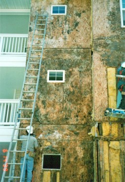

Here’s an example of what can happen in multifamily housing with impermeable siding that acts as an exterior vapor barrier. I was present at site inspections in which we opened up walls at seven, mostly large multifamily housing complexes in Oregon and Washington. These housing complexes in a relatively mild marine climate zone each included numerous buildings, and dozens to hundreds of apartments, with vinyl siding. None of the exterior walls had a rainscreen or exterior insulation (a condition I call “contact-applied” siding).

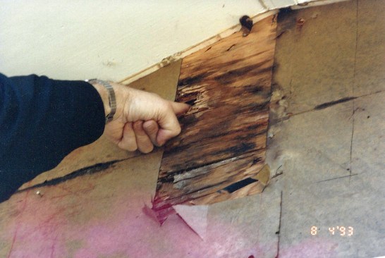

Inspections of multifamily housing in Oregon revealed water staining on gypsum sheathing beneath contact-applied vinyl siding.
Inspections of multifamily housing in Oregon revealed water staining on gypsum sheathing (above) beneath contact-applied vinyl siding. Removing the gypsum revealed extensive damage to the OSB sheathing beneath (right).
With fewer walls facing the exterior in multifamily units, moisture loads driven by air leakage through those exterior walls tend to be higher than in single-family homes, where an equivalent moisture load may be driven through walls on all sides.
Most people believe that walls clad with contact-applied vinyl siding work well because the siding is applied “loose” and reportedly “drains well.” However, in every one of those seven cases, most of the buildings had some damage to wall components behind the vinyl siding, and there was no evidence of excessive rainwater intrusion or construction defects that would have led to rainwater intrusion. Rather, the damage, which included WRB deterioration, mold, and serious decay of the plywood and OSB sheathings and wall framing, was found to be directly related to water-vapor transport into the wall cavities from indoors. Oftentimes, the back face of the vinyl siding was dripping wet (see photo, below).
Observations at the wall-opening inspections revealed that OSB decay was surprisingly widespread, but it occurred sporadically. Not all wall areas were affected. It occurred mostly on north-facing walls and seldom on warmer, south-facing walls; often at intersections of interior walls; and in some cases, between floors where air leakage typically was highest. The sheathing was routinely wettest on the inside faces, indicating moisture was coming from indoors. In addition, the sheathing and WRB damage (including decay, mold growth, and WRB deterioration) and elevated moisture contents, as well as elevated indoor air relative humidity and dew points, correlated in most cases to bedroom walls. Notably, there was very little indoor mold observed, although the wall damage did not appear to be related to lack of sufficient indoor ventilation. The photos above and below are typical of the sheathing decay and housewrap deterioration we found at the wall-opening inspections.

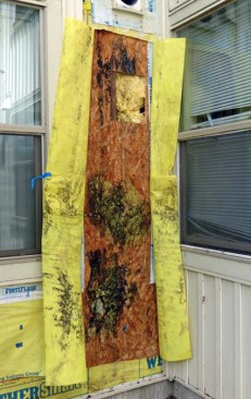

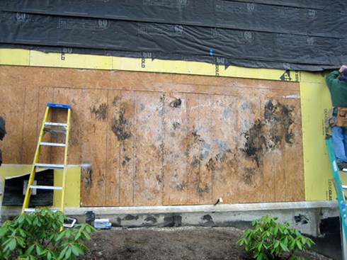

On a multifamily housing complex in Washington state, removal of contact-applied vinyl siding, paper, and gypsum sheathing revealed moldy, decayed OSB.

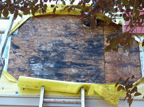

On a different housing complex in Oregon, moisture driven from the interior caused sporadic deterioration of the WRB and decay of OSB sheathing.
