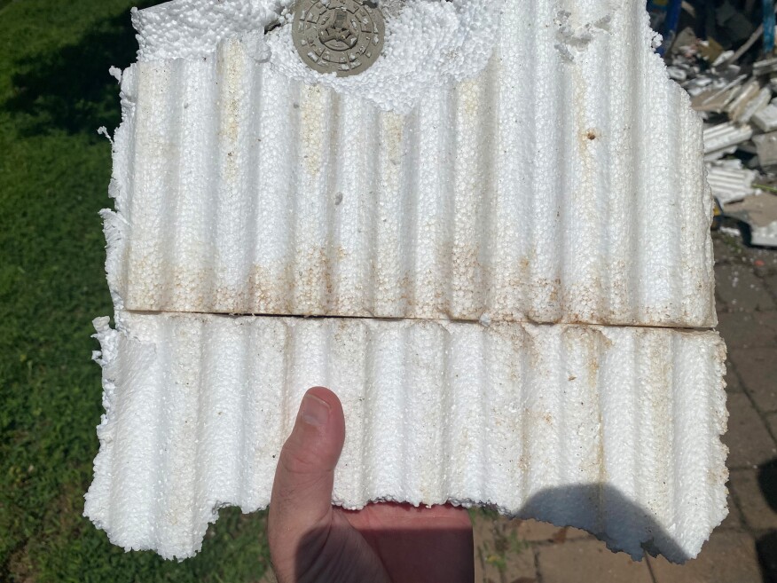

Vertical grooves. Several of the systems use foam base sheets with vertical channels cut into the foam facing the wood wall. Water can drop down in the channels and drain out the bottom of the system.
Someone should have explained that to the crew that installed the foam board on a house we stripped and re-stuccoed when the EIFS failed in several areas. They ran the channels up and down on the main parts of the walls, but for unknown reasons, they ran the channels horizontally at the rim-joist level all the way around the house, totally blocking the drainage at every level.
“Drainable” (or “drainage”) EIFS has vertical drain channels behind the foam insulation board. The channels can be molded into the back of the foam …

Drainage channels (arrows) were installed horizontally at the band-joist area on this house, blocking the vertical channels above. (We had already replaced the sheathing visible here, since the trapped water had rotted out the original OSB.)
