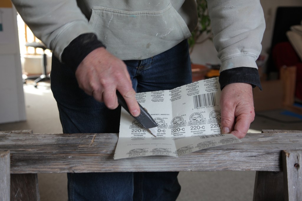

Cut one of the four folds from the center out to the edge. It does not make a difference which fold you cut.

OK, it’s probably a clear indication of my OCD tendencies, but there is a better (and wicked easy) way to fold sandpaper and use it more efficiently. I learned this trick very early in my career as a carpenter—probably the same time I was running baseboard in that closet—and I have used it ever since. Here’s how it goes:

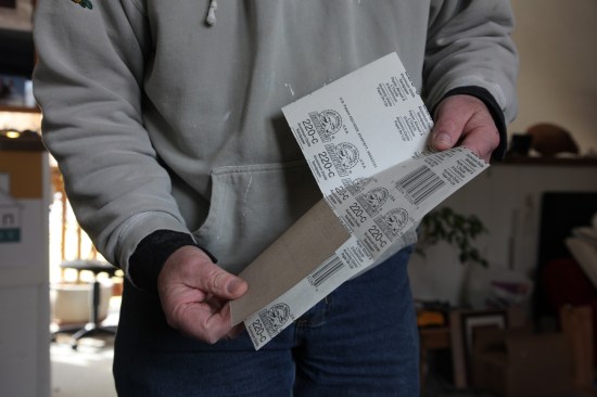

Fold the sheet in half lengthwise.

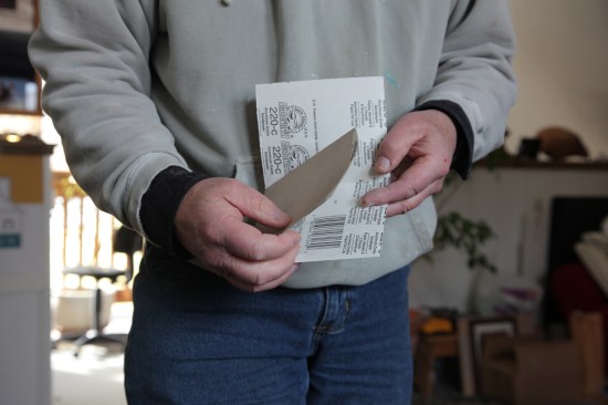

Now fold the sheet in half going the other direction.

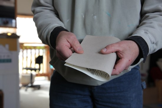

Start folding the sheet, working your way around the center.

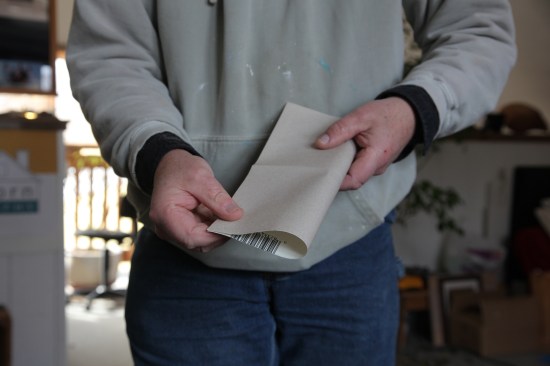

Keep folding...
Keep folding…
Unlike just folding up a sheet and using it, this method separates the abrasive surfaces. In other words, the sandpaper isn’t rubbing on itself and wearing itself out as you sand. Use one side, flip it over and use the other side. Then just turn the stack inside out to expose the other two fresh surfaces.
As I sand, I also like the feel of a thicker “pad,” having four thicknesses stacked up. The quarter sheet is also more comfortable in my hand and easier to control than a full sheet. And the thicker edge is good for sanding in tight areas where I would need to fold the paper anyway.
